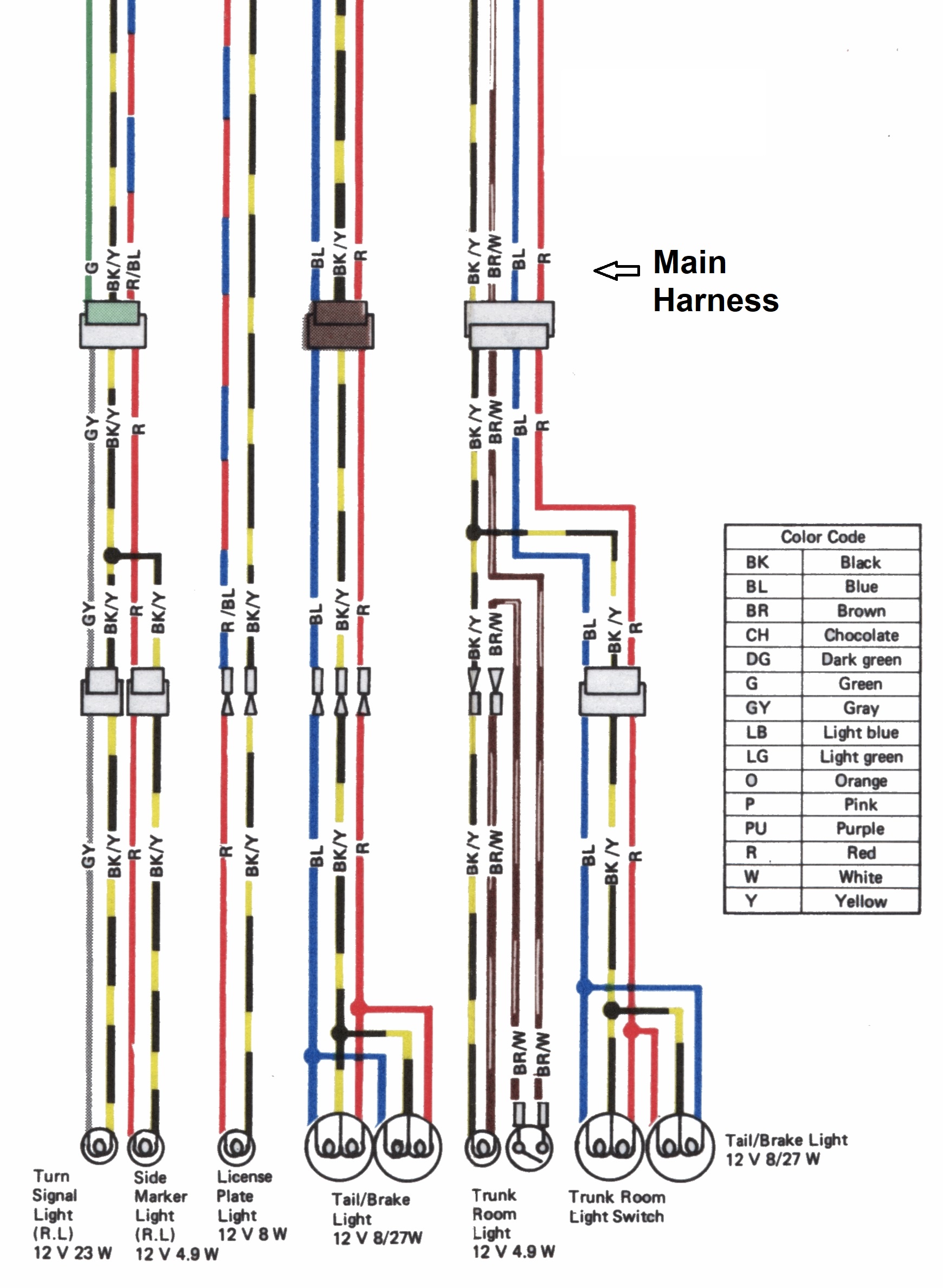

My 93 voyager was a mess in the back wiring. I cant tell what wires go where. I wish i could see a rear harness thats nit molested.which wires work signals brake and ttail light.my manual looks like a manual looks like a maze. The writing is too small to read. I need a larger color coded one
