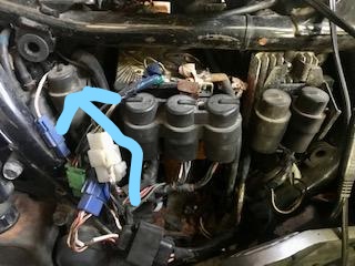

That's mostly right. There are actually about 9 or 10 identical relays . The pump relay is the one tucked up under the left side cover in front of the battery (high and to your left)
Just because the horn doesn't work doesn't mean the relays bad . hit the button and listen for a click.
Any of the relays will do though
voyager relay_LI.jpg (853.86 KiB) Viewed 7942 times
fuel pump relay
