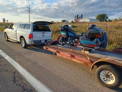

When i had the thing apart to change the carb o-rings, i thought, hey, might as well replace the fuel lines, filter, and pump, right? That way it's all new!!
Well, 906 miles later, luckily only about 40 miles from home, suddenly dead, no fuel. After about a 2hr wait for my son to ride back home to fetch the truck and trailer, got it home and confirmed the NEW pump had failed.
Last night put the old pump back in, and it's running again :)
Needless to say i do not recommend the all balls brand fuel pump, they should maybe stick to bearings. Dennis kirk did give me a refund with no hassle though!

Yep, the next one will be from kawasaki. Aggravating part is there was nothing wrong with the old one, just figured while i had it apart I'd replace it. Oh well the old one is back in and working fine, Saturday looks like good weather so we'll try again!
