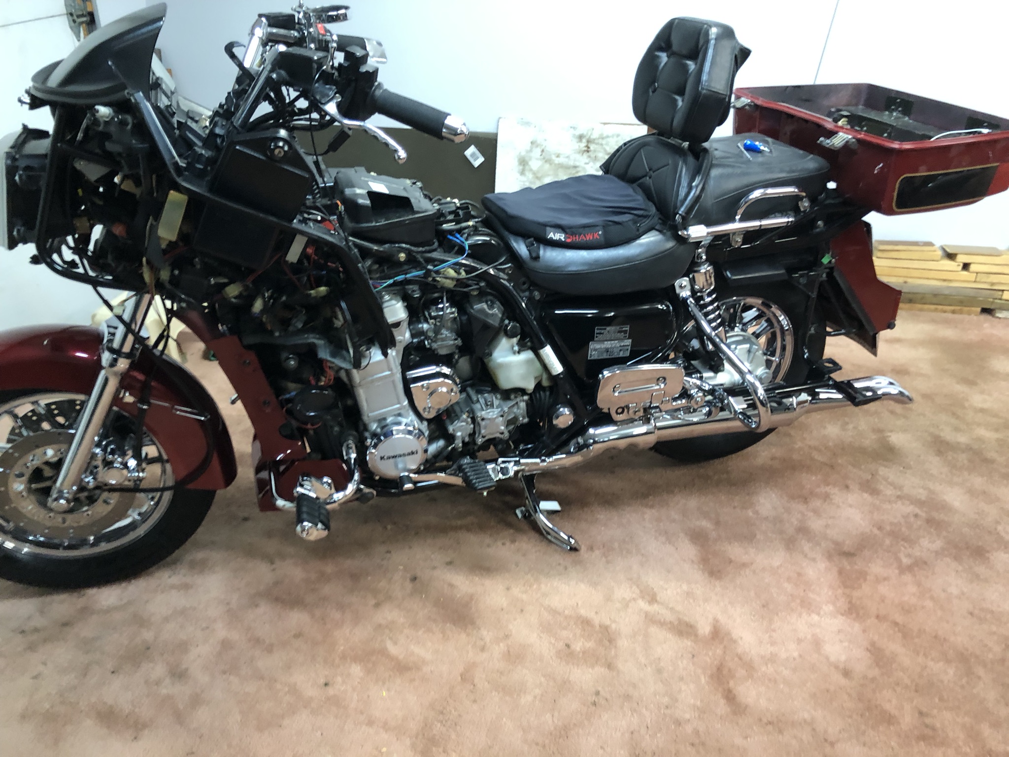

I was wondering what everyone does to keep there bike clean. As I've been rebuilding my xii, it seems like this poor thing was rode and just put away. There are alot of tight spots that are hard to get at but it seems like every now and again you would want to strip it down pretty far and give it a good scrubbing. What do you do to keep your bike clean?

Been doing it for around 20 years. Very easy . I believe I followed instructions in the manual the first time. Mirrors off first, then windshield chrome plastic piece, headlight cover , windshield, lower fairings then upper fairings. I clean and polish each individual piece as I remove them.
