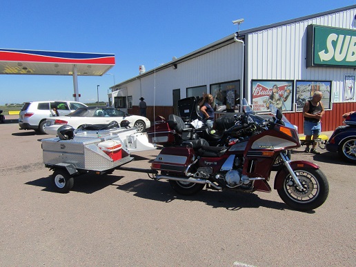

I pulled this trailer from Michigan to Sturgis, up over Beartooth Pass, thru Yellowstone, to Jackson, WY. and home with no issues what so ever. Tongue weight of 35 to 40 lbs. adding much less weight on bike than piling all my camping gear and such on bike or rear rack. Left saddle bags unloaded( rain gear and camera). The Voyager XII has more than enough power to pull this which basically what the bike is doing, not adding to tires and suspension.. Keeping in mind it is back there allow more braking distance. Small effect on fuel milage but not real bad. This was in 2016, still have trailer and pull with Goldwing now, Have towed it more than 70k miles with still no issues.Bonnie and Clyde wrote: ↑Thu May 04, 2023 9:53 am ..... Any thoughts on tongue weight or towing a trailer in general? I have concerns about the tongue weight effecting suspension and tire life. A car tire might solve that?.....
