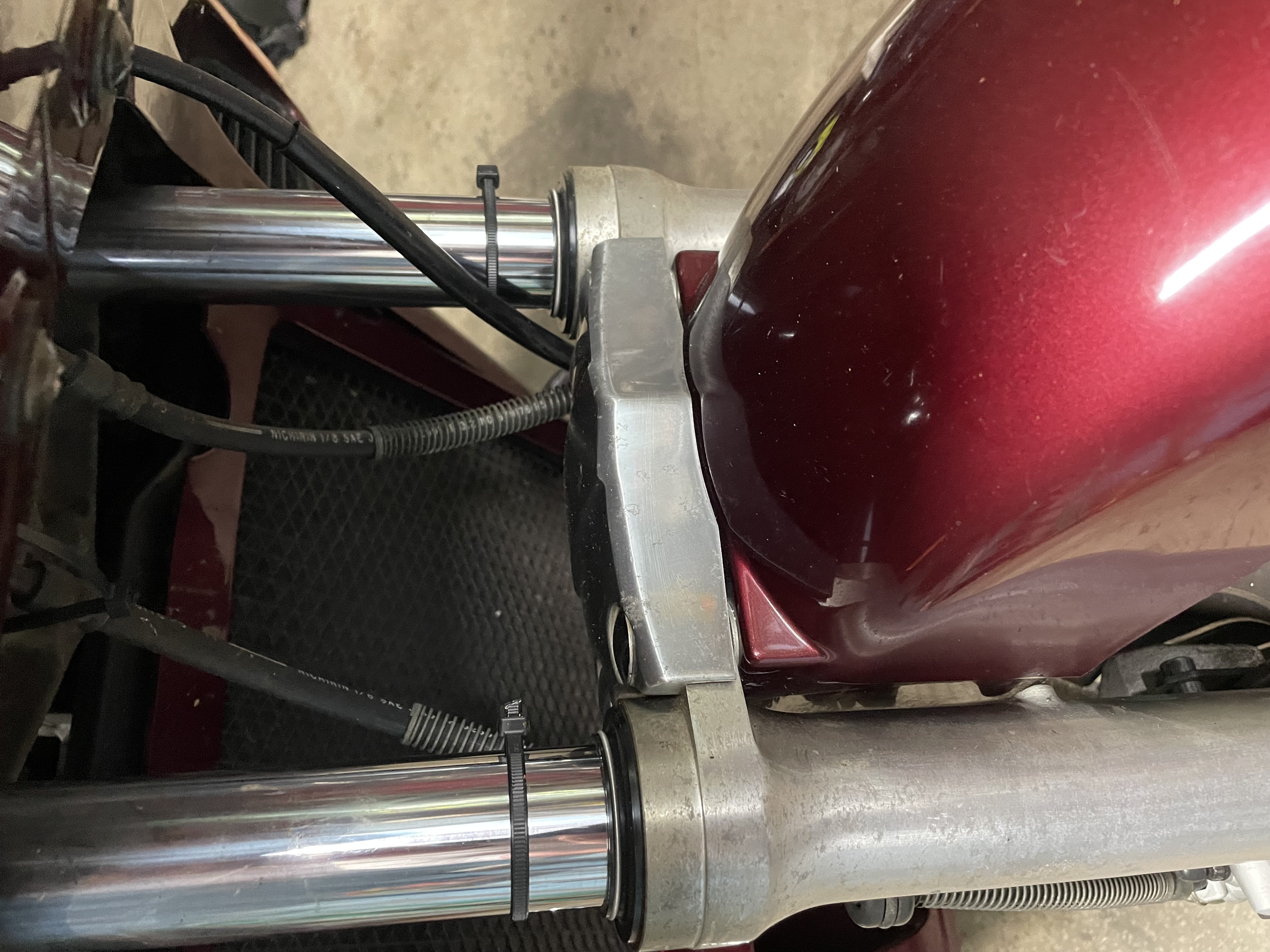

I’ve had the front wheel off when I pulled the forks to replaced the seals when I first got the bike. Kicking myself in the butt for not putting in progressives when I did. But I digress.

Nah, if the front springs aren't clapped out there's no reason to replace them. I only replaced mine because the original ones weren't as firm as a slinky anymore. They were definitely worn out. How's the bike riding? If it's comfortable and working well, then no need to fix what ain't broke.glvnthedream wrote: ↑Fri Jul 21, 2023 11:01 pm I’ve had the front wheel off when I pulled the forks to replaced the seals when I first got the bike. Kicking myself in the butt for not putting in progressives when I did. But I digress.

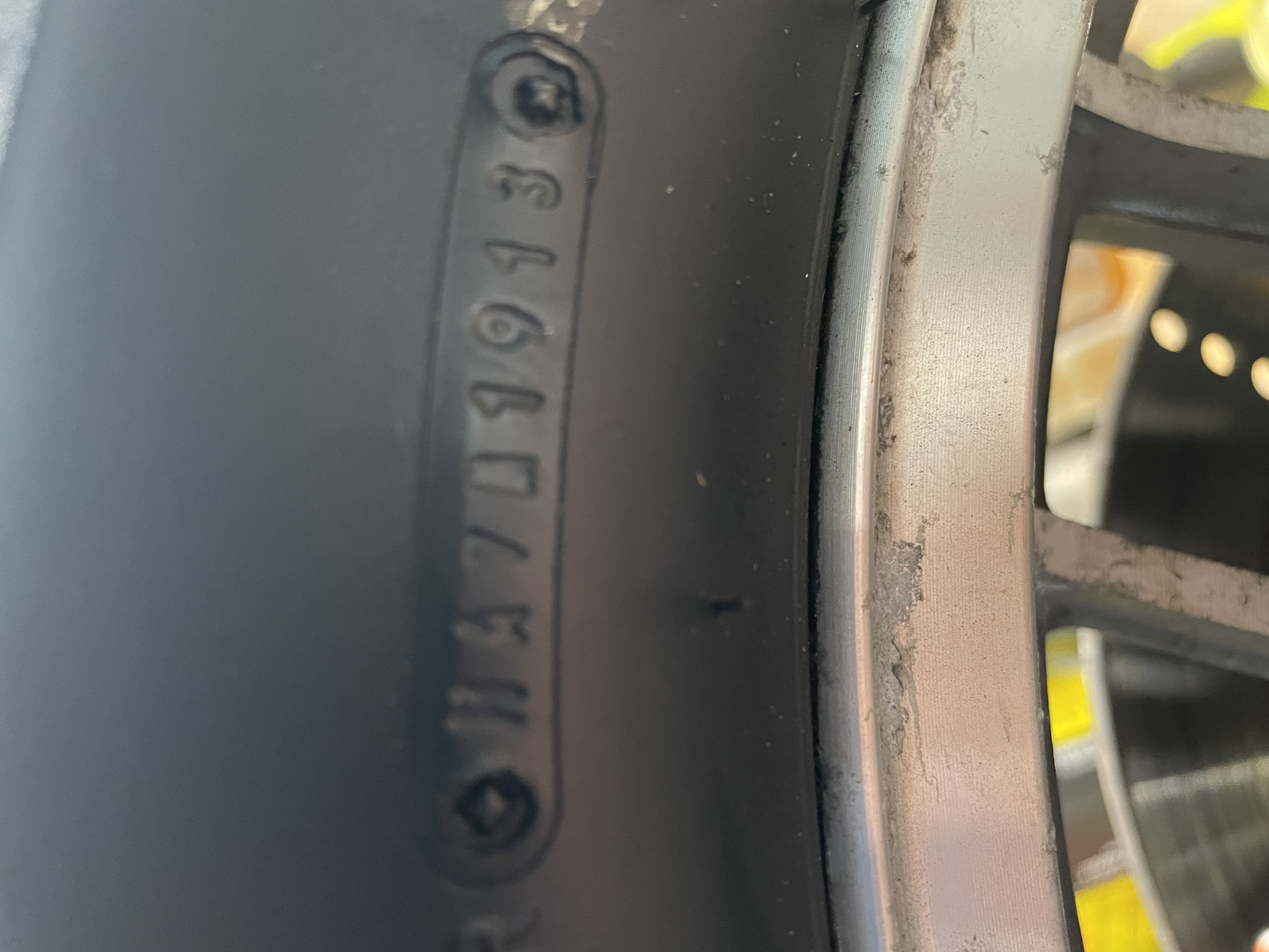

Is the picture below the date code? 19th week of 2013?? It’s on the Dunlop 404 I pulled off the front.

No, the date code is a four-digit number in an oval. First two digits are the week, last two are the year.glvnthedream wrote: ↑Wed Jul 26, 2023 3:57 pm Is the picture below the date code? 19th week of 2013?? It’s on the Dunlop 404 I pulled off the front.

That’s the only thing on the tire that comes close to a week and year.

GrandpaDenny wrote: ↑Wed Jul 26, 2023 7:57 pmNo, the date code is a four-digit number in an oval. First two digits are the week, last two are the year.glvnthedream wrote: ↑Wed Jul 26, 2023 3:57 pm Is the picture below the date code? 19th week of 2013?? It’s on the Dunlop 404 I pulled off the front.
- Posts: 1138
- Has liked: 511 times
Re: NEW TIRES (take to shop or do it yourself)
This is what you're looking for. 0918 indicates 9th week of 2018..

Nothing like your picture on my tire.

Your tire probably predates date codes. This advice will probably set some people's hair on fire, but if it looks good, not cracked or any other signs of unusual wear, I'd keep using it - it'll wear out on its own soon enough.
