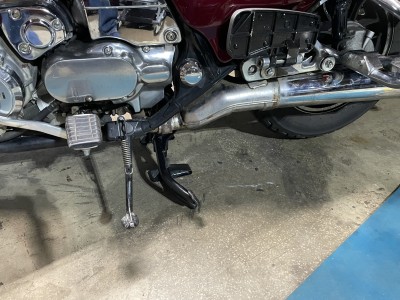

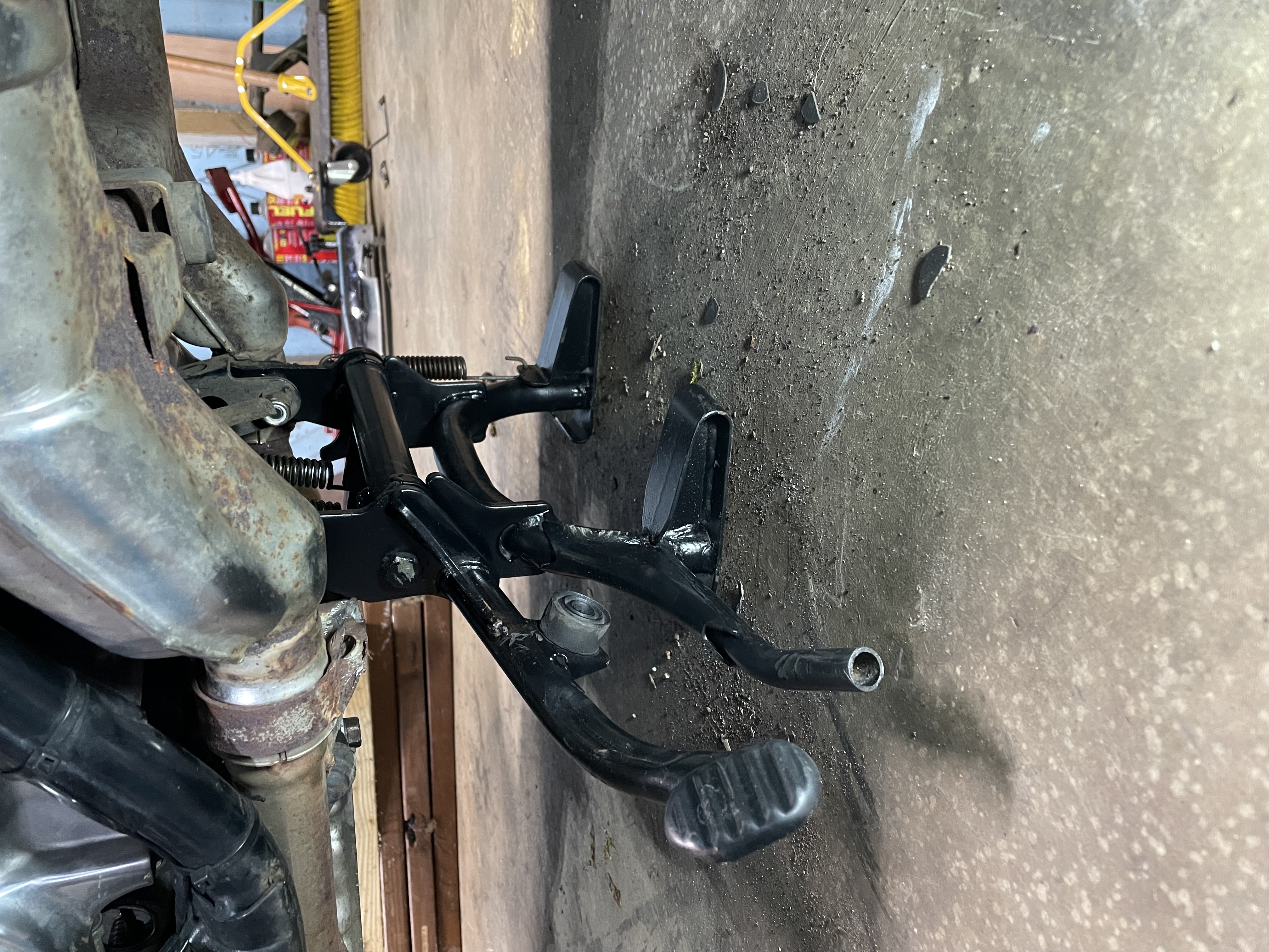

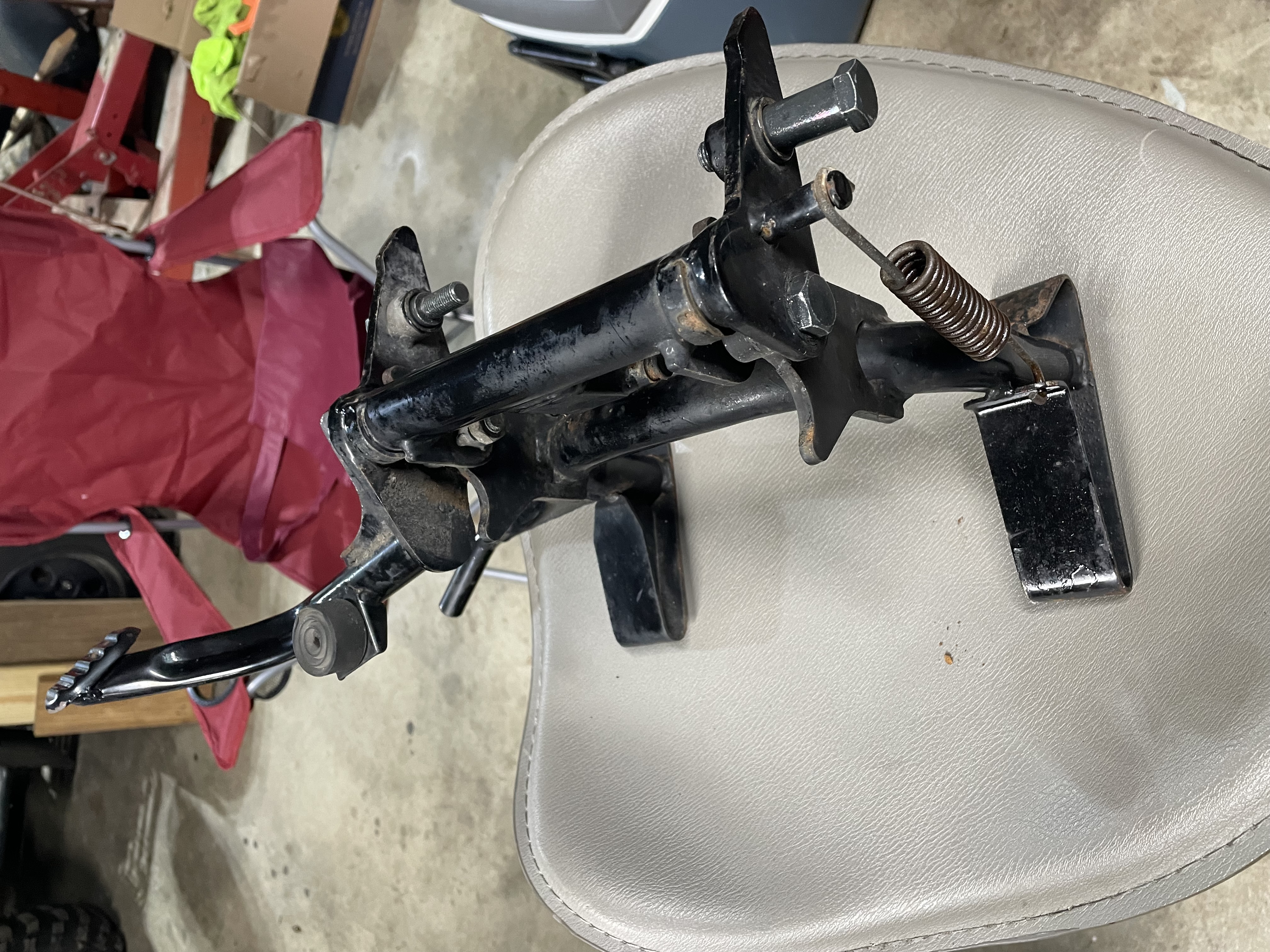

My machine did not have a center stand when I purchased it. I have since received a stand from ebay but it’s missing some springs. It only has one attached. I also had to order 3 of the bolts.
Any chance of getting someone to snap a pic or two of your center stand under the bike in the stowed and extended positions to help me identify where the springs go? I also still need to find the springs and order.
It also looks like I will need to drop the exhaust to get the mounting bolts in for the stand. Any tips on minimum exhaust removal to complete this task?
Looks like the 2 missing springs attach near the center of the stand, but what do I attach the other side of the spring?

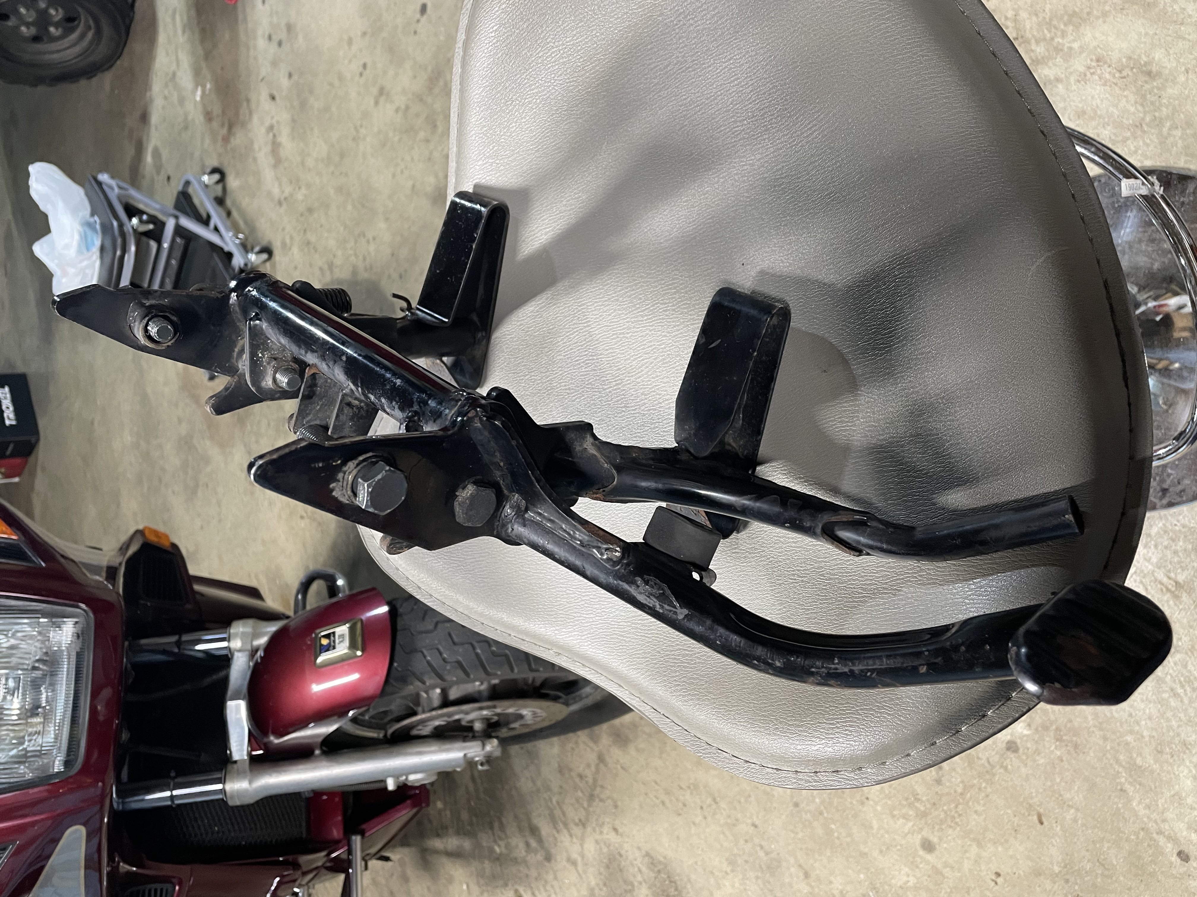

Here's some pics.
Excuse first pic. It is from another post.

Re: Installing Center Stand
Post by Riley1841 »

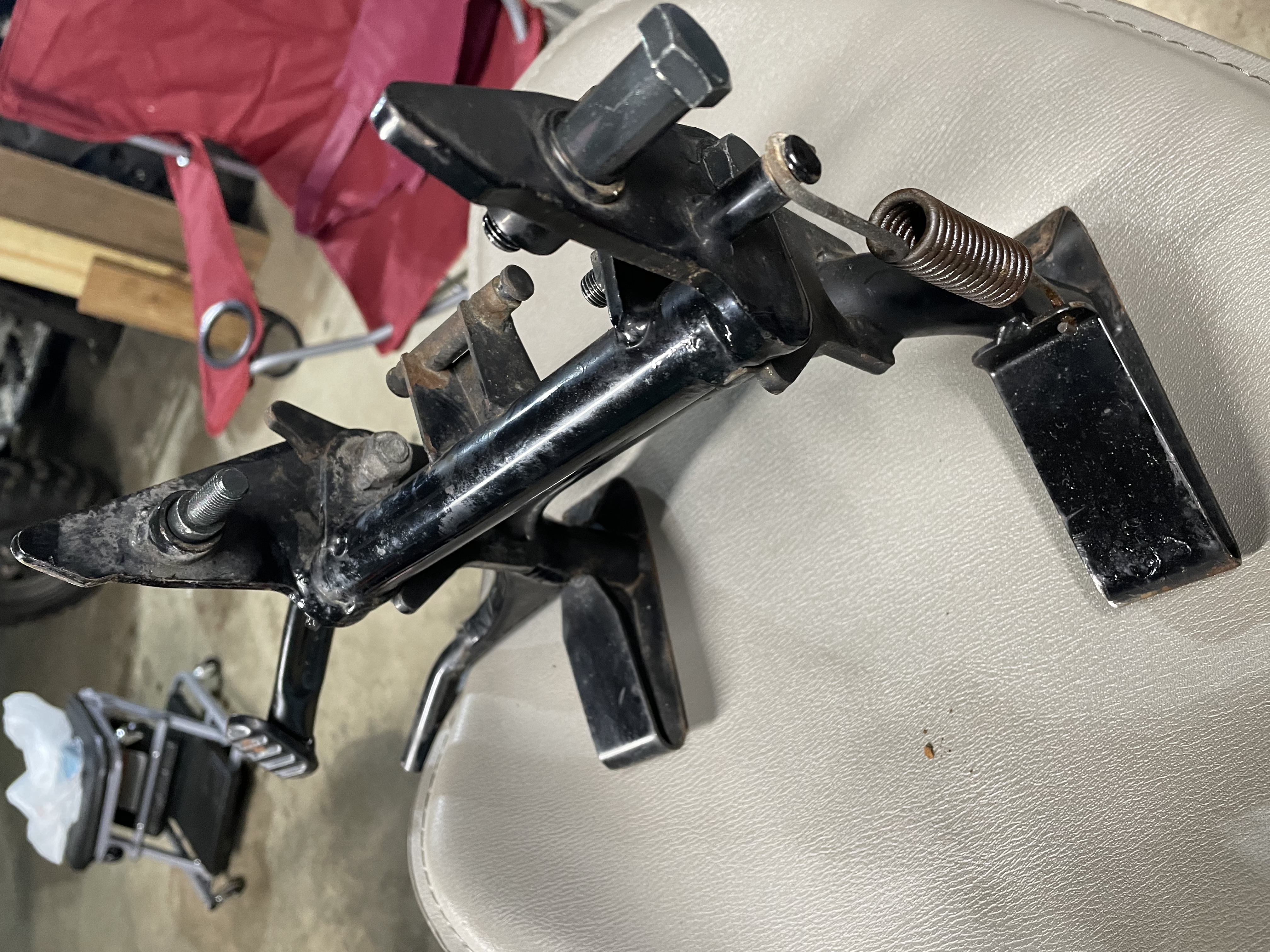

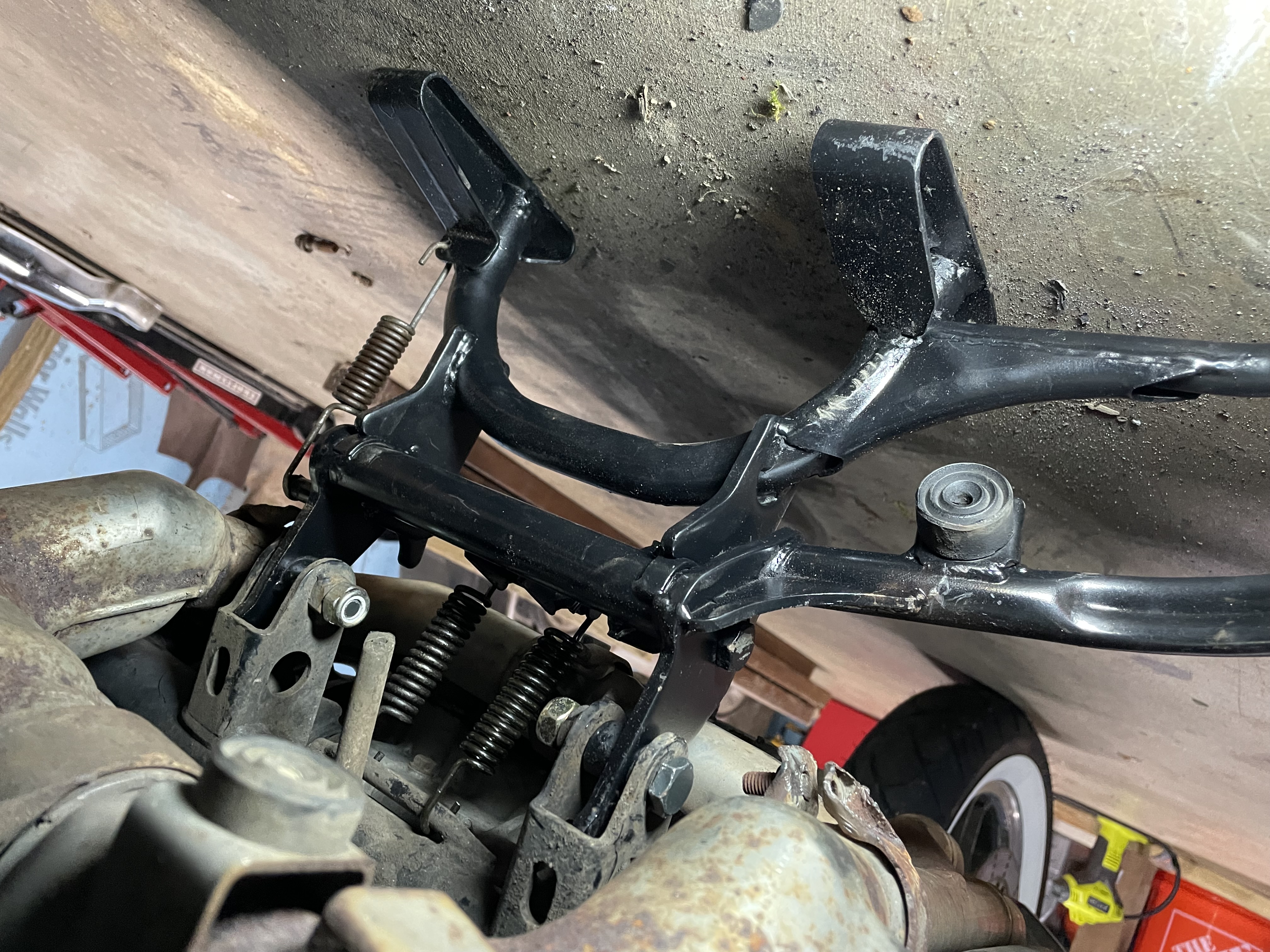

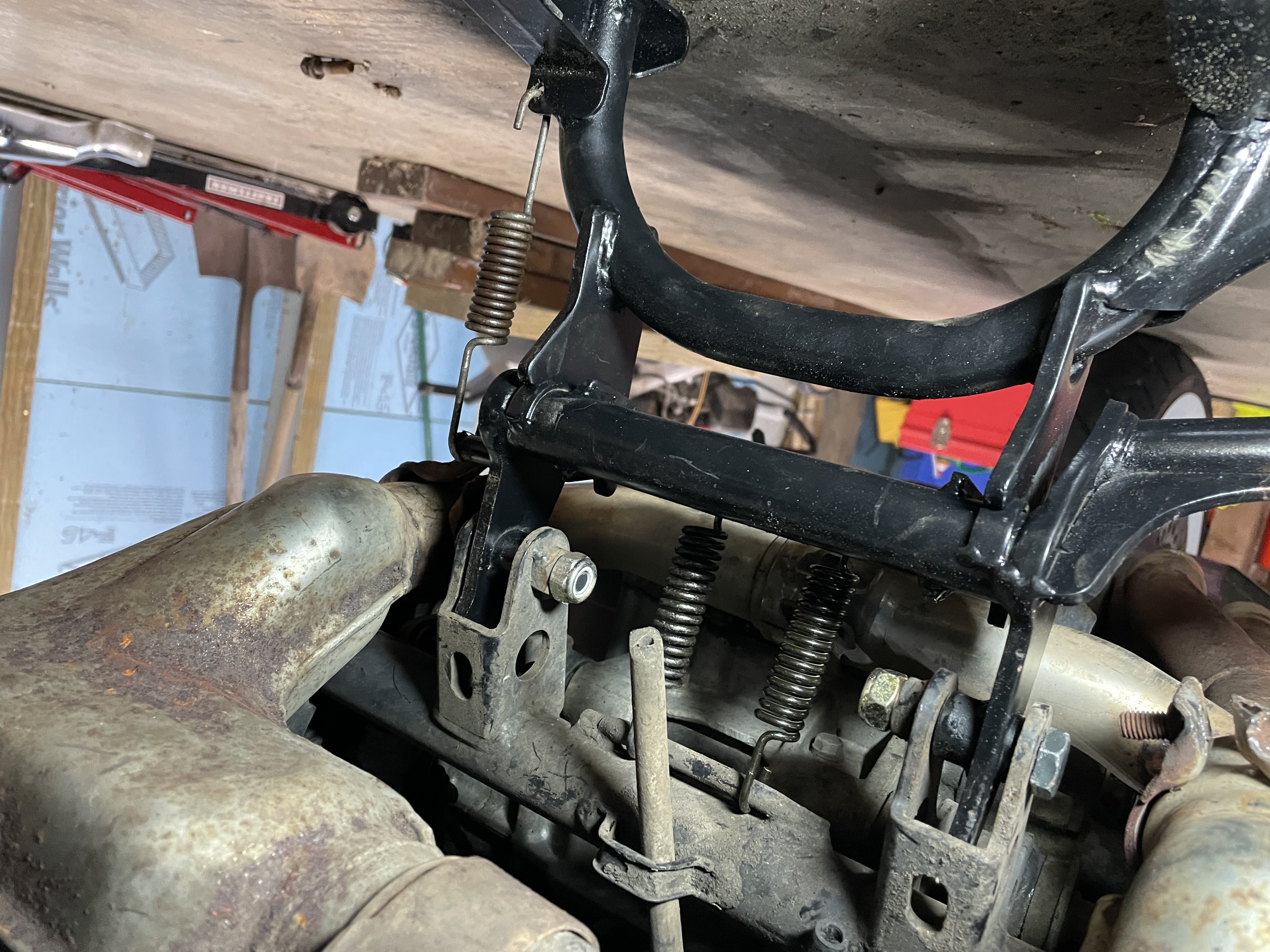

Here is some more.
I'm not a great photographer. But hope these help.

Those pictures will be a big help, Riley. Exactly what I was hoping to see, thank you for posting.
Riley1841 wrote: Sun Jul 23, 2023 7:44 am Here is some more.16007.jpg16008.jpg I'm not a great photographer. But hope these help.
