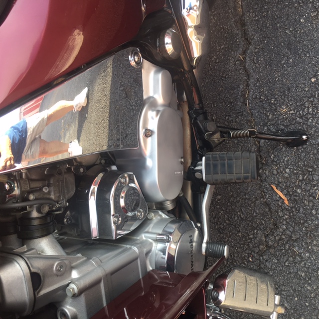

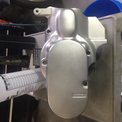

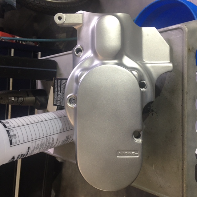

I discovered it wasn't basecoat/clearcoat. Only clearcoat. Dry blasted with 70-100 glass media and then wet blasted. Really looks good. You'll have to take my word for it because I can't figure out how to post pictures.

Oh, we're never gonna believe you without pix. Nope. Uh-uh, didn't happen. Don't believe you. No way.Larry in Arkansas wrote: ↑Sun Sep 24, 2023 8:38 am I discovered it wasn't basecoat/clearcoat. Only clearcoat. Dry blasted with 70-100 glass media and then wet blasted. Really looks good. You'll have to take my word for it because I can't figure out how to post pictures.![]()

Definitely look cleaner, that's for sure. Any plans to polish and protect them?

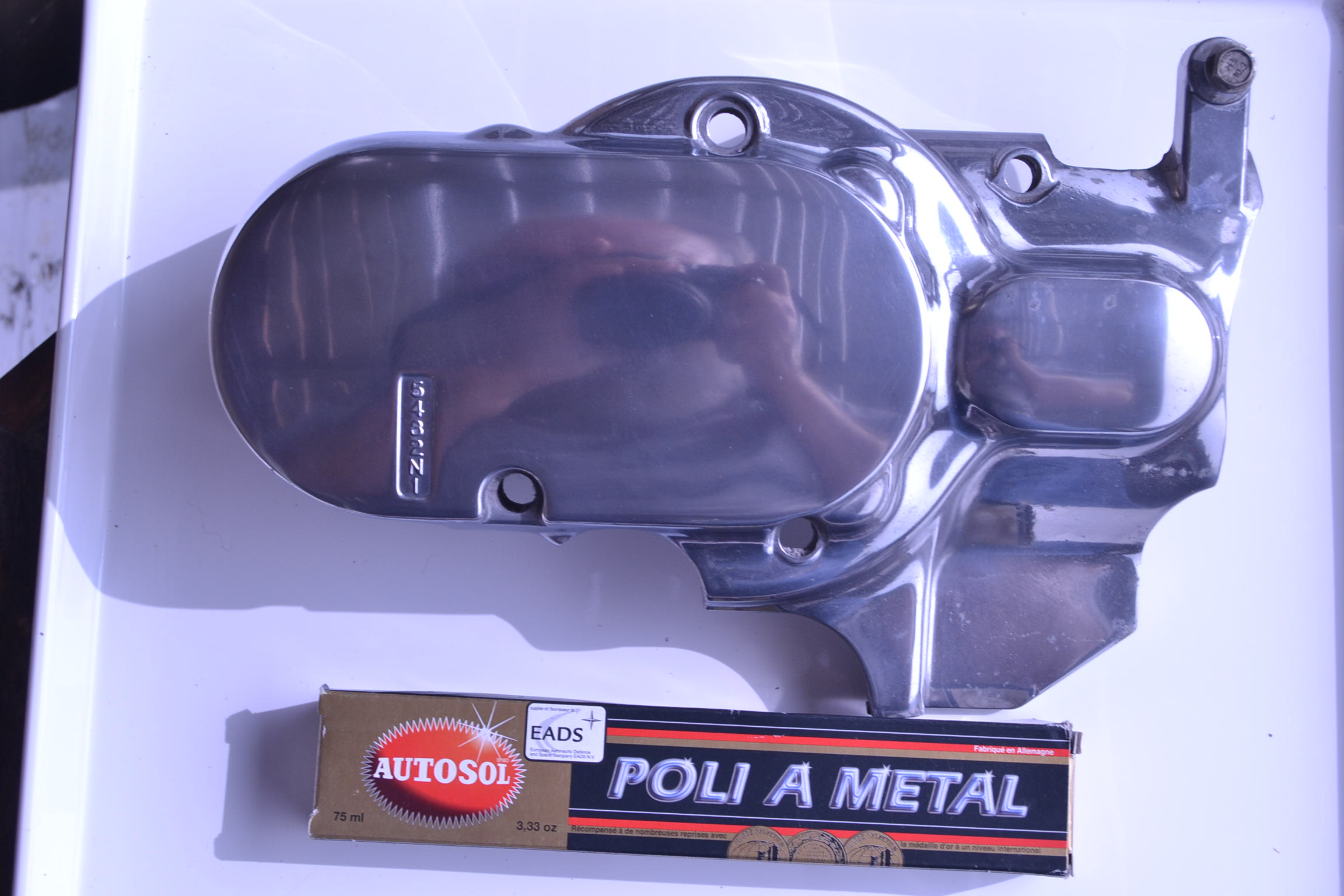

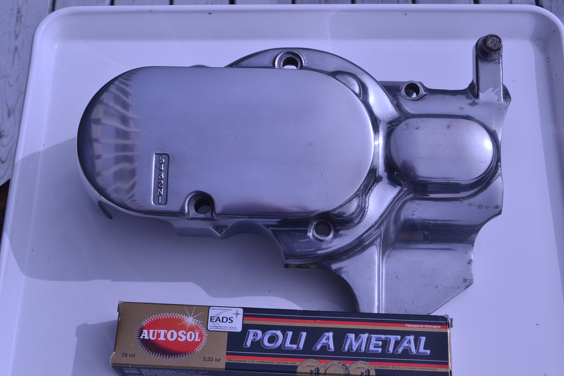

As Grandpa said they certainly do look clean and uniform but for those of us who like that highly polished look I am posting 2 photos of a bevel gear cover I am working on. After the clear coat was removed I started with decreasing grits of sandpaper to remove the nicks and deep scratches. First was 400 and then ending with 7000 grit. This was followed by using the polish shown in the photos. It is available at Grainger's and most motorcycle dealers.
Note the remaining clear coat by the chrome air box cover mounting bolt location as this cover is not finished yet.
One can see the railing balustrades of my upstairs deck in one of the photos and a rare image of me in the other: hidden of course by the camera.
It is a lot of hand work but short of chroming the cover this is the best I could come up with.
This job is not for the weak or faint of heart but when one is retired one has lots of time to get surplus inventory ready for storage in the great hidden treasure vault of shiny spares, radiators and Markland items.

I probably won't polish them. They somewhat blend in with the chrome covers and painted engine. The vapor blasting actually seals the aluminum somewhat. I have some older restorations that I vapor blasted 6 years ago, forks, engines, etc, and they still look good with no discoloration or corrosion.GrandpaDenny wrote: ↑Mon Sep 25, 2023 9:27 am Definitely look cleaner, that's for sure. Any plans to polish and protect them?
