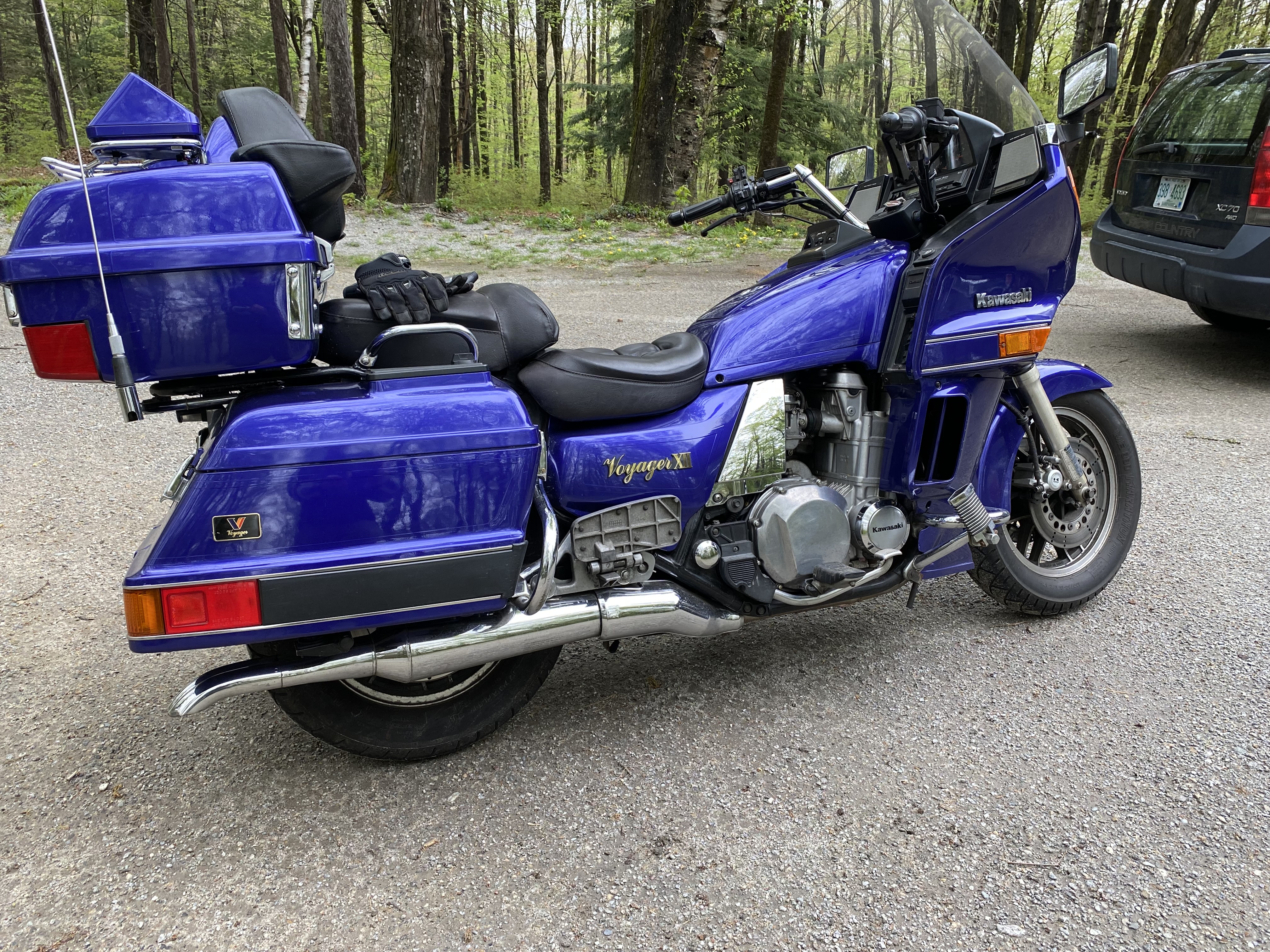

Who likes blue?
My old girl, just 50 k miles

The previous owner had it professionally painted at no small expense. He had it stored at his summer home and mice took it over. The surge box was completely filled with acorns. They had a large nest atop the radio. Luckily Kawasaki had the forethought to equip the radio with a rubber sheet on top of it, preventing any damage. I had to take all the vent ductwork apart and soak them in bleach. I could smell mouse pee on hot summer days coming thru the vents. The worst issue was the mouse pee down in the spark plug wells, corroded the plugs threads effectively locking them in the head. I was only able to get two of them out. At 50 k + miles it’s still running two original plugs. I’m considering trying to remove the other two this weekend, have been soaking them in ATF/ acetone mix. Don’t want to have the plug break during removal attempts, it runs great as it is, just hunts about 50rpm at idle. The other two I was able to get out required 1/2 breaker bar and a length of pipe, pretty scary stuff. If I encounter too much resistance on the first plug I will probably leave it alone, not worth creating a huge problem for myself

It looks really nice, IMO. They did a nice job on it. This also makes it unique.
Good luck removing the plugs. If you get them out, I suggest NGK Iridium plugs as replacements. They're spendy ($10+/plug), but worthwhile, IME. They require less energy to fire, which means they will likely never fail to fire, unless the wires from the coils open. The other nice part is that in a car, Iridium plugs will last 100k miles, possibly longer in a bike -- not sure.
I recommend applying anti-seize on the replacement plugs' threads. Cheers!

I was able to get the plugs changed without drama, my home brew acetone/atf certainly made it easier.I changed all four with new NGK standard plugs.I plan on pulling the carbs soon to clean the pilot jets and install some sexy knurled brass thumbscrew idle mixture screws i bought years ago but never installed.It runs great as it is,but not quite perfect when cold.I havent ridden it much in the past few years as my motorcycle hobby has led me in many different directions,german,italian,and certainly japanese bikes.The voyager is just too good of a machine to just let sit in the basement.I have been pricing new inlet rubbers for the carbs, probably change those as well.Probably hard as rock.I just picked up a used corbin seat on ebay from a fellow member.Typical corbin hard as a wooden stool but provides much needed leg room and it accepts a backrest which i "borrowed" from my BMW.
