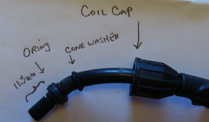

Once removed, this is what the end of the plug wire that goes into the coil looked like on my bike

In place of the picture, I had a message saying that I didn't have permission to view the files! Can you post a photo, or at least describe what was shown? Thanks.....richardb, austin wrote:Once removed, this is what the end of the plug wire that goes into the coil looked like on my bike

uhhh, Ron, why can't he see my pic? I posted a picture. It's a close up of that final segment of spark plug wire that fits into the coil. Shows the coil cap, a hard plastic ring that I named a cone ring because of its non-o ring shape and very thin, used I think, to seal the coil cap hole and then closer to the end, a more normal looking o-ring that's very thick. There was 11.5 mm of the end wire stuck into the coil with the thick o ring jammed up into the coil opening. This is hard to write - wish you could see the pic. But it's pretty straightforward in the removal - just don't lose or destroy any of these bits & pieces. I dabbed silicone on the fat rubber washer, not the coil cap, to better waterproof it.
