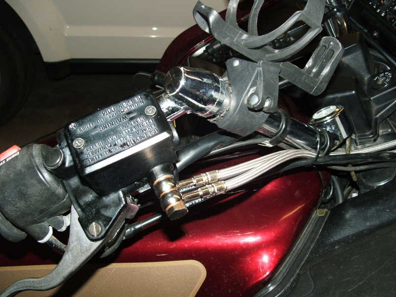

Hello all. Now completing my Galfer braided brake line installation and overhaul of all front brake cylinders on my 2001 XII. I got the lines from Amazon:
http://www.amazon.com/gp/product/B00OBPJEUC for $89 US and free shipping. It says for 1987 to 1993, but I saw no reason not to use on my 2001 and it fits.

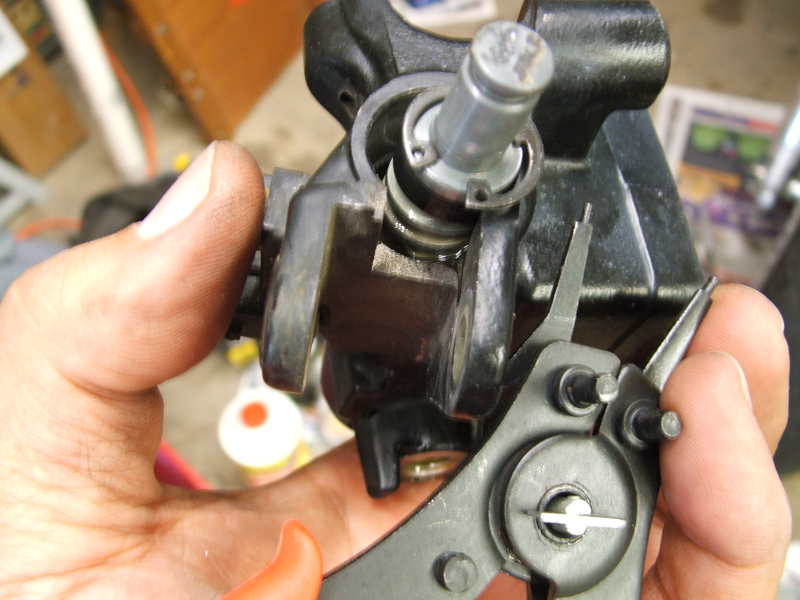

Harbor Freight Snap Ring Pliers #60531 for $4 made disassembly of the master cylinder easy.
http://www.harborfreight.com/snap-ring- ... 60531.html
Note, using an awl, I rotated the snap ring toward the brake handle cutout notch for more clearance so pliers could fit. Using the smallest jaw pins and a good light source for visibility, after working the pins into the snap ring holes, it was out in a jiffy. Tool is light duty and if I were doing this for a living, would opt for the best, but for the home mechanic, it is a God send.

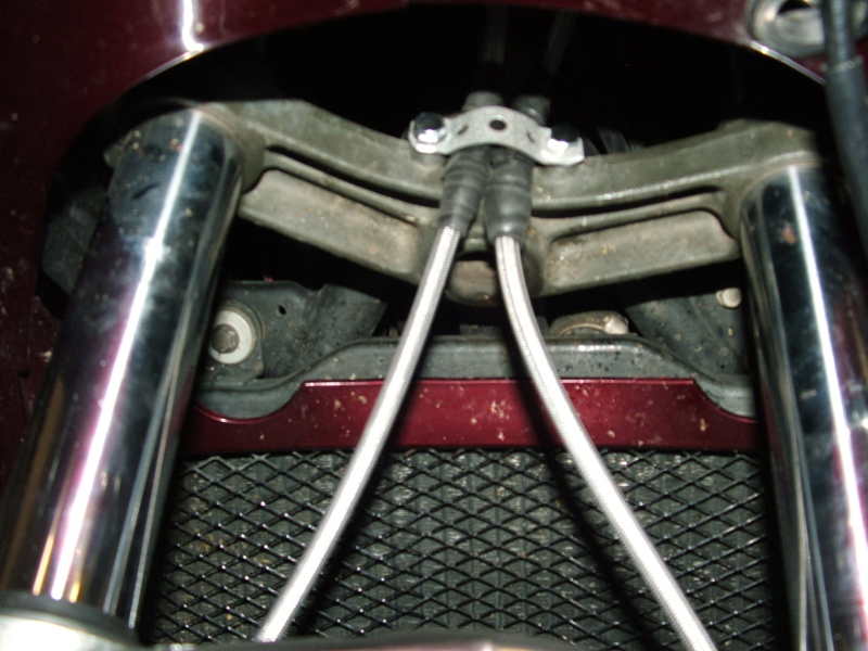

I removed the old brake line in its entirety including the hose splitter. Wrapping the lines with high voltage electrical tape for cushion and protection, I used universal strap and short bolts to hold lines to bottom of triple tree.
These new lines are neat in that they provide direct fluid straight from the master cylinder. Also, they have a lifetime warranty. Kawasaki owner manual states to replace brake lines every 4 years and overhaul the master cylinder and calipers every 2 years. I don't know who all do that in reality.
Galfer line connected to newly overhauled left caliper.

With line splitter removed, a universal strap holds lines in place under the triple tree. I suppose one could simply reuse the splitter with hoses removed as a clamp, run lines behind and clamp with nylon wire ties.

These new lines go direct from master cylinder to each wheel caliper.

Harbor Freight snap ring pliers made easy work removing retainer to the piston assembly.

$89 Galfer braided steel front brake lines.
