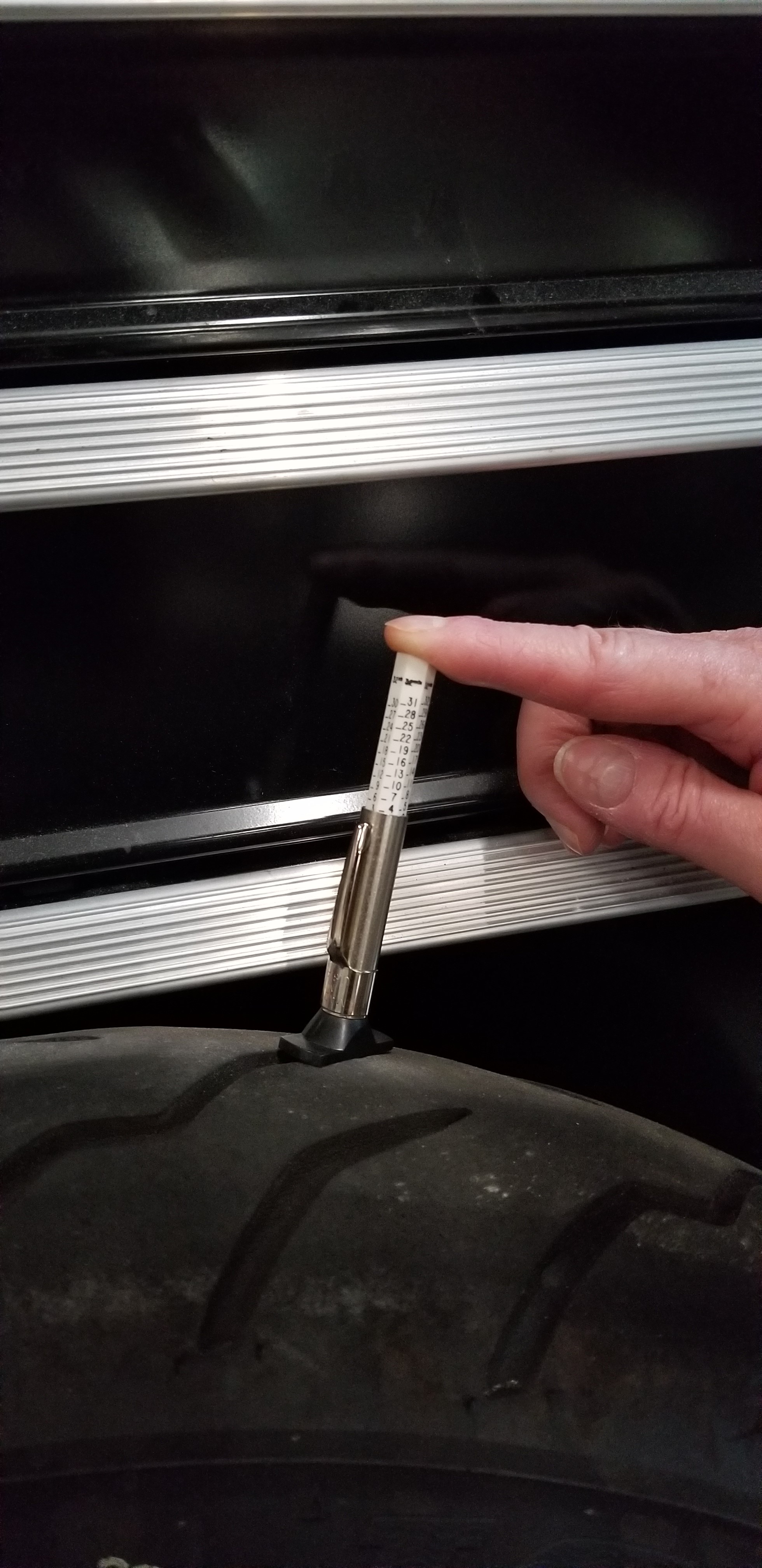

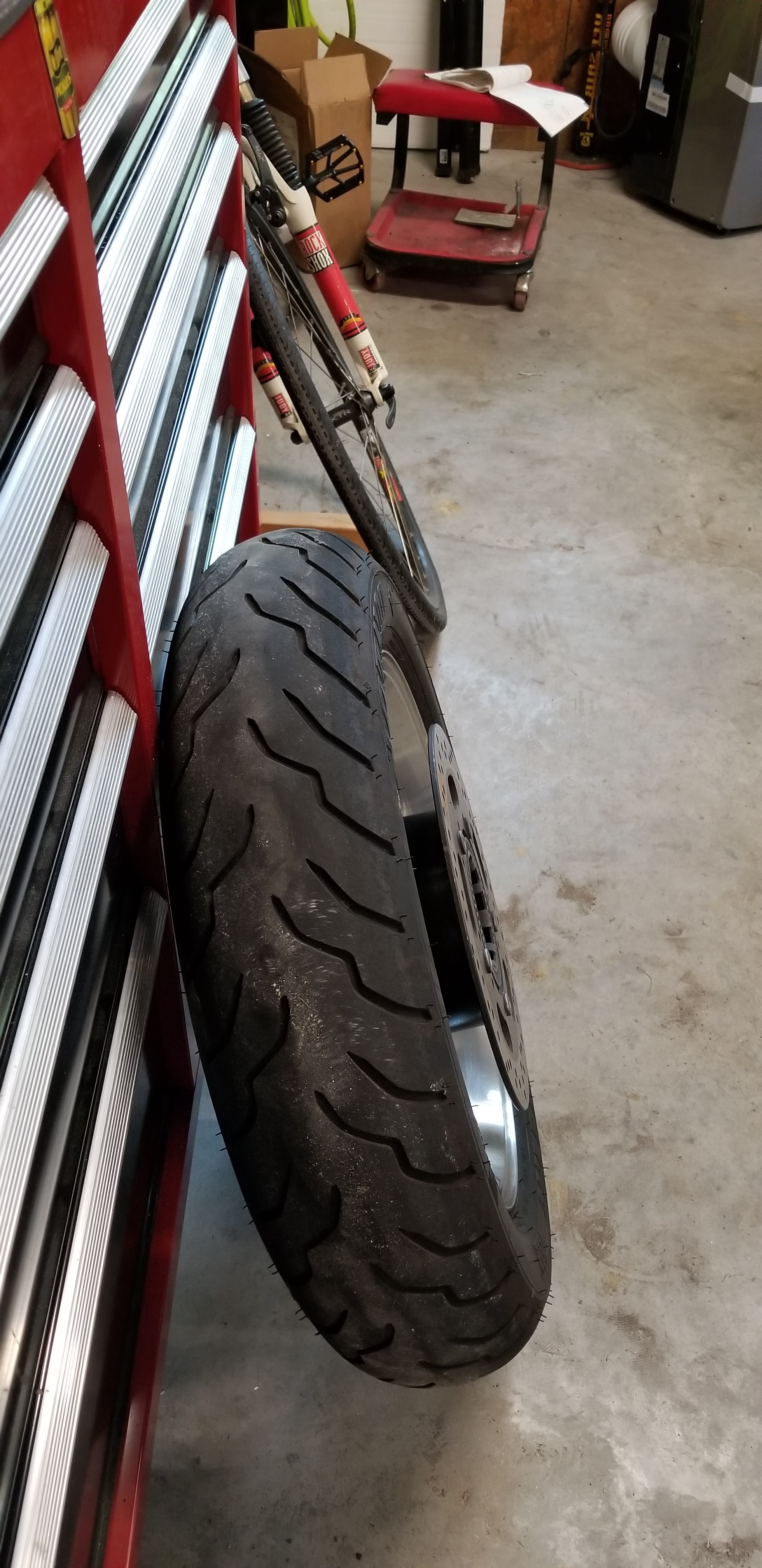

First I had to remove the front wheel. What a surprise when I removed the front tire and it still looked good. I've had this tire on for more then a year, but didn't remember how long or the number miles this tire had traveled on the front of my Voyager. 20,000 miles and wear is only down to 4/32
See how there is no cupping on the tire, it smooth and round. I have Race Tech fork springs installed with 5# fork in the forks. The tire was balanced 20,000 miles ago.
