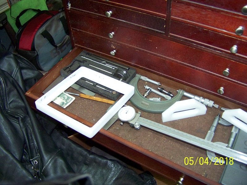

Since this is a 100k service there was allot to do and look at, and all went well. Even the new modification to the air filter box. I wanted to retrofit the STP WITHOUT trimming or using glue each and ever time. So using .750 thick plastic ; I set out to make a transition box that would be installed into the air box and make the next air filter install a snap. Not something I would recommend for those not willing to spend an extra expense of the high cost of the material. There are two words that will never go together well. CHEEP AND PLASTIC---with an overall size of 6.780 x 7.180 a 12 x12 x 3/4 was required . Quite a bit of waste here but I don't expect to see me making these up for sale. But with the foam on these old saved air filters for retrofit beginning to rot from old age I just don't want to risk fouling up the carbs from such a move and having to trim and glue every time I changed it out. The material cost was 47.00 but from now on 5.62 for a new filter and 10 min. gets the job done. Working on the lift is such a nice change and I hope to be on the ground and running today. Here is a list of oil leaks I discovered while changing out ALL THE fluids
