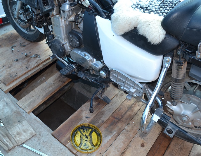

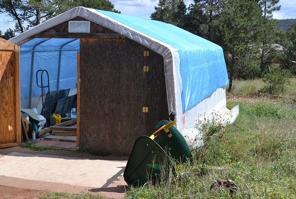

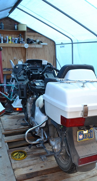

Since this blog is slow these days anyway, thought I'd send photos of my "shop".
Ho hum.
The service pit is about 44" deep. I poured it one fall several years ago, planning to build the rest of the rest of the garage the next summer. Alas.
That's a greenhouse canopy, for reuse elsewhere in the yard. It generally pegs the thermometer (120F) these days, but is only up to 100 so far today. (I hide in the pit.) Ergo the blue tarp. But often nice in the winter!Ho hum.

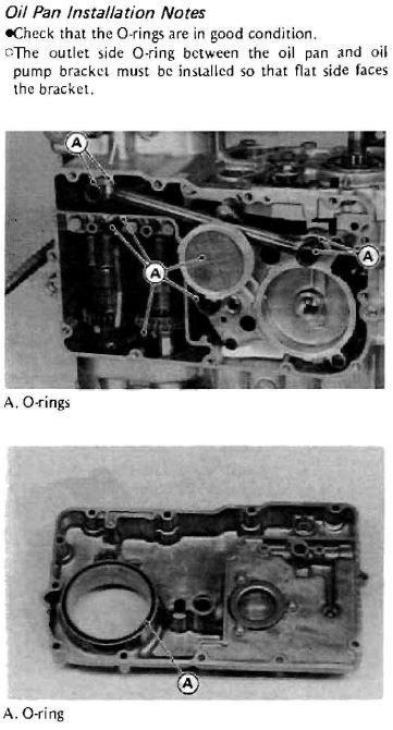

oil pan o-rings
From the Service Manual available from AVA:
To replace these o-rings, it looks like I need:- 671B2590 (1) This 90mm pup goes between the the oil pan and the oil filter housing.
670D2016 (4) One of the internal oil pipes.
670D1509 (3) The other internal oil pipe.
92055-1136 (1) The oil return plug. Looking at it, I think I really need two of these.
92055-1146 (1) Another plug, on the side.
11009-1376 (4) Brass gaskets for an external oil pipe (banjo bolts).
11009-1344 (4) Another external pipe/banjo bolts.
