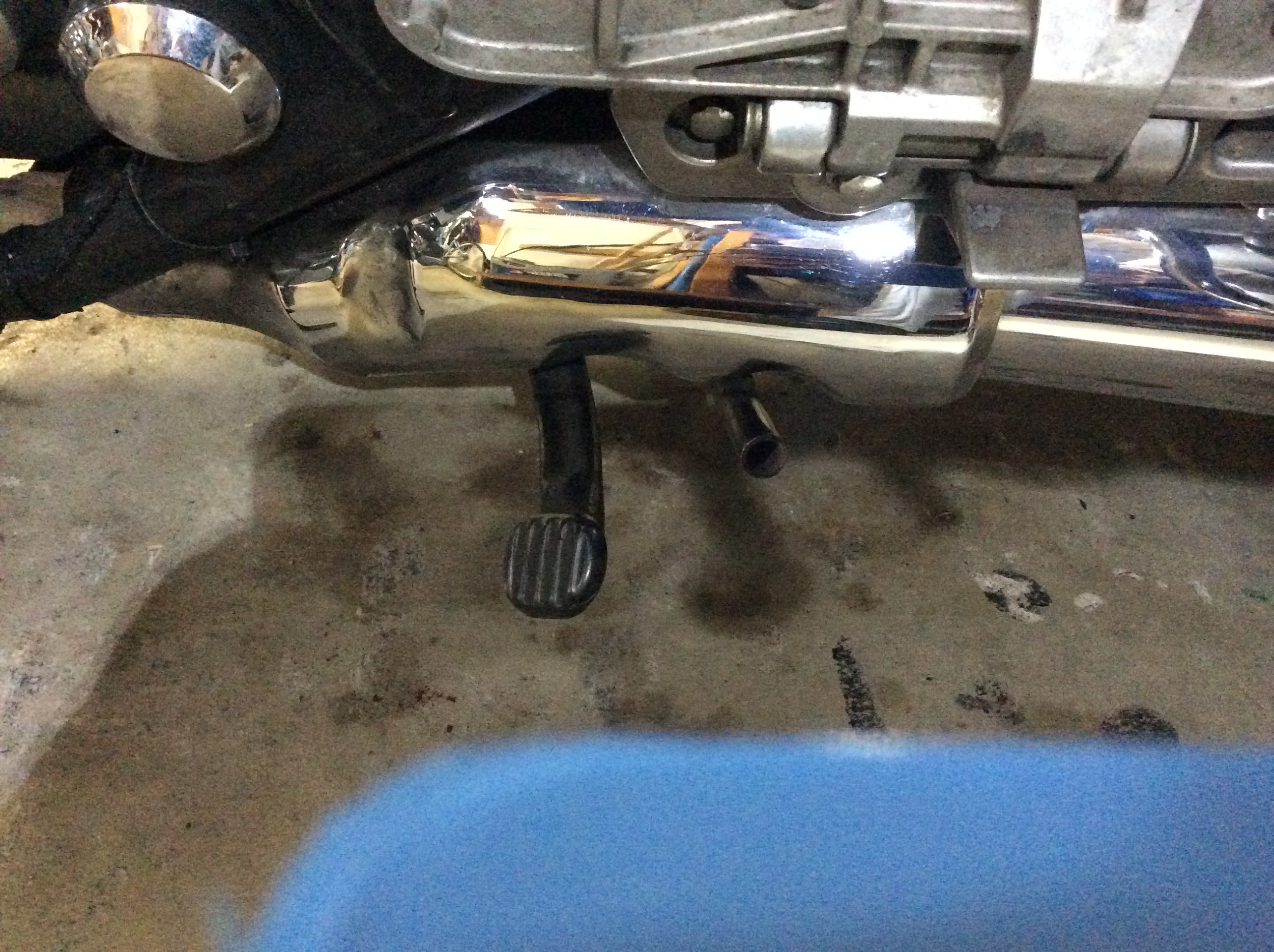

Re: Bumpy ride
First thing you should get is a center stand. You will need it for a lot of maintenance. You can find them on eBay. Make sure it has the first stage lever otherwise you will fight it to get it up. There are YouTube videos on using the center stand on a voyager. Very easy. I can get mine up in my flip flops.
- Posts: 1831
Re: Bumpy ride
Well, I sure can't get my XII up in my flip flops. I "fight it".VoyKimmer wrote:Make sure it has the first stage lever otherwise you will fight it to get it up. There are YouTube videos on using the center stand on a voyager. Very easy. I can get mine up in my flip flops.
What's this "first stage lever" you speak of?
Re: Bumpy ride
... the back lever puts the feet down, the larger one to the left / front
levers the bike up onto the feet...
- Posts: 1831
Re: Bumpy ride
Okay, I've got that. Didn't know there was any other kind.
I still fight with mine, even after Progressive springs. Mine seems to sit low. Maybe I need more air in the shocks.
But it's always been a struggle.
