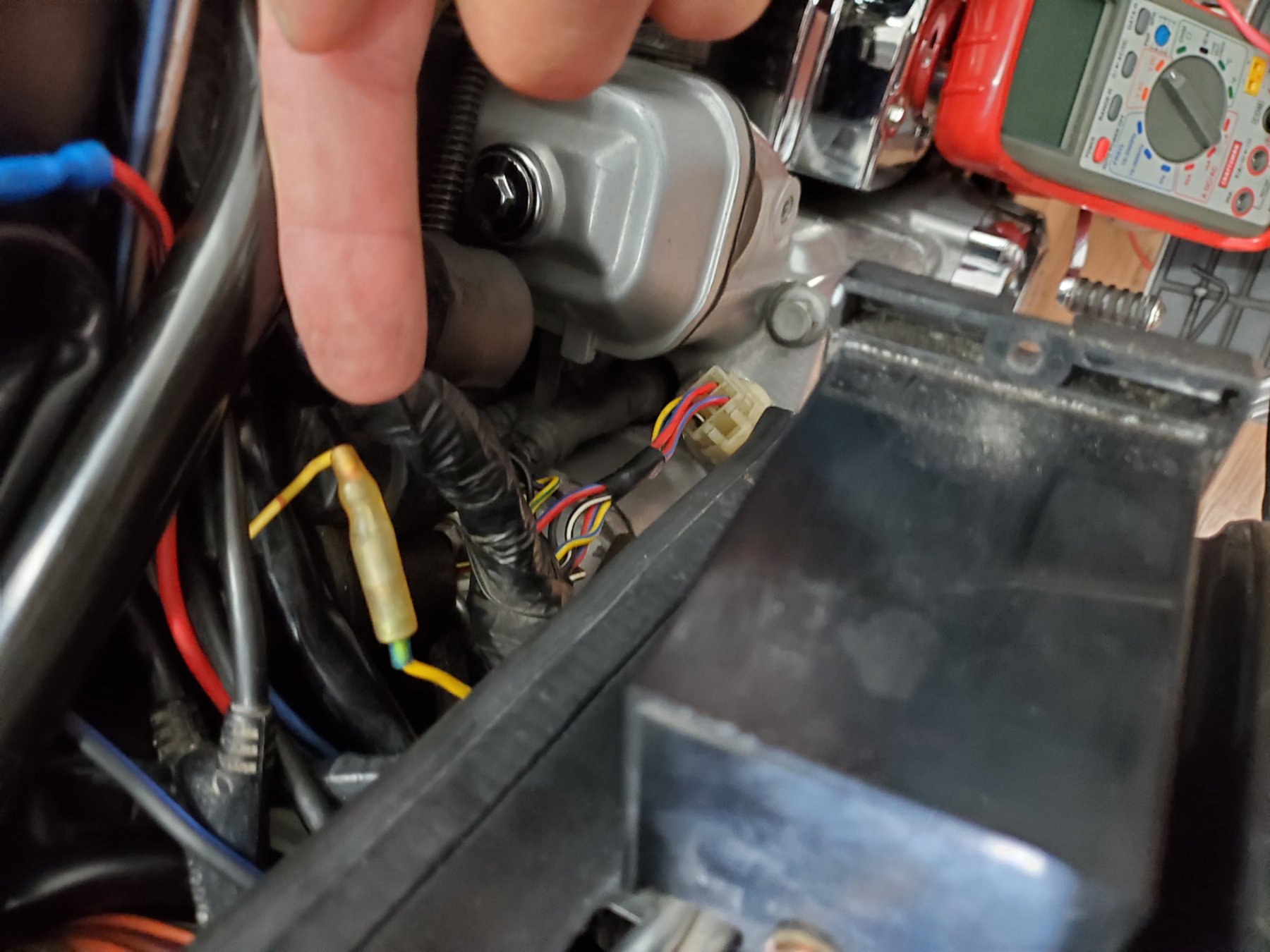

THAT IS IT!!!
I continued to dig and found a female Y end buried loose along the frame, and mated the loose Y bullet (male) connector.
Quick toggle on the Starter button and LIGHTS!
Started engine, ALL LIGHTS ON!
Thank the Lord, and God bless you guys and triton28 for continued assistance and advice!
We have power to all the lights!
I will immediately heat shrink these Y ends together so they are much less able to separate.
Hallelujah!
THANK YOU!
