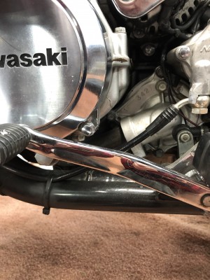

On the wise advice of Don Medina about avoiding the high head temps, I need to route my clutch line along the OEM one down the frame, but am stumped as to finding the right spot near the frame to fit it?
Anyone out there who replaced their clutch line with a stainless one have a pic or two of how they routed it?
Much obliged.
Any stainless clutch line pics out there?

It’s been a while and I don’t have my failings removed right now but I believe I mounted mine exactly like the OEM line. Down the handlebar then to the left frame rail with thick zip ties .
Here’s a pic of slave cyl.

Photographic proof that even this old, blind hog can find him an acorn every now and then.....
