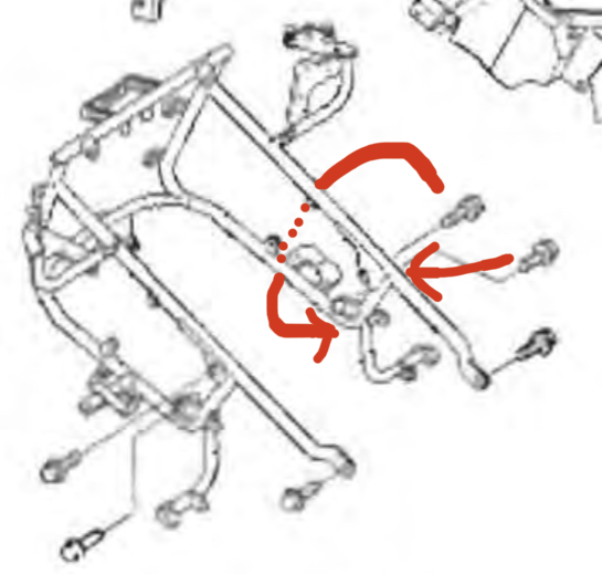

If you hear a squeaking sound while riding that comes from somewhere in the fairing, it's probably your right side frame bolts.
This is the fairing frame, and best I can tell the two bolts with red arrows are the two that were only finger tight on my bike. I tightened them up, and my fairing has stopped squeaking at speed. I was able to tighten the top bolt easily by removing the false tank cover, and was able to cram my hand and a wrench into the fairing hole by the engine head to tighten the lower one.
If these aren't the two bolts that normally loose let me know!

Sidehopper,Check all the fairing mount bolts! Only one of my bolts was tight.
I found that because if a squeak in the front of my bike.
If I remember,there are six.

A fairing teardown is on my list of maintenance jobs so I'll definitely check out the other 4 bolts soon! I'm happy you said you had a squeak too, seems like the best way to tell (besides a teardown) since the squeak only starts around highway speed.cushman eagle wrote: ↑Sat Jul 17, 2021 1:02 am Sidehopper,Check all the fairing mount bolts! Only one of my bolts was tight.![]()
