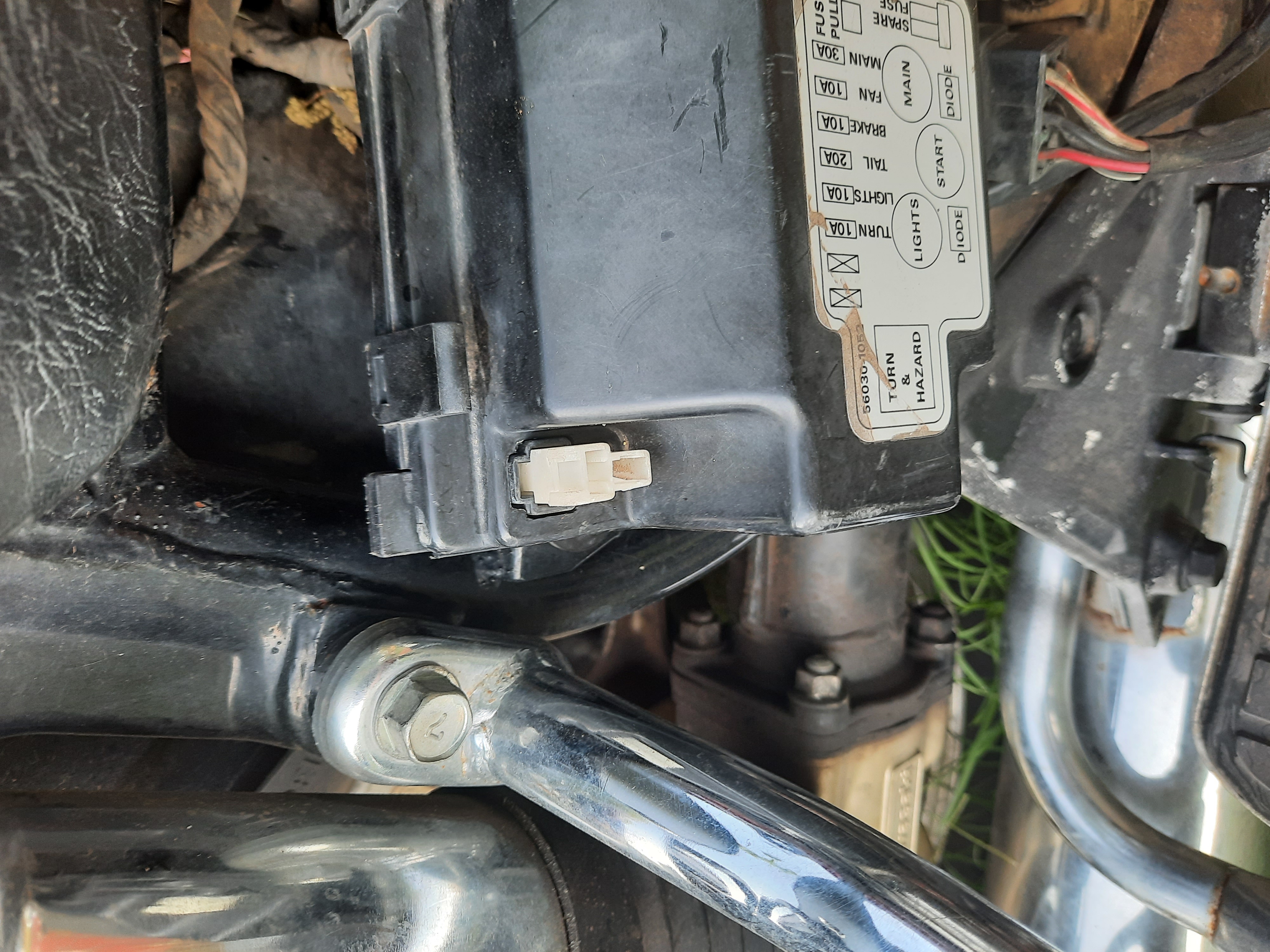

I sold the 1300. It was easy to sell because it was in easy to restore condition..y 93 however had many busted fairing parts. I have taken many parts off, reduced the bike weight a lot. The upper fairing halves i will have to reinstall because there are too many things and a zillion wires i cant eliminate without screwing something up. I want to take pictures of some wiring thats just dangling and hopefully you guys can tell me where they go.as bad as it now looks it still starts and runs.before i pulled the igniter back, removed the airbox and battery tray i coukdnt see how to remove the carbs.the tiny phillips screws holding the clamps would be impossible to get to with everything in place. One of you said he wouldnt help me if i cut corners such as trying to use tires off the 1300 or just one throttle cable. The tires are totally different .i thought i could save money.not cut cirners. No bike i owned has more than one throttle cable . This one does and by design has to. I know now. I see the cable and how it connects to the carb linkage. Only one though.my manual shows 2 cables, connected to a box. Then just one to the linkage and the second stop at the junction box, is that right?? Please help.thank you.

Now i have a bigger problem. I took all the wiring out intact from the saddlebags.connectors and bulbs intact and the tailight with wires and connector intact.BUT my manual chapter 15 has wiring diagrams. The writing is almost microscopic.all in black and white.is there any place i can find colored diagrams or even black and white ones with letters large enough.with straining my eyes and a flashlight i could see gy which means grey.but till i shined a bright light on it it appeared oy.orange with a yellow stripe. I will never be able to do this at this rate.

I found a old internet post a guy posted general wire colors used on the different jap bikes.for kawasaki he said: taillight red. Brake blue. Left signal green. Right signal grey. High beam red with black stripe. Lowbeam red with yellow stripe. Ground wiire black with yellow stripe. The former owner cut a jillion wires and put small connectors on them that resemble a C shape.they would appparently go under a screw. Some existing connectors werent cut coming from the bike. When i removed the wires from the saddlebag it seems those would supply turn signals, stop and tailight, license light. Those wires are intact.but the connectors from the bike to them are largely eliminated.

Partzilla has the Voyager XII motorcycle service manual supplement for sale for $25.00 plus shipping.
Part # 99924-1089-61
It has a complete wiring diagram plus specs on the cruise cntrl (including wiring diagram) and cruise cntrl cabling
related to the throttle cabling w/the junction box.
