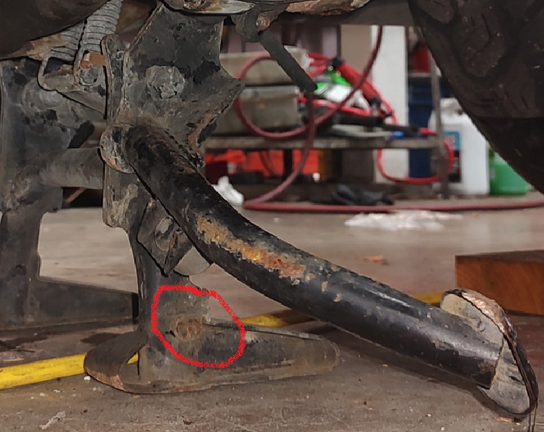

Finally got the bike up on the center stand by putting a 2x4 behind the rear wheel and rolling it back on to it. This was before I got the air working to the rear shocks so maybe it'll be simpler now I have the shocks working again - maybe - it ain't easy with the stand the way it is for sure!
I took a couple of shots of the stand and it seems like there was another piece or place for something? There's a rubber grommet on a bracket under the arm that doesn't look like it does anything ...so maybe there's a piece missing from there? I guess not, that's probably part of the mount when it's up?
Looking at the pic in the link Dave posted seems like the other bit has broken or rusted off. If I had a pattern maybe I could weld a piece on -but not knowing the angle or the mechanics of it, that looks like a no go.

This looks like where that second lever rusted off:
Per the various vids in Wedistan, this missing lever is really the first one you're supposed to mash down to get the stand's feet on the ground. The lever you have is for lifting the bike straight up onto the stand.
Yeah, it's a bitch to use as if it were a one-piece unit. And doing that, it's entirely possible to put the bike clear over the stand, so that the stand is folded forward. Then what are you gonna do? (I read about the clown who did that. Somewhere.)

I bought a new stand; the one posted above on eBay. Soon I will have more into this bike than the bike is worth ..mostly spent on shipping LOLNails wrote: ↑Mon Dec 16, 2024 8:03 pmThis looks like where that second lever rusted off:
Anyway, all in. I'll get the bike working in all aspects.
Larry
