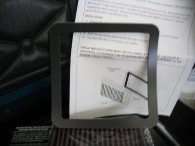

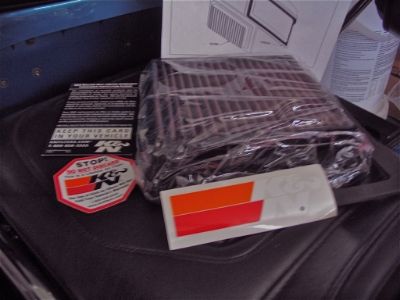

After Reading these Air Filter posts, I decided to spring for the K&N filter too.
Being a stock guy like Kap, I'm still feeling uncomfortable switching out the stock filter. After all, OEM is what I'm used to purchasing for my XII going on nearly 20 years now.
I'm not sure where or what to cut and the procedure for oiling either, so for now, I'm not sure that I'll install it, unless I can get more info on installing and caring for the filter.
It's a nice looking filter, and I do like the decals it came with too.
I read some posts that state: Trim an 1/8" and some that say - Trim 1/4" (might be speaking about different filters?), but not sure if that is around the housing or the gasket?
Another post suggests "place the ribbed side facing down:" Is that right?
If I don't need to service the filter for 50,000 miles, than cleaning / oiling may not be an issue for me, as I just went over 40k (since 1995) going the the 2013 WRR. Since then, I had to have replaced approximately 5 paper filters. At times, I can still hear the engine straining for air even with a new OEM paper filter on it. I'm hoping for better performance with the K&N and less straining for air, so I'm hoping to get it on my XII sooner than later.
Image Image Image
Any suggestions would be appreciated. :hmm:

All I did when I put one in my bike was drop it in, I didn't use the plastic cage from the stock filter at all, I put the K&N in and then I used black RTV sealant to "caulk" around the edges to seal it good so no unfiltered air got sucked in. It was that simple, when it comes time to clean it (once a year) i just cut the seal loose, clean the filter, drop back it and reseal. 50 mph on the superslab at 75mph (That's GPS mph, not Voyager MPH) lol

gearheadfla wrote:All I did when I put one in my bike was drop it in, I didn't use the plastic cage from the stock filter at all, I put the K&N in and then I used black RTV sealant to "caulk" around the edges to seal it good so no unfiltered air got sucked in. It was that simple, when it comes time to clean it (once a year) i just cut the seal loose, clean the filter, drop back it and reseal. 50 mph on the superslab at 75mph (That's GPS mph, not Voyager MPH) lol
Thanks Jim,
You make it sound easy. I'll look for that sealant, and should have it up and running probably by tomorrow.

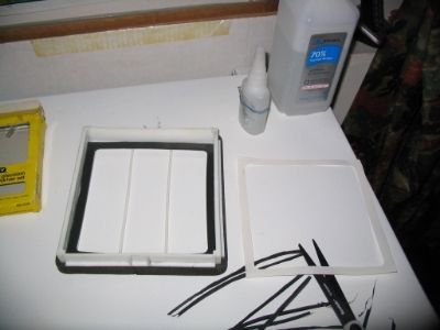

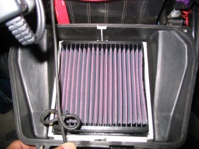

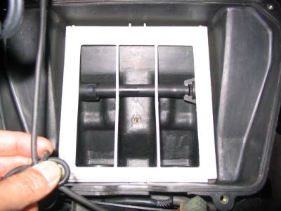

WOW! Just modified my XII's air filter and man does my machine fly.
I needed to customize the install a little more than just popping it in. I needed to trim and install the stand alone rubber gasket, as there was a small corner that was exposed between the old filter frame and the K&N filter itself. Don't forget to remove the adhesive backing, and clean frame with rubbing alcohol, so it can stick properly to the OEM frame. I was able to gently squeeze the K&N air filter into the OEM filter frame without having to trim the gasket attached to the air filter itself.
I think I just added 20 more horses under me. The pick up seems way better than before and there is less sputtering as well.
XII OEM Air Filter Frame with Foam Border Still Attached
Stock XII Filter Frame with Trimmed K&N Gasket in Place
(Needed it b/c there was a small gap between frame and air filter)
K&N Air FIlter Installed
K&N Decal in Trunk Bag
1st Place Stock Touring at 2013 WRR - Ray Walls Fall Classic
I took the XII out for a test drive afterwards, and boy did it fly. The pick up reminded me of riding a 750 Ninja. The good thing was I didn't need to use the silicone sealant, as I got a nice tight fit without any air spaces around the reusable OEM frame, the gasket and K&N air filter.
Thanks to the AVA Members that help making my membership such a terrific value and so much fun. I hope this makes your mod an easy and exhilarating experience. :windy:
