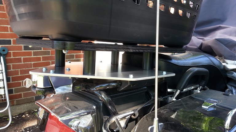

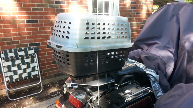

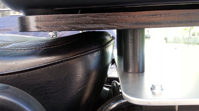

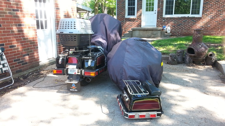

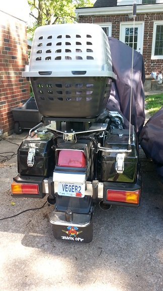

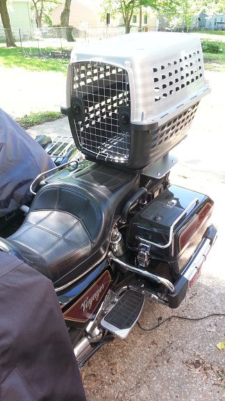

I have a 30lb American Eskimo dog that just HAS to be with me at all times, so she rides right behind me in her kennel which replaces the original trunk. The kennel is mounted to a custom made slide mount using original Voyager slides and latches attached to a plate of 1/4" aluminum, then the kennel is attached to the aluminum. It works very nicely and is easy to swap out at any time with the trunk. my dog is always eager to jump right up on the seat and walk into her kennel. She is my medical service dog and isn't happy unless she is right next to me most of the time. This kennel arrangement puts her cage door right behind me so she can keep track of me while we ride. I also made a nylon cove for the cage in case it rains or is cold.

Of course, my bike is the 1300 sixer Voyager rather than the 1200 XII Voyager, but a similar arrangement should be easily made using the same techniques. I have complete pics of the build if you are interested.
