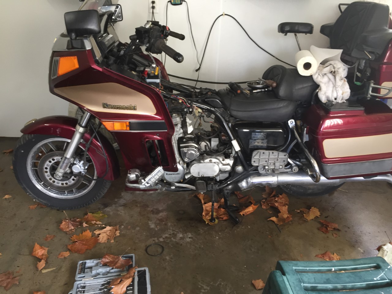

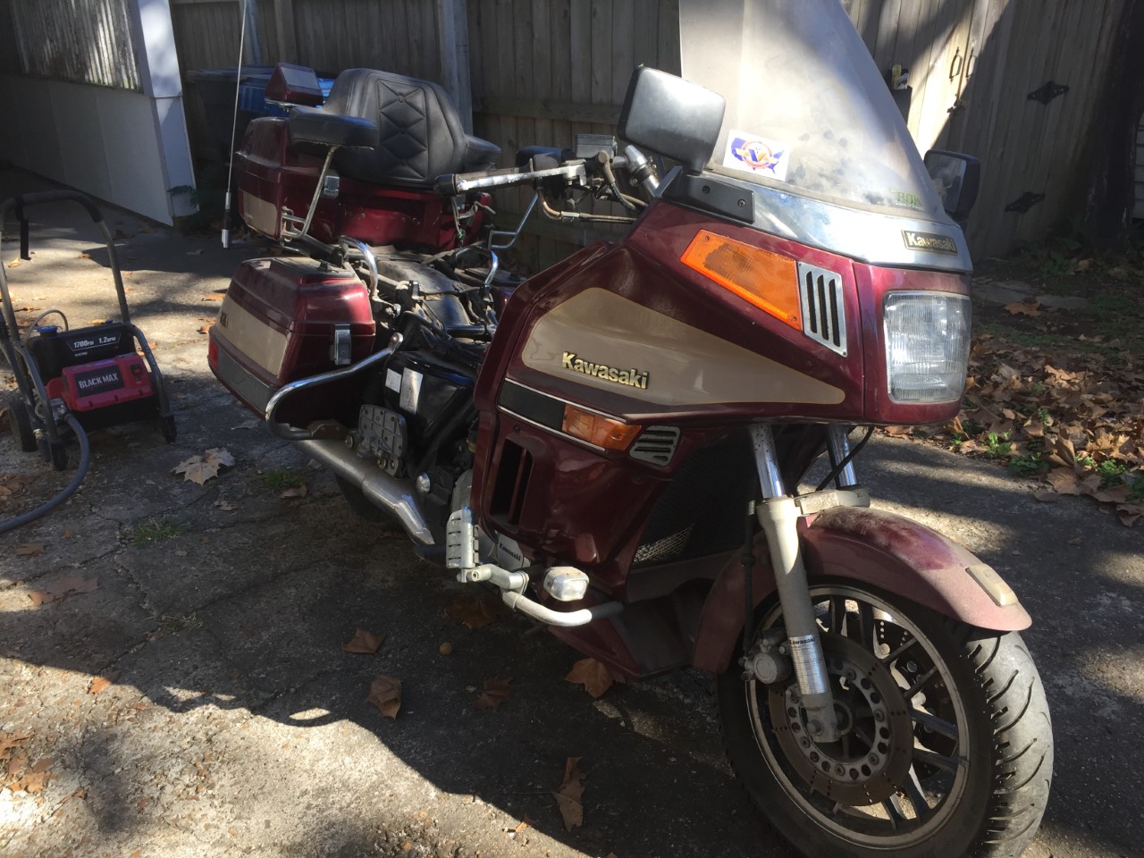

This is my self imposed charity project on my friend Charlie Oneal's 2001 Voyager who died last year from stage 4 lung cancer. The bike is being fixed up to sell with the money going to his widow. This may take some time because I can only do what my health allows but so far I give thanks to the generous donation of a fellow AVA member through which I was able to pick up and install a new battery, air filter, oil filter and oil. Got the oil changed today, did some more cleaning. Overall the bike is in very good shape. I am going to have to dig out my old digital camera to post picture updates. Next I will be draining the fluids and changing them out. Lastly I plan to drain the carburetors if they haven't already been drained. Install a new fuel filter and then fresh gas. Waiting right now on the cable luber that was suggested to use to free up the throttle cables. Then I will free up the brakes. I suspect the bearings on both wheels are going to need attention. I cant wait to start it.

Saturday I completed replacing all the fluids minus the coolant. I cant really do anything with that until I get it running. So far that is a no. I put 2 gal. of gas in her after replacing the fuel filter. She will not start. Acts like it wants to but is pouring gas all over the garage floor. Looks like stuck float valves. Looks like I am going to have to pull the carburetors off next and take them with me to Florida to Carl when I take my Voyager to him. One thing that bothers me is that this bike still has the original air shocks and they don't stay charged. It makes it hell to get onto the center stand. More news to come.

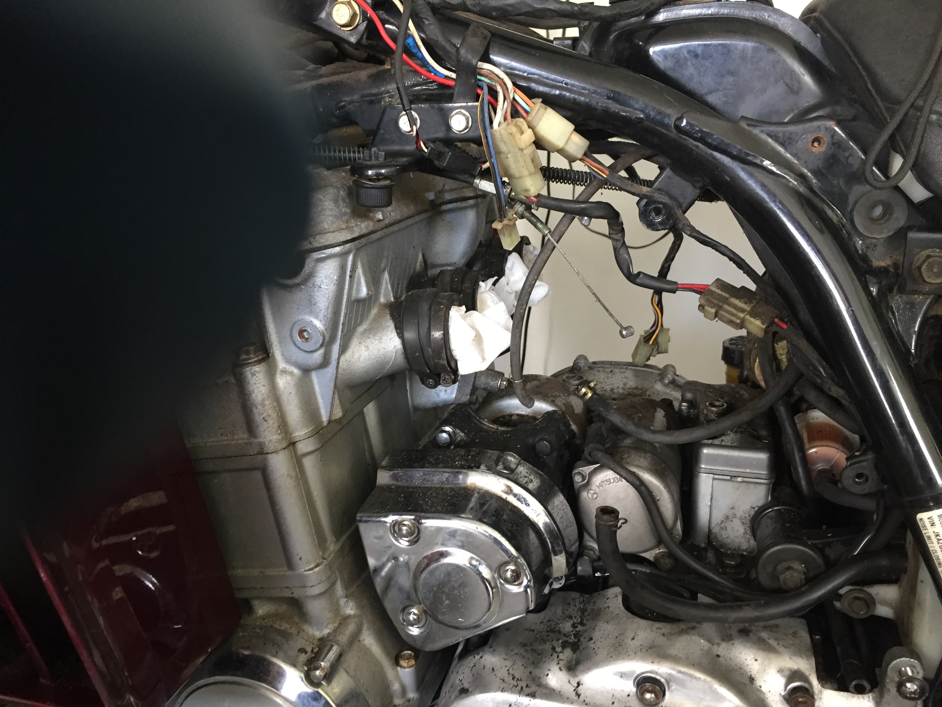

Going to pull the carburetors tomorrow, Tuesday. Anybody have any suggestions on how to ease this process please chime in.

Lots of patience! Lol! They slide out the left side. Starter removal gives a bit more room. Installing is harder, getting everything lined up and connected. The springs on the air box boots to carbs are the most "fun". More trying of the patience than difficult.

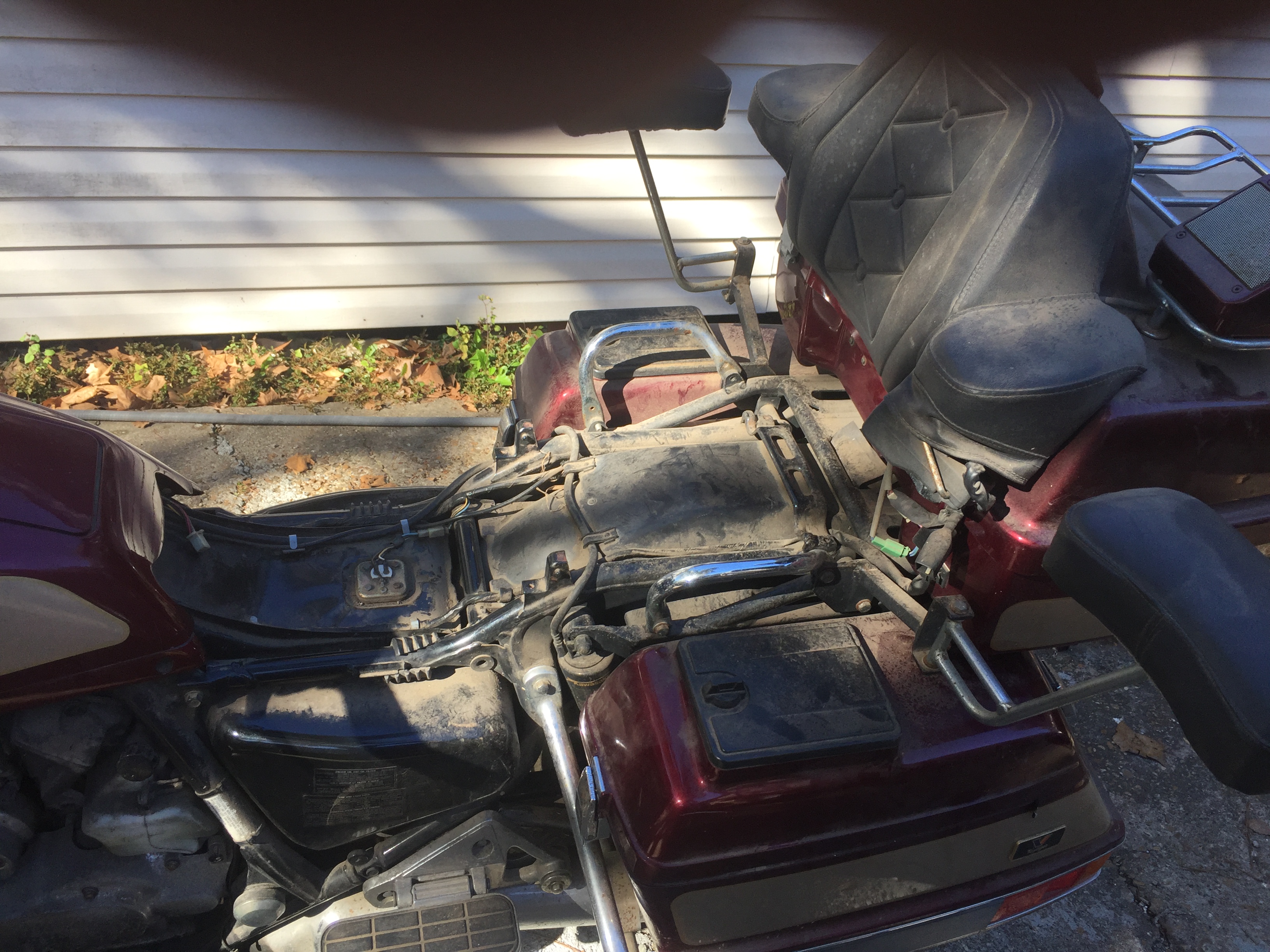

Well I got the carbs off. 2 hrs. A record for me.
Removed the top and bottom air box and the coolant reservoir first. You are right, getting the throttle cables off was a bear
. I might decide to remove the starter before I reinstall them but that wont be till after Christmas. The good news is I didn't resort to a barrage of four letter explelitives doing it!
