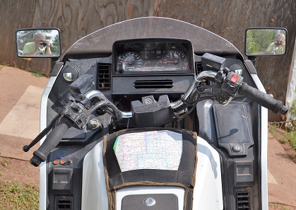

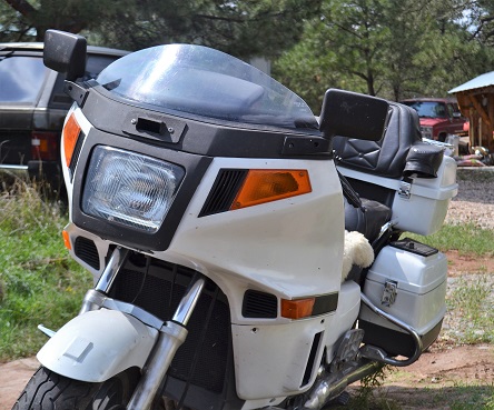

I've suspected that XII windshields are taller than really necessary. I cut mine down to put the top an inch or so below my line of sight. (I can't stand looking through these windshields.)
I wanted to try something even shorter but was afraid I'd have to buy a new windshield. So I tried it on Mr. Jensee's windshield instead. It has 8" of windshield showing above the molding. Looking over it, I can see the road about 12 feet in front of me.
I like it! At freeway speed, the slipstream hits about my nose but doesn't seem to push my helmet back. Less turbulence, helmet in cleaner air. If the visor is a click up, I get a little too much air; but it was like that with the taller windshield. At 50MPH, that works great (the draft on my face seems less turbulent). Back on the freeway, there's a pocket of dead air about 8" in front of my mouth -- above that is the slipstream, and toward me is a downdraft, apparently off the visor.
And that's the best part: a significant cooling draft down my chest. I might feel differently about it in cold weather. But maybe not -- my clothes could handle that.

After a little more riding, I like it more. With the full windshield (well, even that was cut down to 15" above the molding -- the edge was well below my line of vision), I had wind at my back. I mean, the airflow seemed to eddy over me, and the only breeze I actually felt was on my back ... with a lot of turbulence.
Now, the wave seems to be lower and maybe further forward -- my head might be right in the curl. At freeway speed, the wind doesn't push me back at all. Instead, there's a pretty strong current blowing down on my shoulders and chest. It gives my mesh jacket something to work with. And that breeze is much cleaner airflow.
The only downside, if it is one, is that I might have more turbulence at the base of my helmet. I don't think rain will be an issue because the air blows downward. (And I'd much rather look through just one wet piece of plastic than two.) I can't judge the noise because I changed my helmet at the same time I changed the windshield. At any rate, it doesn't look like I'll be going back.
I haven't checked with a passenger and have no idea what's going on back there. But I bet my bike is more streamlined!
