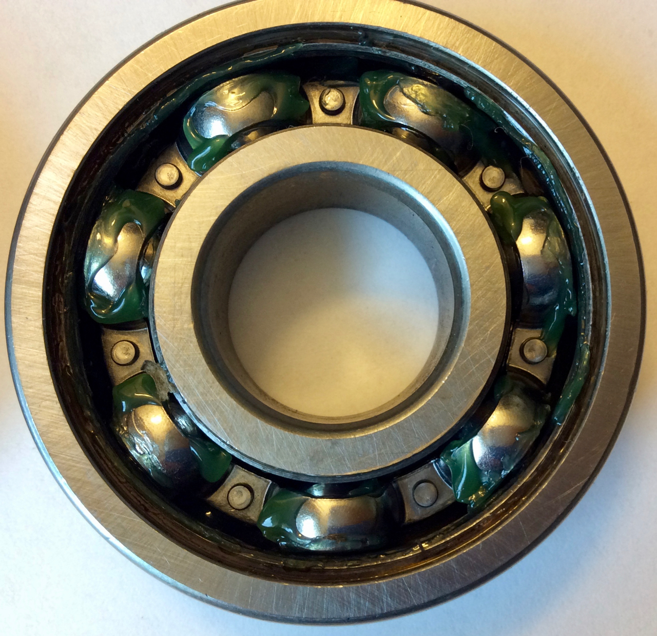

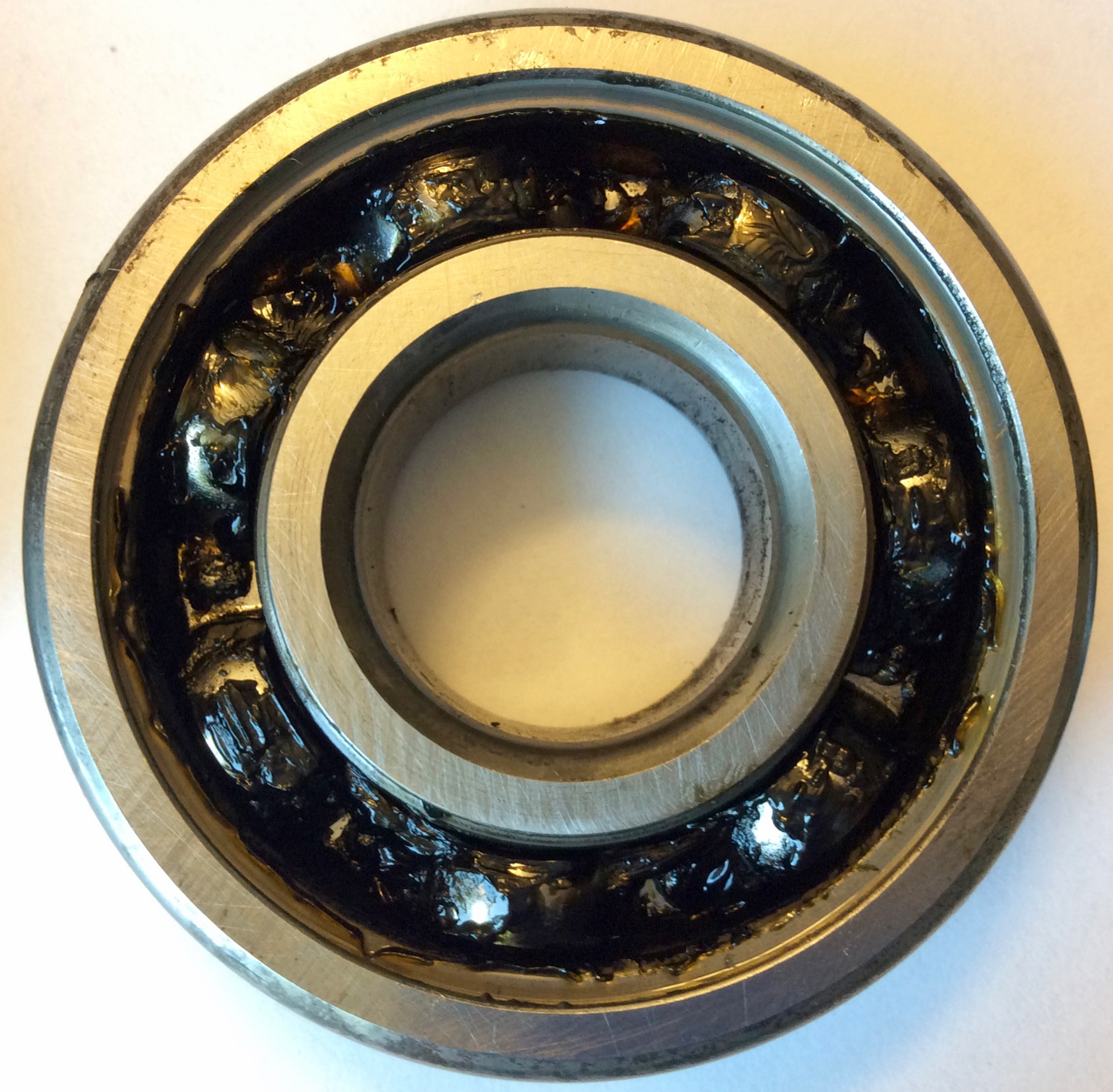

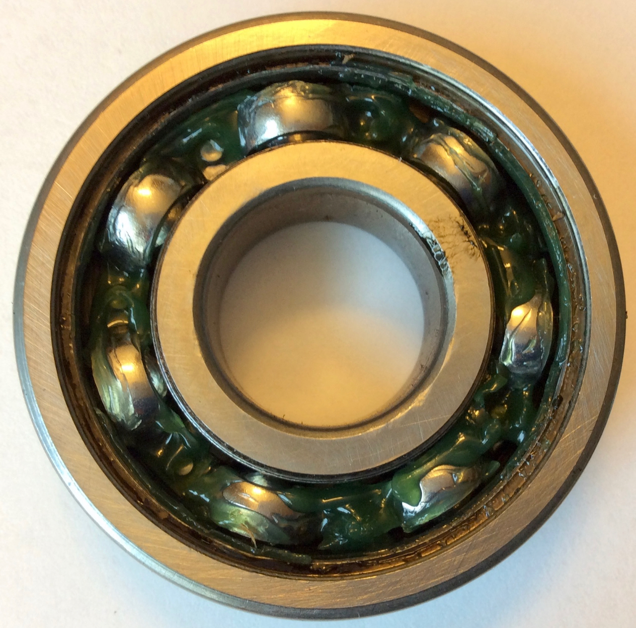

When the wrench took my rear wheel off, the inner race did not want to spin,
the new Kaw bearings were OK. I took the side of the All Balls and one of the
old Kaw bearings off for a look-see... Not much grease on one side of the All
Balls...
The first pic shows a dry side of the All Balls, the second pic is my old 75K
mile Kaw, and it looked the same on both sides, the third pic is the "wet?"
side of the All Balls... bearing grease was NOT abundant on the All Balls!!!

Yikes, this is the brand I just put in my rear wheel. I haven't reassembled the bike yet. So this is what you found after popping out the seals between races?

... picture of brand new All Balls, with @ 30miles on 'em... YMMV
They did NOT work for me! Ya might check around... my wrench
recommended the stock Kaw bearings...

... what little grease I saw, was on the ball cage and not the balls...
Mine were noisy right off.. glad I got 'um out! 'spensive little
venture, sigh.....
