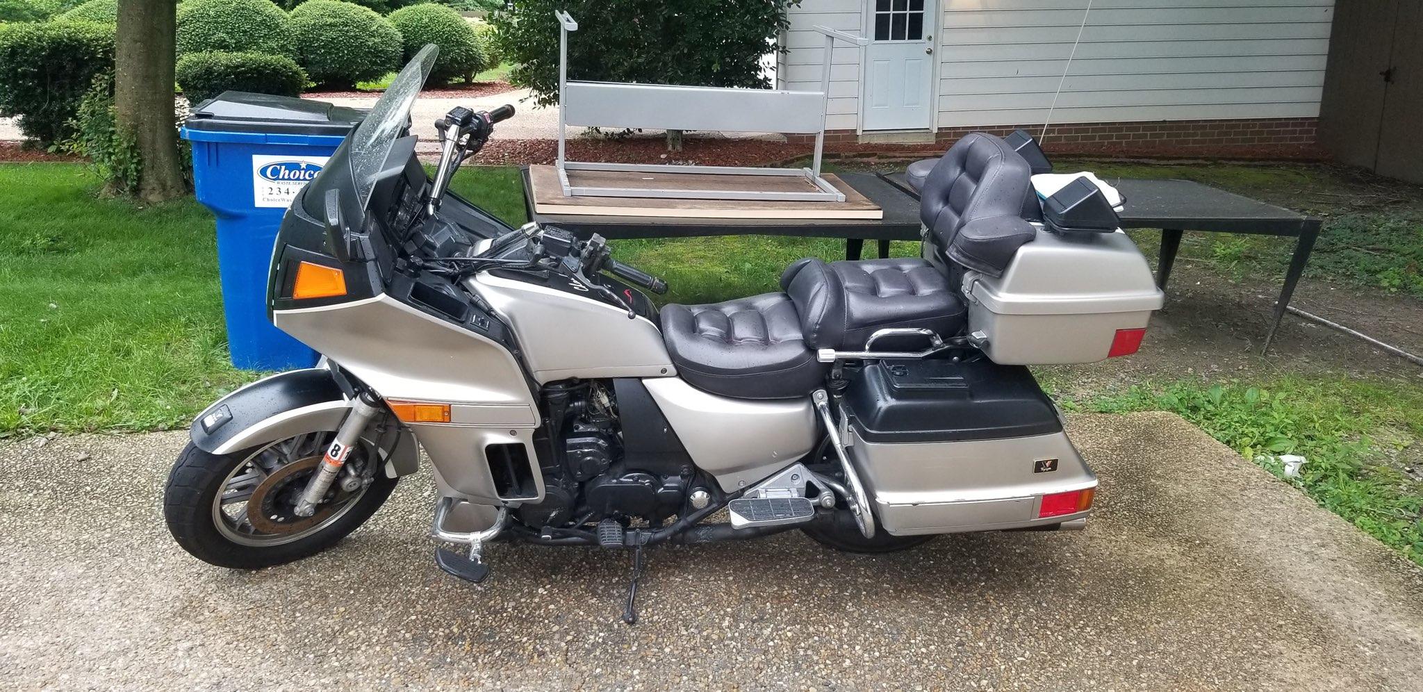

I am excited to be riding again and just bought a 1990 Voyager. I have a couple of questions though.
1 is there a fuel shut off valve.
2 can any recommend mufflers for the bike the last PO put straight pipes on it and it is way to loud. Or is it cheaper to go with used pipes.
3 there is no power what so ever to the radio I have read that there are 2 fuses at the back and on in the fuse box. Which one would be for the overall power.

Good looking machine by the way!
Re: New to Voyager questions
Is there any chance to recover the pipes the foolish PO removed from a nice looking machine.

No the PO. Doesn't have them anymore.
