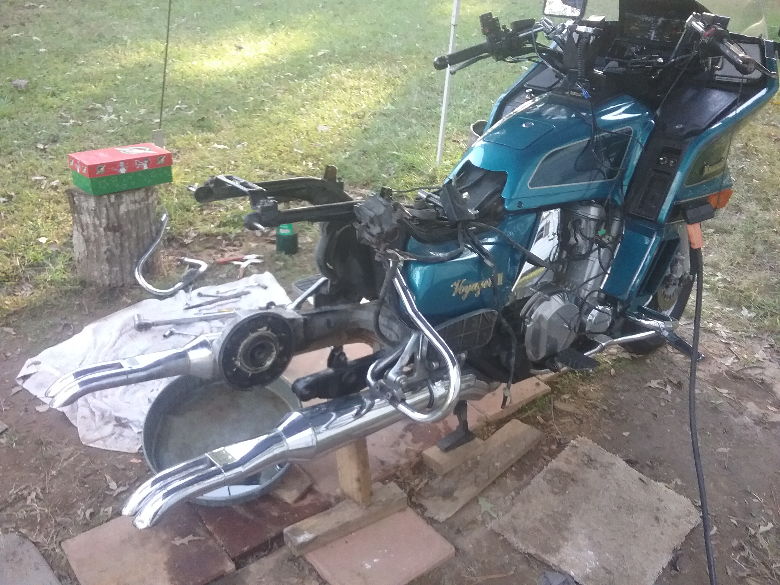

Being the type of owner that likes to know about the condition of my bike, I took the rear apart to grease, inspect, clean and replace anything that needs it.
So, not having a manual, I'll need some acquired knowledge help.
1) if I take off the final drive, will some more fluid come out? Springs , clips or any other surprises?
2) Where do we get new bearings from and do I need seals with the bearings?
3) Is there a gasket between the final drive and the shaft housing?

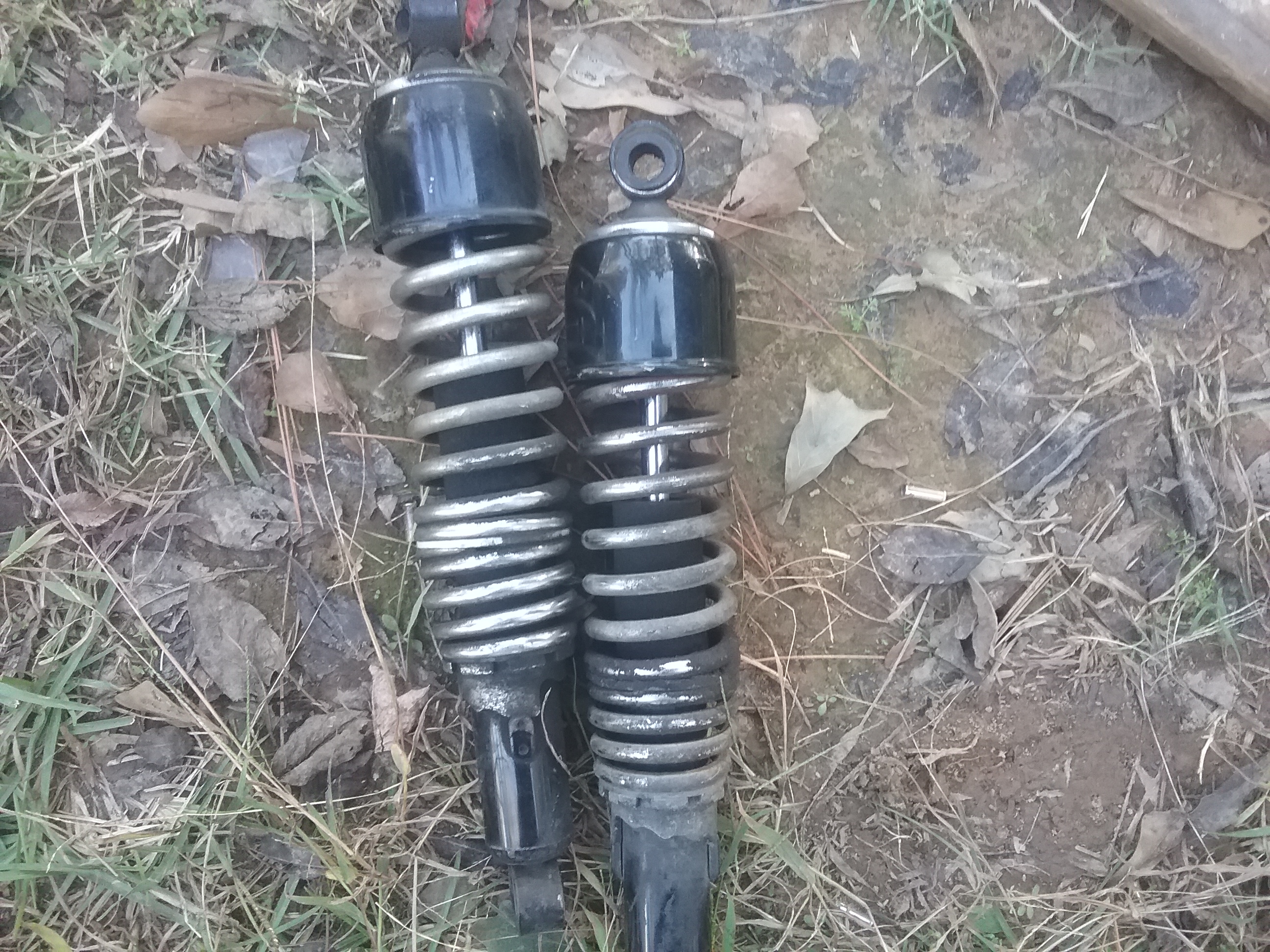

4) i am going to put Progressive 412 rear socks on but I see they come in different sizes. Does it matter which ones I use? I'd like the 13" not the 12.6" if it doesn't matter.
One more thing, if the shocks (rear) are to short, will it make using the centerstand a no go? I had to put the bike up on a block to get the centerstand to work.
One big reason I took it apart is a pretty loud whine when going down the road. No problems shifting, so I want to make sure everything I can do, is done. 60,000 miles on it.

Welcome ,itlives,you can find a breakdown of the parts on the internet using bikebandit or partzilla, which along with the local dealer,is where I get my parts.
Pulling the rear end can lose some gear oil,but you should probably change that out anyway.
Too short of a shock will make it hard to get up on the center stand.
Let us know how you are getting along,and ask more questions if you want,that is how I got to learn more about my bike. :thmup:

cushman eagle wrote: Mon Nov 04, 2019 1:31 am
The shock is an MDI 402C ...which I can't find on the internet. I believe I measured 13" center hole to center hole. I have found MDI 412 online and they're a lot less expensive than the Progressive.
I know you get what you pay for.... :roll:

Your doing this job outside in the weather ??? Hmm !!!

VoyKimmer wrote: Mon Nov 04, 2019 3:14 am Your doing this job outside in the weather ??? Hmm !!!
Yes, Louisiana is forgiving temperature wise. I just cover everything up when it rains. It is under a pop up.
