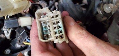

Hey guys. My first post. I bought a voyager not long ago. It's a 1995 with 30,200 miles. The previous owner was a really shitty person, lied to me about the bike and how long its been sitting. So I started down this road of getting this thing going again. Ive been into bikes for a long time and im really good with fixing things. I was told the bike had no power when you turn the key and it was ridden last year and just sat since the spring of 2020. Well that was a lie.
This thing has been sitting yearssss. I might need some help with things from bike specific knowledgeable people. I would upload pics but im not sure how to on this forum.
I found the power issue. It was the main wire coming from the fuse box into the main wire harness. Repaired that. There has been a handful of other electrical issues i found and fixed. The oil looked like a chocolate milkshake when i drained it. Hope that flushes out and its ok. Both master cylinders don't have any resistance in them when brakes applied. Tires are bald. Had the original spark plugs in it, that were all rusty. I wasn't sure i was going to get them out. I have drained the coolant, final drive oil, brake fluid... I will be changing all the fluids. A lot of fasteners missing/ messed up. I have the rear sub frame off with the gas tank removed. Took the air box out, air box catch can, coolant overflow bottle. Took the carbs off cleaned them out installed a new rebuild kit and reassembled and reinstalled. I got it fired up, but a few of the cylinders weren't firing. Once the new spark plugs arrive I can rule out the spark issue. Fuel getting into the cylinder might be the problem. All the carb bowls had gas in them. I know this seems a bit all over the place, but that's how this bike has been so far. I didn't pay much for the bike and was looking for a winter project so it should keep me busy. Once i figure out the picture issue i have a lot of photos i can post. Like i said, i may need a word of advice here and there.

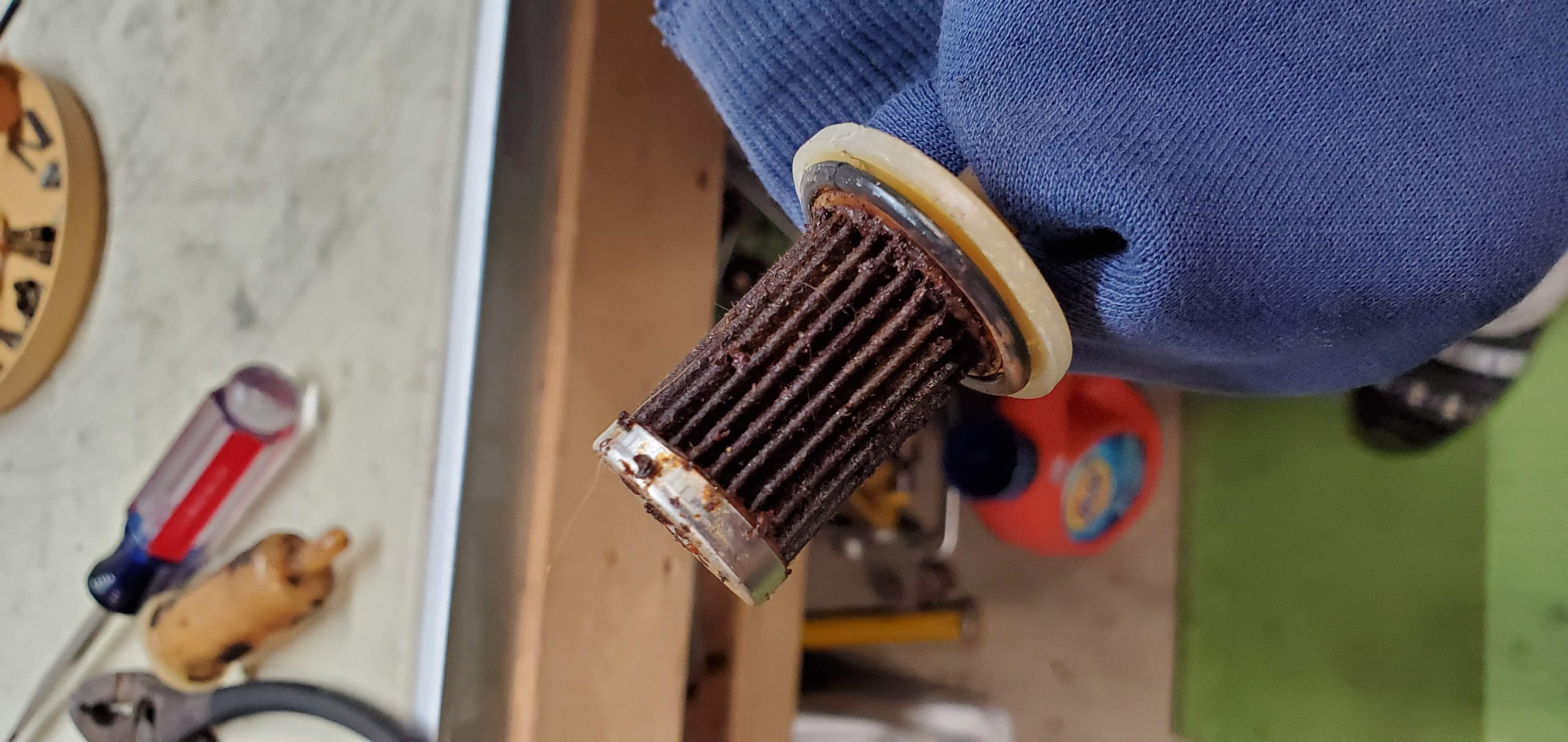

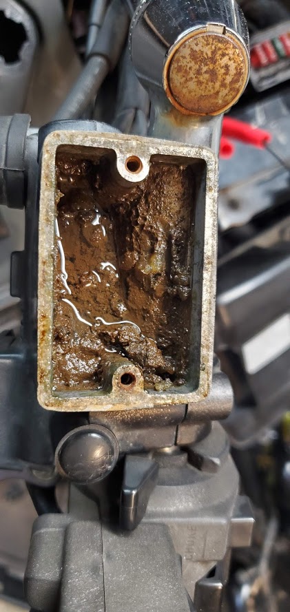

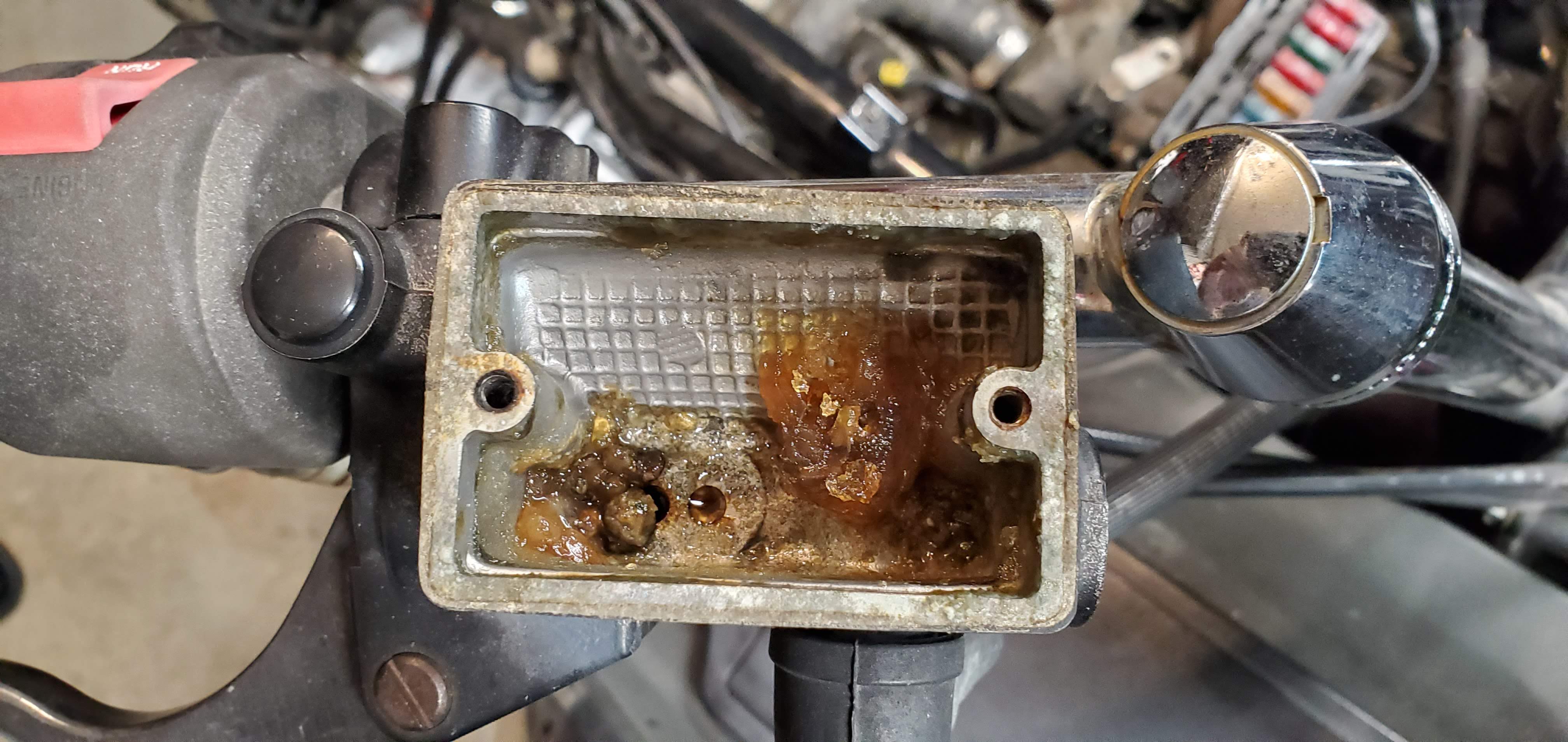

I'm attaching a picture of what the front master cylinder looked like. I have never seen this before. Crazy.
The new spark plugs and rear brake parts showed up last night. I got the brakes on and bled. 3 out of 4 plugs in. I'll also attach a picture of what the old plugs looked like.

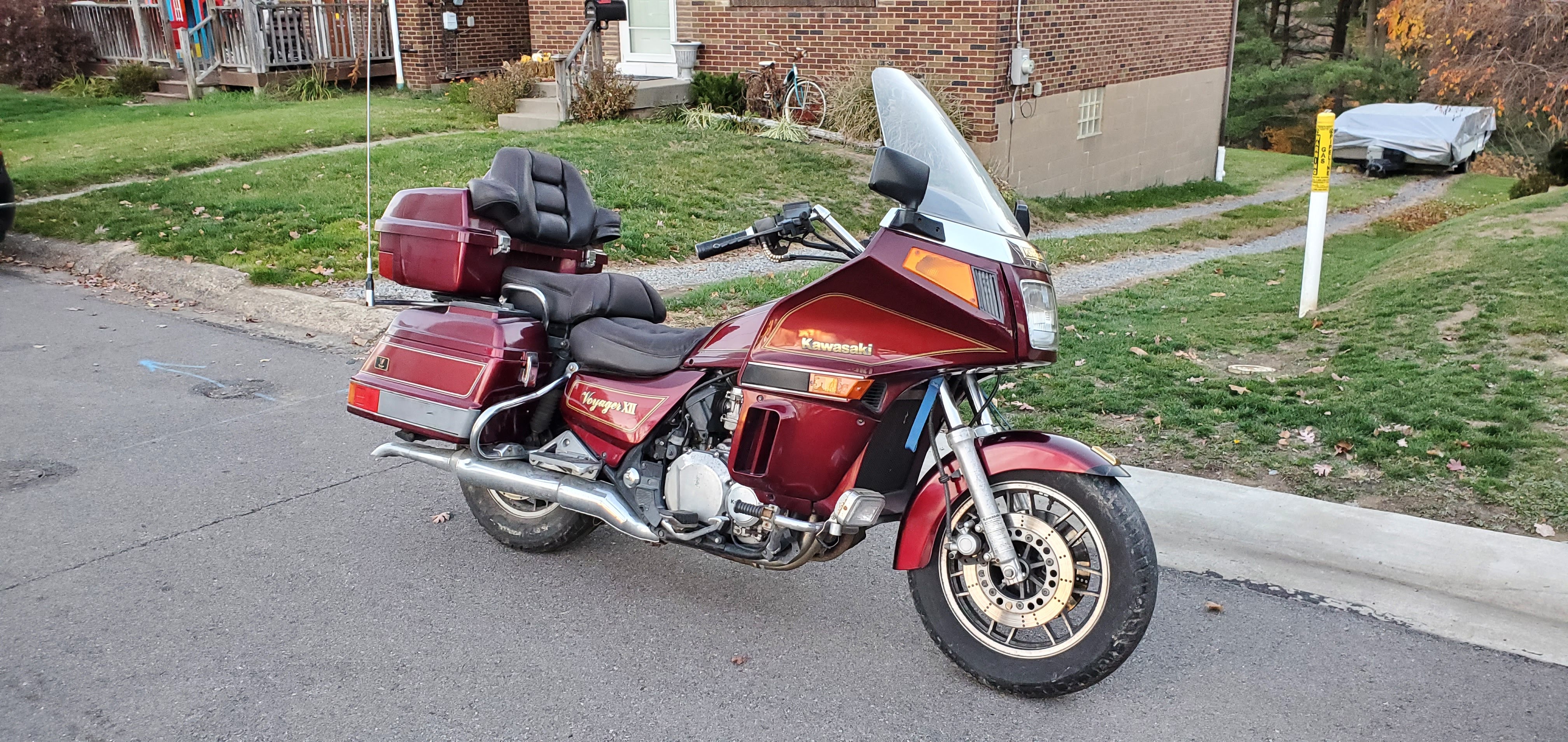

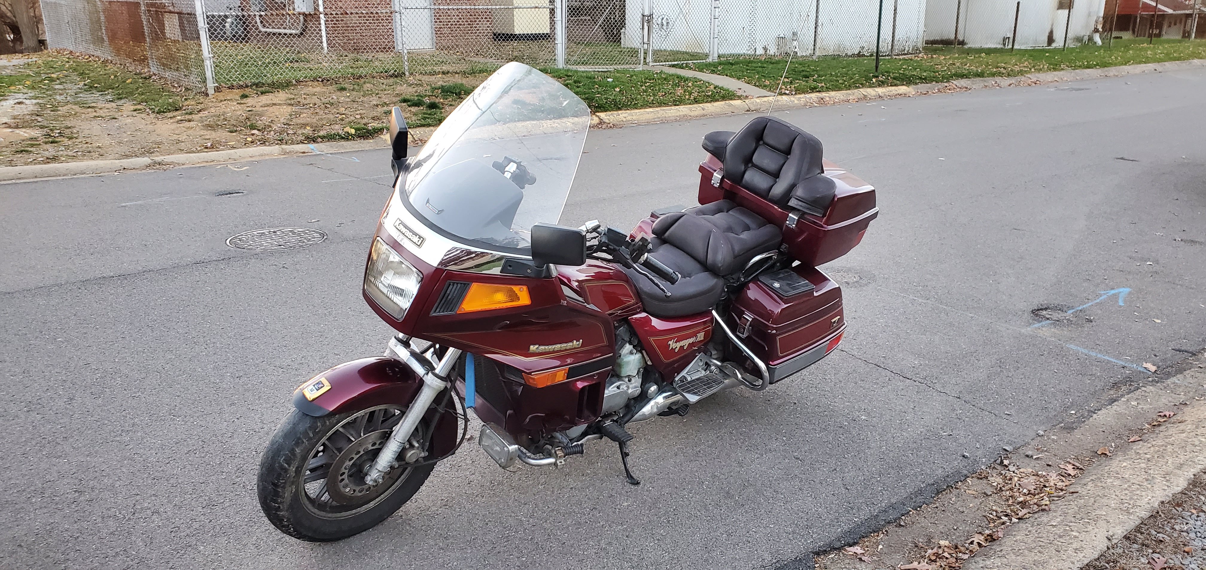

Welcome to the world of Voyager XIIs.
I see your post is titled "1995 Revival" and perhaps the bike you bought is in fact a 1995 year of manufacture, but it is wearing 1986 coloured plastic and it doesn't have the lower cowling, air scoop I call it, which the 87 and later models have.
Also I see the downturn muffler tips which I know were 1987 and later style. I thought the 1986 mufflers were all straight single round tipped similar to the 1300 six cylinder mufflers. I have seen one other 1986 with the straight tips and that owner is a chap just down the road in the next community and when I spoke with him he said the downturn tips were the original mufflers for his bike so perhaps some of the later serial numbered 1986 units got the updated style of muffler tips.

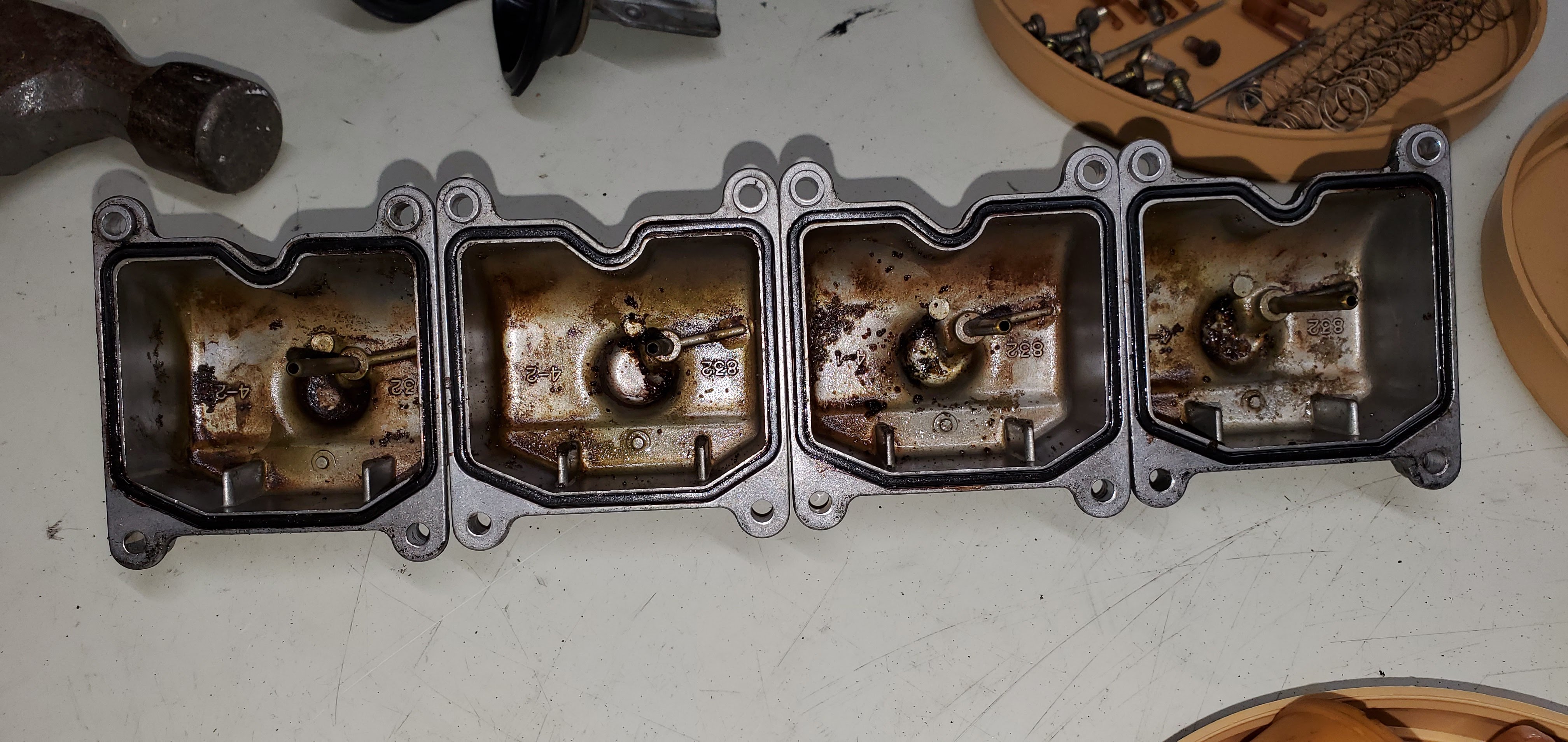

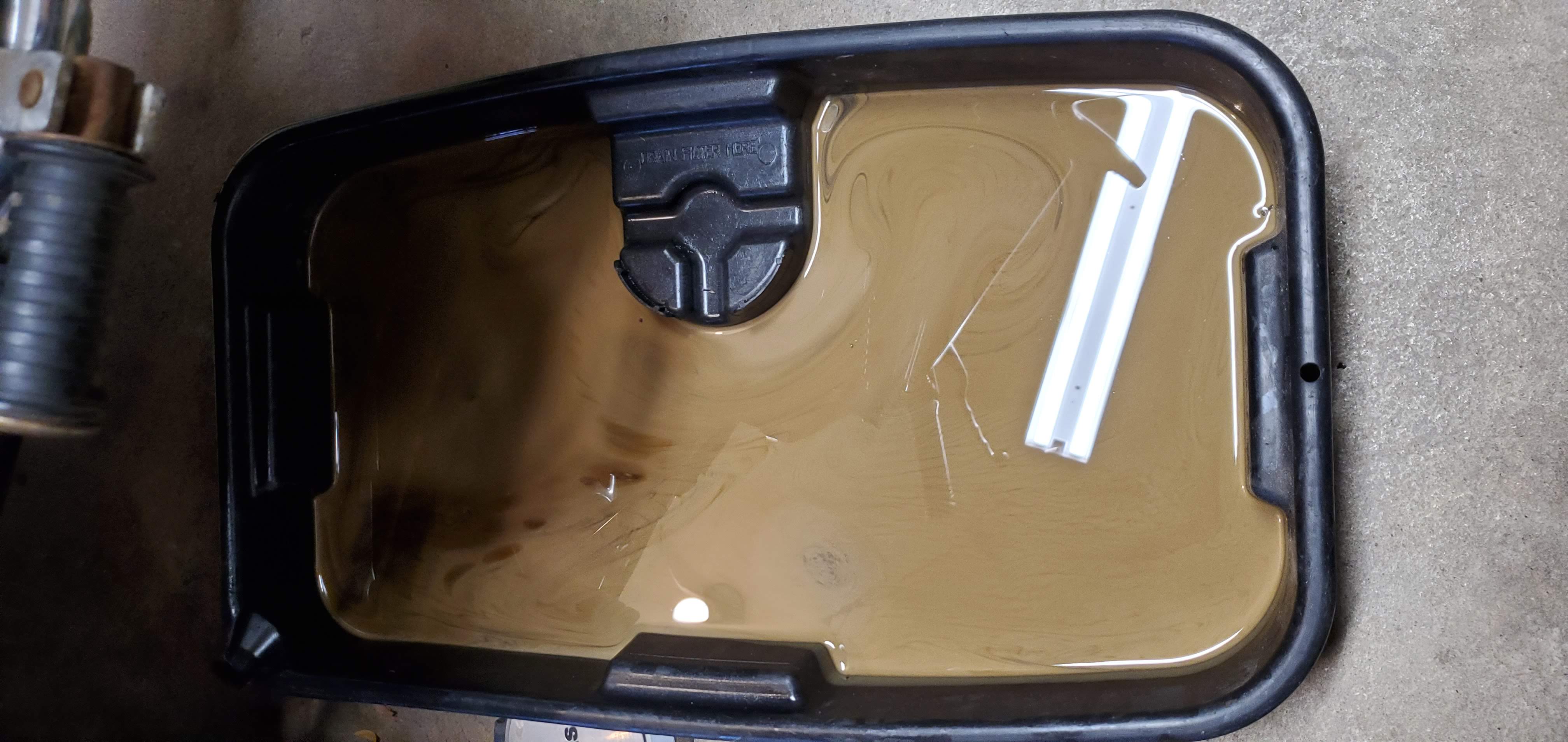

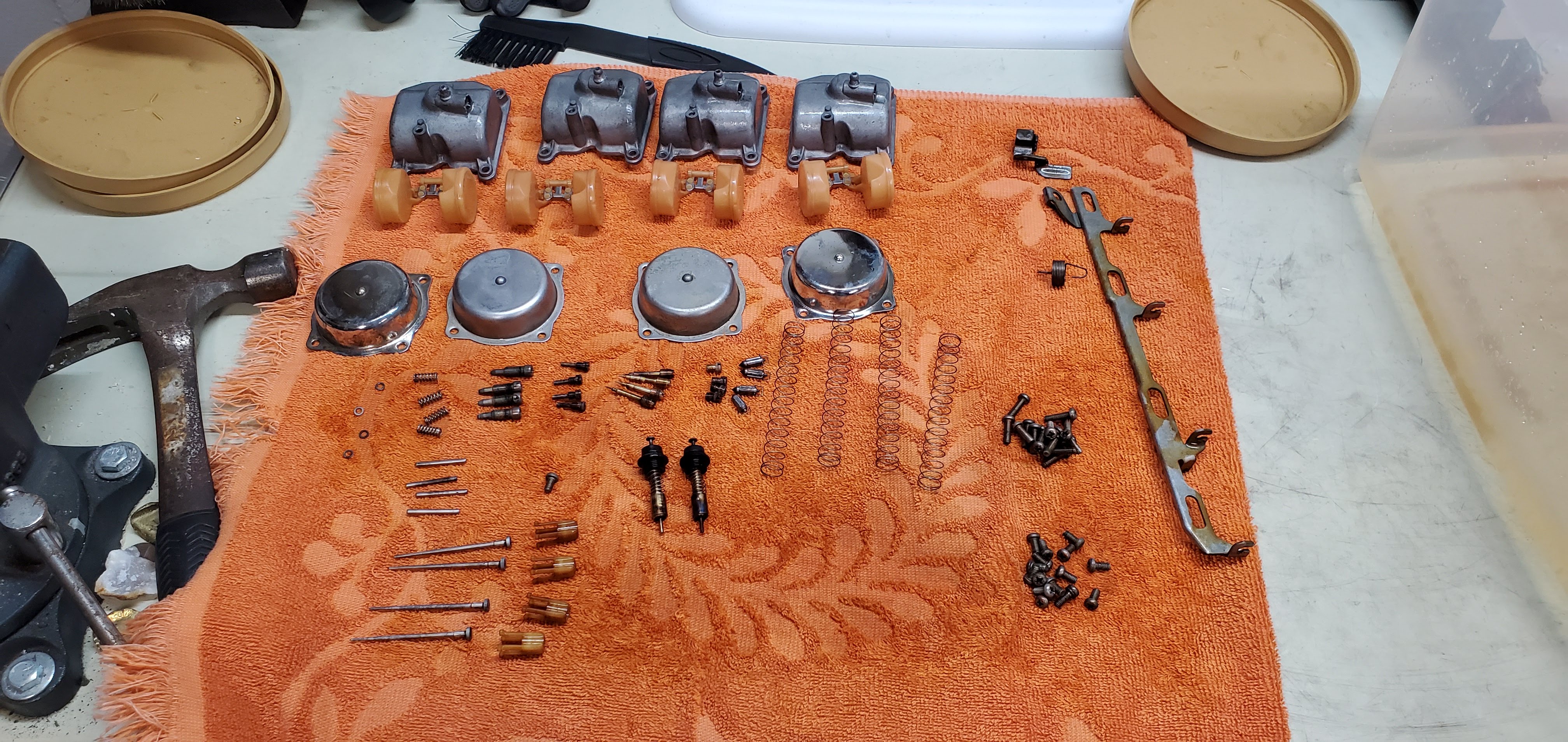

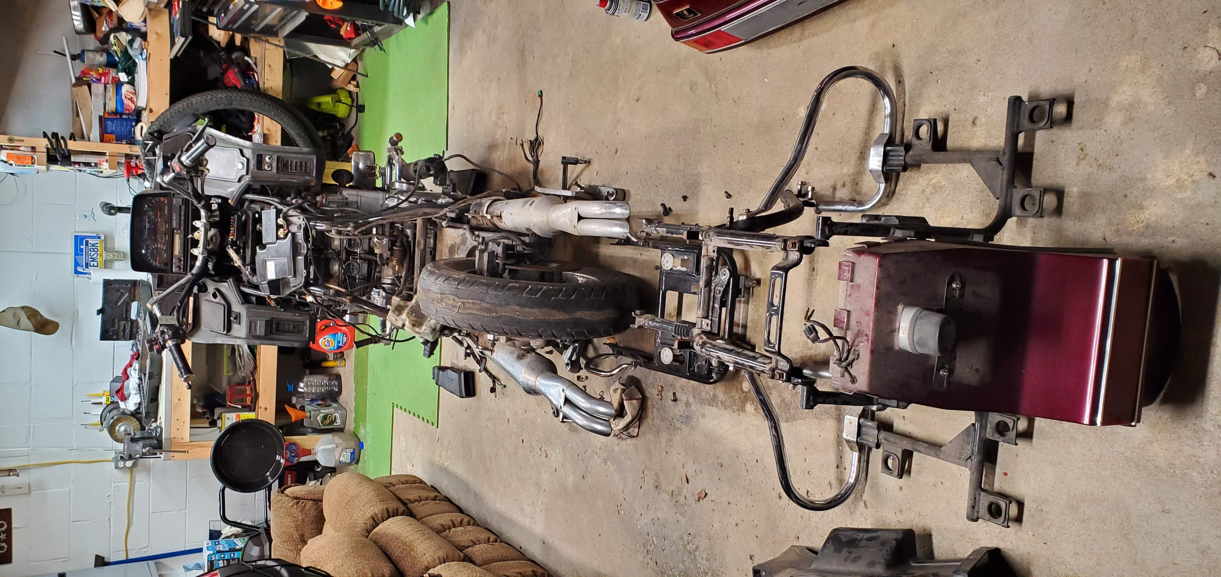

Ill just post some of my in progress pics.

I think I read you've already taken the rear subframe off, so you won't get surprised by missing frame bolts there, at least. Like you, I also bought my bike cheaply and it's been an adventure discovering DSPO stuff - like missing subframe bolts, or even worse incorrect subframe bolts that later fell out. Ah, the joys of old bike ownership! But, let me tell you, it has been such a pleasure steadily improving the bike and riding her the whole time. Gertrude (the bike) and I go everywhere together. Matter of fact, it's just above freezing here, and I'm off for a ride. Welcome to the group!

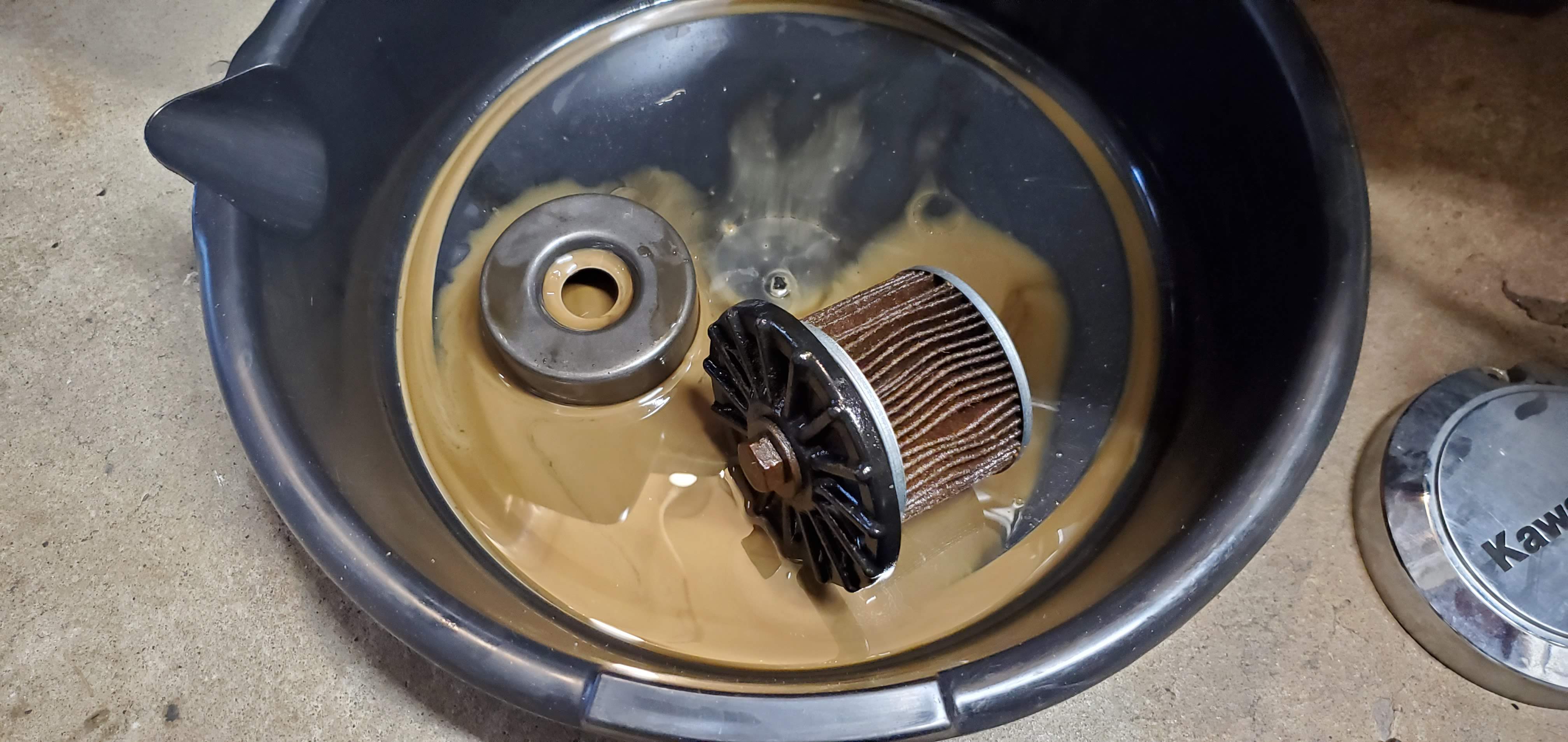

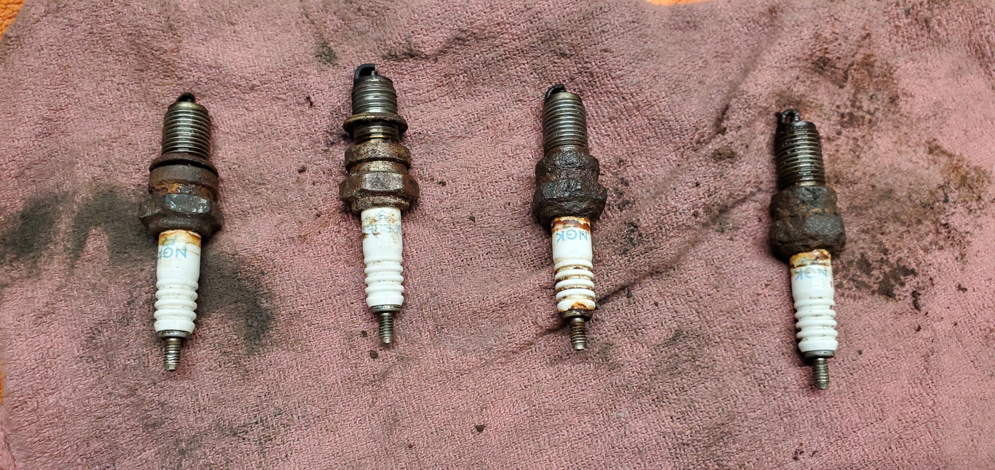

I just noticed that your first plug photo shows a cracked ceramic. Don't know how common this is, but I also had that. Even after replacing everything, it still had an odd miss at low RPM on that cylinder. Swapped wires and coils, chased carb adjustments, nothing fixed it. What finally worked was filling the cylinder with SeaFoam and letting that drain into the crankcase.
I think these motors are prone to stuck rings. Given how crappy yours looks, I want to suggest doing this on all four cylinders, as a prophylactic if nothing else. I'd let the straight SeaFoam work on the crankcase, too. Then I'd put cheap sacrificial oil in for the first few miles.
You might even consider dropping the oil pan and cleaning it right. I bet the gasket leaks anyway. I also replaced the dozen or so o-rings in there.

Seafoam works fast, in the crankcase. I put mine on the centerstand, idled for five minutes, shifting through all gears, waiting for the oil to reach 180 F, so it would suspend the crud so it reached the filter. On my Honda, the oil went from caramel, to black! I changed it, and the filter, immediately. Repeated the process 3,000 hard miles later, but even after 300 miles, the oil never darkened. The sludge was all gone from the first treatment.
Modern oils (API SJ and newer) are so high in detergents, you will not need to treat the crankcase with SeaFoam again. I treated my Voyager crankcase, once. I use it in the fuel tank, once a month in the Summer, then when I mothball it. SeaFoam is a great product. Cheers!

Its like everything i look at is just ridiculously bad. How does a clutch master cylinder get like this? Anyway i got it cleaned out and flushed. Ill just plan on flushing it after i use the bike for a little while, and then again later until its clean. I drained the oil only idling for about an hour. I wanted to see what it looked like. Looks good, got some of the contaminates out. Ill post pics of the oil i drained out when i got the bike. I'm pretty sure the bike sat partially disassembled outside. I think rain got in the airbox then went down into the lower airbox and right into the crankcase vent. The air box drain catch can was completely full of water. So this first little bit was to flush out any of what was left. The oil i just put in will be in there a little bit more. Now the bike fires right up, idles well, cooling fan comes on. I will do a radiator flush next.

The spark plug wells have a drain passage which probably is plugged looking at the plugs. This passage goes down on an angle to the little jogs on the cylinder head/cylinder joint directly behind the carbs. It can be cleaned, when the plugs are installed, using a piece of copper/metal wire inserted at an angle from the bottom up. Once the wire runs freely you can air blast the residue out of the plug well.

I wish i would have known about those spark plug well drains while the carbs were off. That would have been much easier to clean them out. Im sure i can still get them clear though. I do have a large order placed for many misc. pieces that i am missing from ronayers.com OEM part supplier.

For the SeaFoam crankcase flush, follow the directions on the can: I believe it is 1-1/2 oz. per quart of oil. I put my bikes on the center stand, idled them, shifting through all gears, letting the rear wheel spin freely. I ran them for five minutes, which is long enough to let the oil reach 180 F, which is the minimum temperature at which they will suspend crud, to be caught by the filter. The oil will change from caramel color, to black, if the engine/transmission has carbon deposits in it: the Honda (API SF/SG -- it changed to SG around 1979/80), and the 440 (API SH?), did, while the Voyager (API SJ?) never darkened noticeably. I installed an oil cooler in the Honda, along with an Oil Temperature Gauge: Honda engineers ran that air-cooled engine at 250 F, which is the thermal breakdown temperature of API SG oils (the oil cooler dropped it to 210 F, two up, heavy load, highway speeds, and 90 F air temperature!). It had plenty of carbon deposits from its early life. The 440's early oils were not much higher in breakdown temperatures. The API SJ+ oils have a much higher thermal breakdown temperature (300+ F). More modern oils also have much higher detergent levels. One SeaFoam crankcase flush should be all that the bike will need, as long as you run modern API oils through it (SL+).
On my Honda, the OEM coils were weak. I installed NGK Iridium plugs, at $10 each, instead of modern upgrade coils ($250+). The bike started MUCH easier. I installed Iridium plugs in my Voyager just so I could have piece of mind: they rarely will fail to fire, so I get better mileage, and fewer emissions; they also make the ignition system stronger, more bullet-proof, so I have more piece of mind riding a 27 year old bike. Besides that, they will last 100,000 miles in a car, so I expect that I will die, before they do. Cheers!
