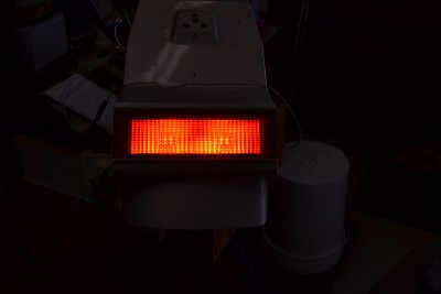

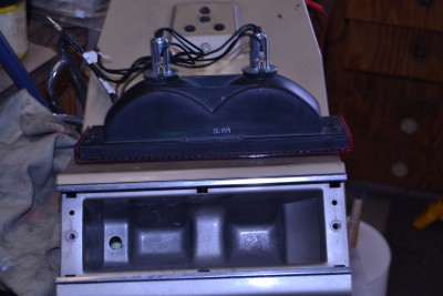

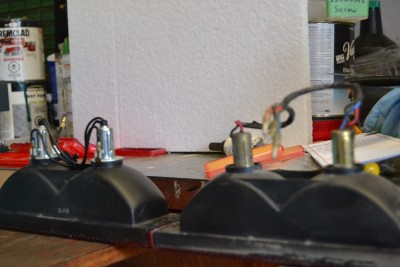

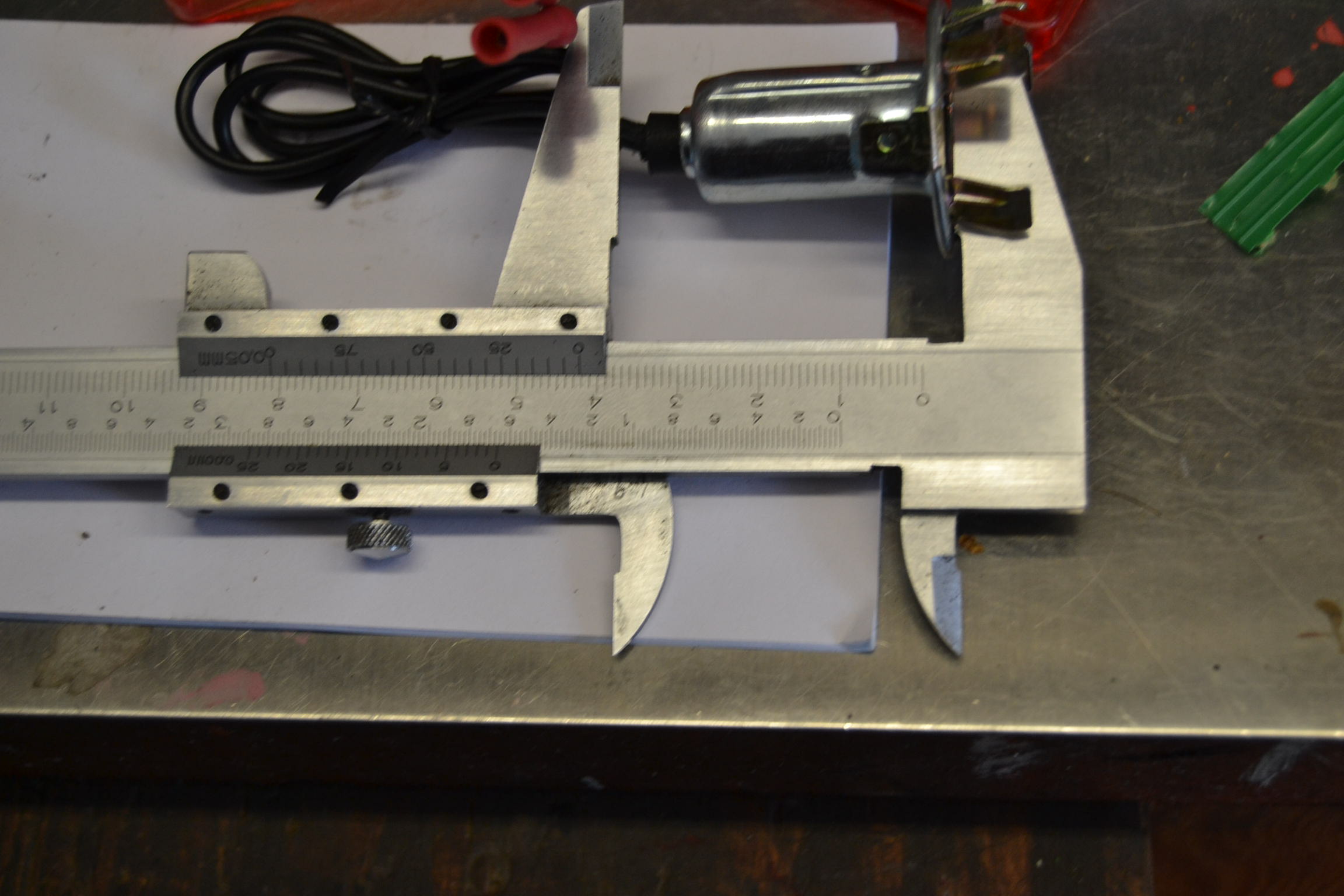

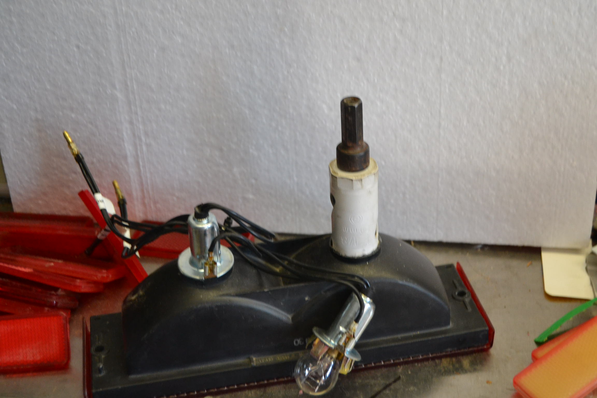

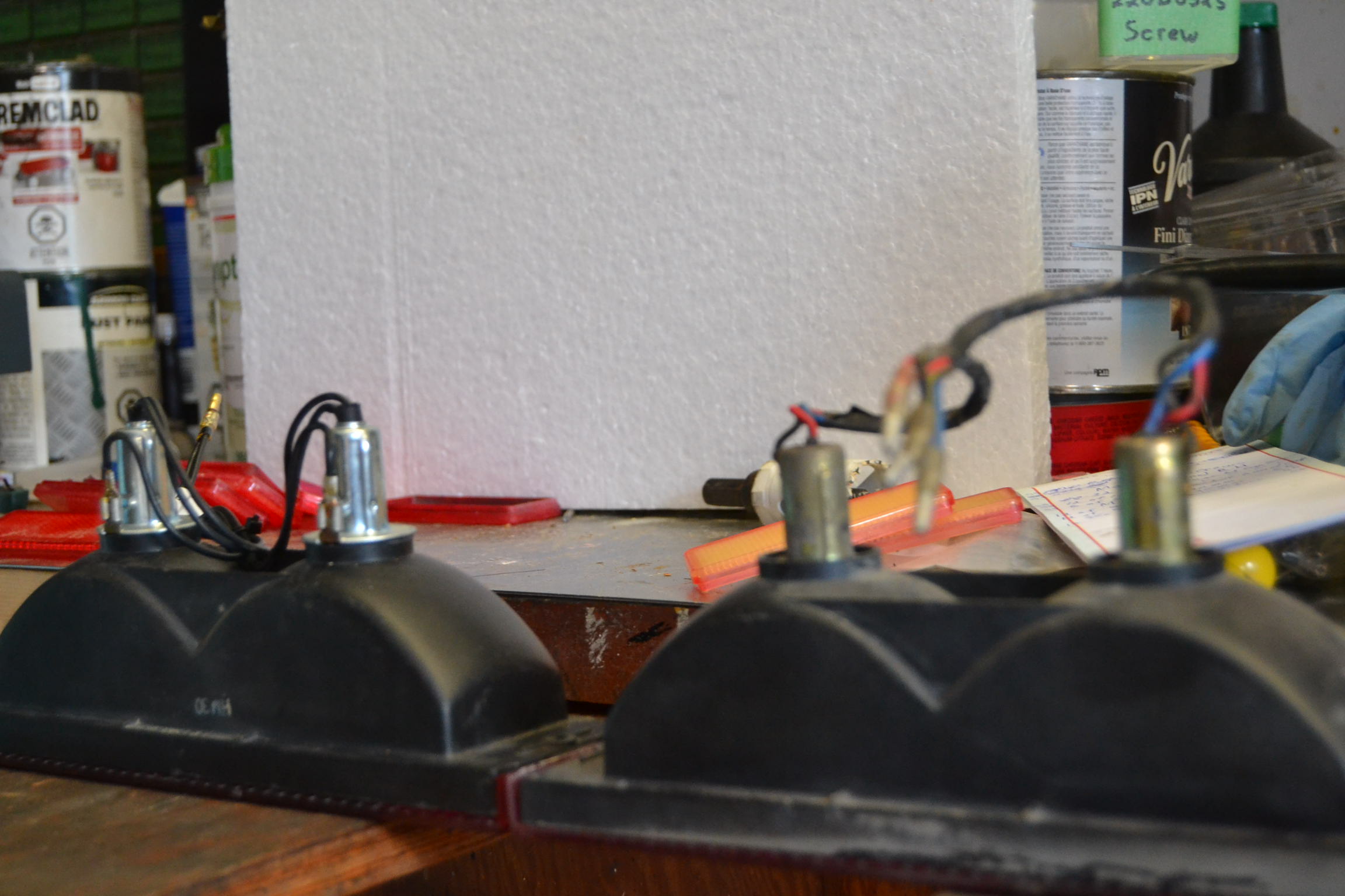

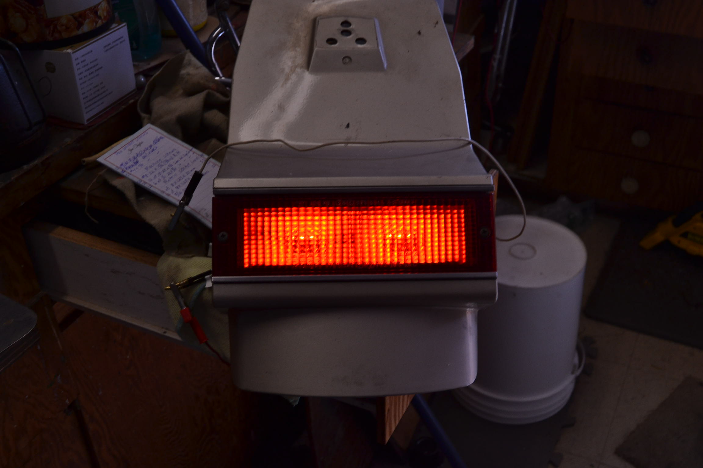

Nails I am not sure of the length of the bulb sockets you are using but mine work fine with a socket length, to the top of a wire bend, of 1.660", not including the snap in tabs. The photos here are your typical NAPA general item socket.
I also have used a Dorman 2 wire with ground tab socket part # 85860 and it is even shorter than the ones I used here measuring at 1.5" overall.
The first 4 photos are pretty self explanatory: 1) measurement; 2) tail light lit; 3) brake light lit and 4) the standard cavity showing no mods on my part.
The 5th photo is a comparison of mine on the left against an OEM on the right and the 6th photo is how and where I use the hole saw to permit the sockets to fit in. I was incorrect in my previous post as this particular bulb socket requires a 1-1/8" hole saw, but I'm sure you get the picture, no pun intended.
One item of note: be sure the RH bulb wire leads have lots of slack as they tend to fetch up on the hump in the cavity and pull on the socket body causing an intermittent operation.
FWIW,
EDIT: check bulb socket throat size as it may require a different size of hole saw than the size I used for my install
FWIW,
