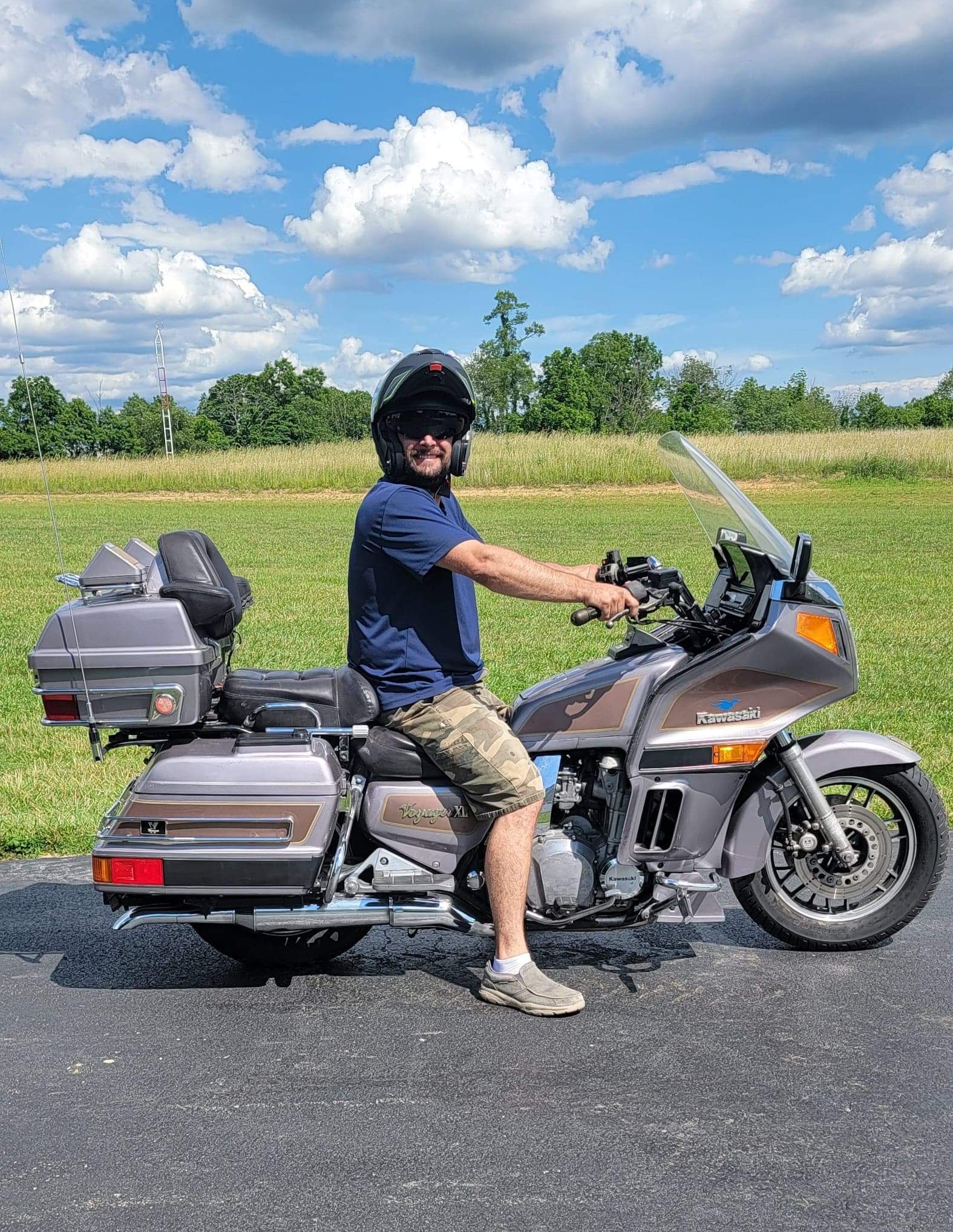

Hello all! Years ago I owned a 1989, and I regretted selling it every day! Today I found a 1991 Voyager locally and was able to pick it up! It has the same issue as my 1989, it leaks oil out of the water pump weep hole. Does anyone have a good source for the seals, o-rings needed?
