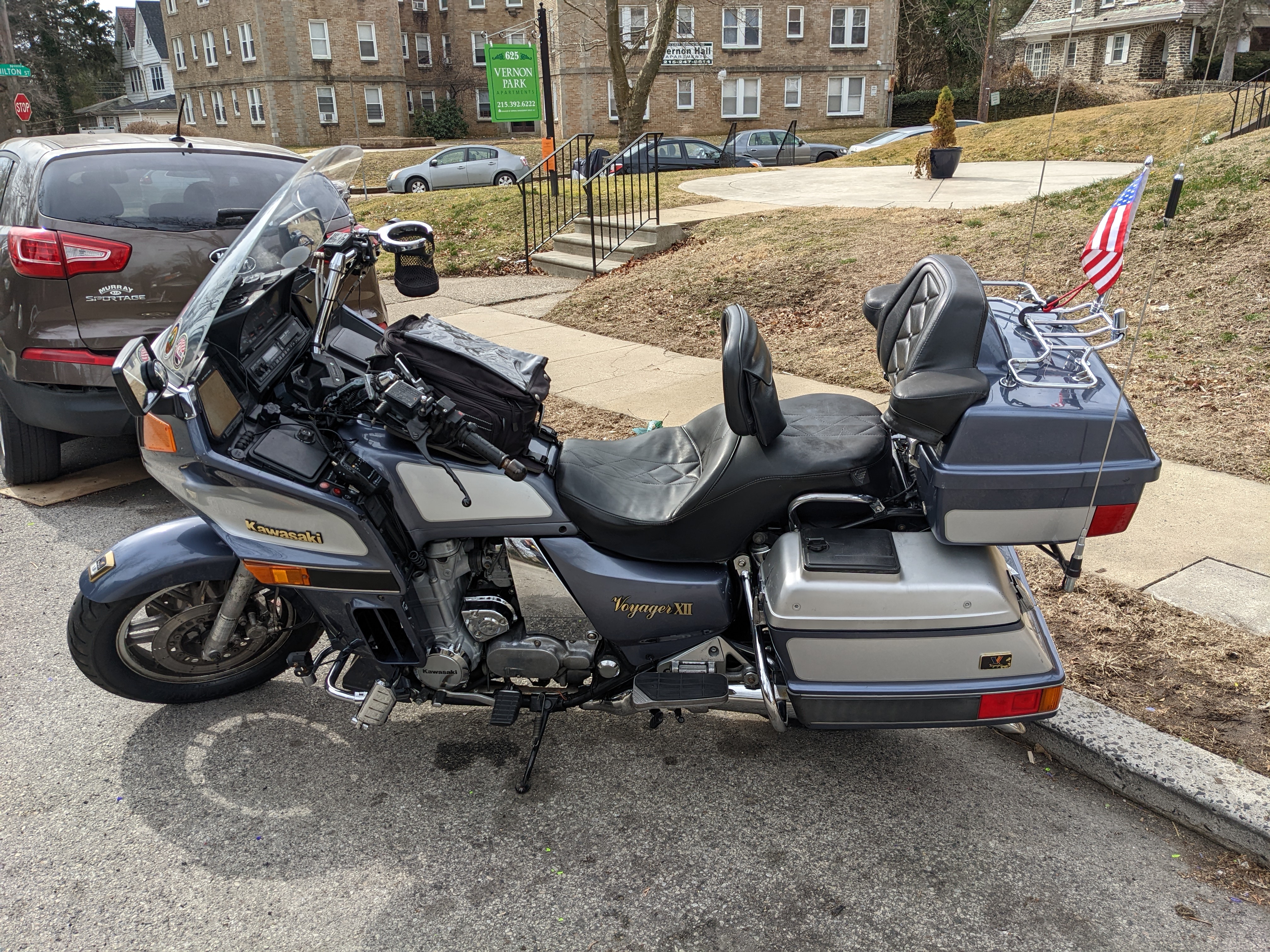

I removed the cruise control switch off the tank, filling the holes with black ABS cement. At the connector I jumpered the red wire, brown wire and black/white tracer wire together - I used the connector end from the switches. I *LOVE* not having to fiddle with the switch on the tank anymore - cruise is just there using the buttons on the right handlebar. Cool stuff, many thanks to the person who'd posted how to do it.
Now I have a real genuine tank bag.
