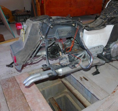

I do plan to put a bike lift in -- the (still unfinished) shop slab has a recess for it. But for the crack, I'm using a pit that I built more than 15 years ago. Instead of putting the bike higher, I just put me lower. (Easy to get the back tire out from under the bike.)

I've left the bike for days with the front wheel off, using a small scissor lift under that big fin in the front of the motor like Sarg said.
