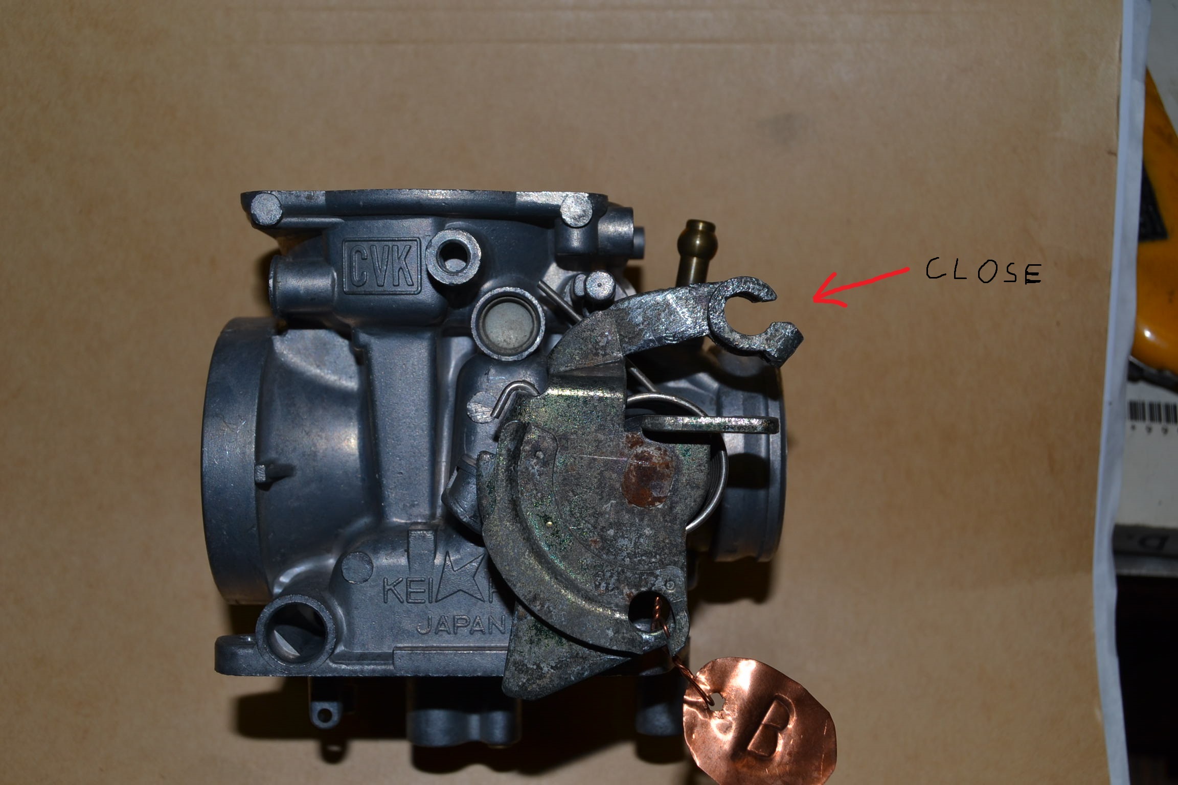

Here is the throttle mechanism from a set of carbs I am rehabilitating.
The copper tag is attached to where the nipple of the opening cable would be inserted.
The RED arrow points to where the nipple of the close/return cable would be inserted.
