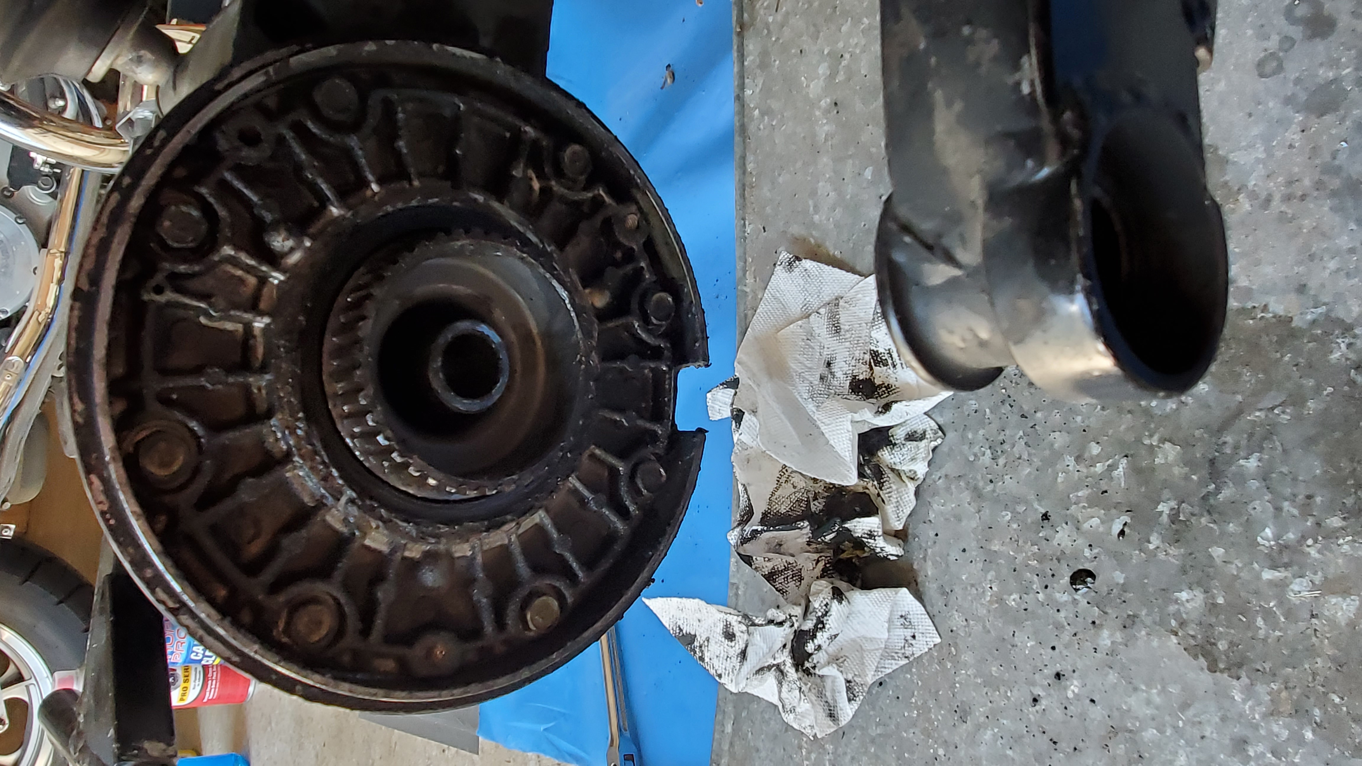

Ok, with my wheel off this thing is greasy dirty, big time. It's difficult to see from this specific picture but there are eight bolts visible. However, there are eleven threaded bolt holes visible. The one at 4 to 5 o'clock and the one at 9 o'clock seem to have a broken off bolt in each hole. The one at 2 o'clock is empty.
I have no plans on dis-assembling it, aside from removing it from the swing arm, but I'm wondering how critical it is with the open bolt hole. I plan to find a bolt to fill it. The factory vent hole is fine.
Please click on the pic for the picture to orient itself correctly.

I can't make much out from this photo. The manual has pretty good info about this maintenance. I posted about doing it just this spring -- https://www.amervoyassoc.org/forum/view ... hp?t=12907. I took some photos of mine, but not sure they show what you seem to be asking.

The last picture in your posting (VERY clean drive assembly, by the way) does show the "2 o'clock" empty bolt hole as mine has. So, I deduce that this is a normal condition.
I was going to pull the thing off today but tomorrow will have better weather, so I'll spray the absolute snot out of it to clean it.

Please read the manual. It has an entire chapter dedicated to the final drive. In Chapter 10, you'll see that these holes are to jack the final drive apart. I didn't go there ... thank god.
