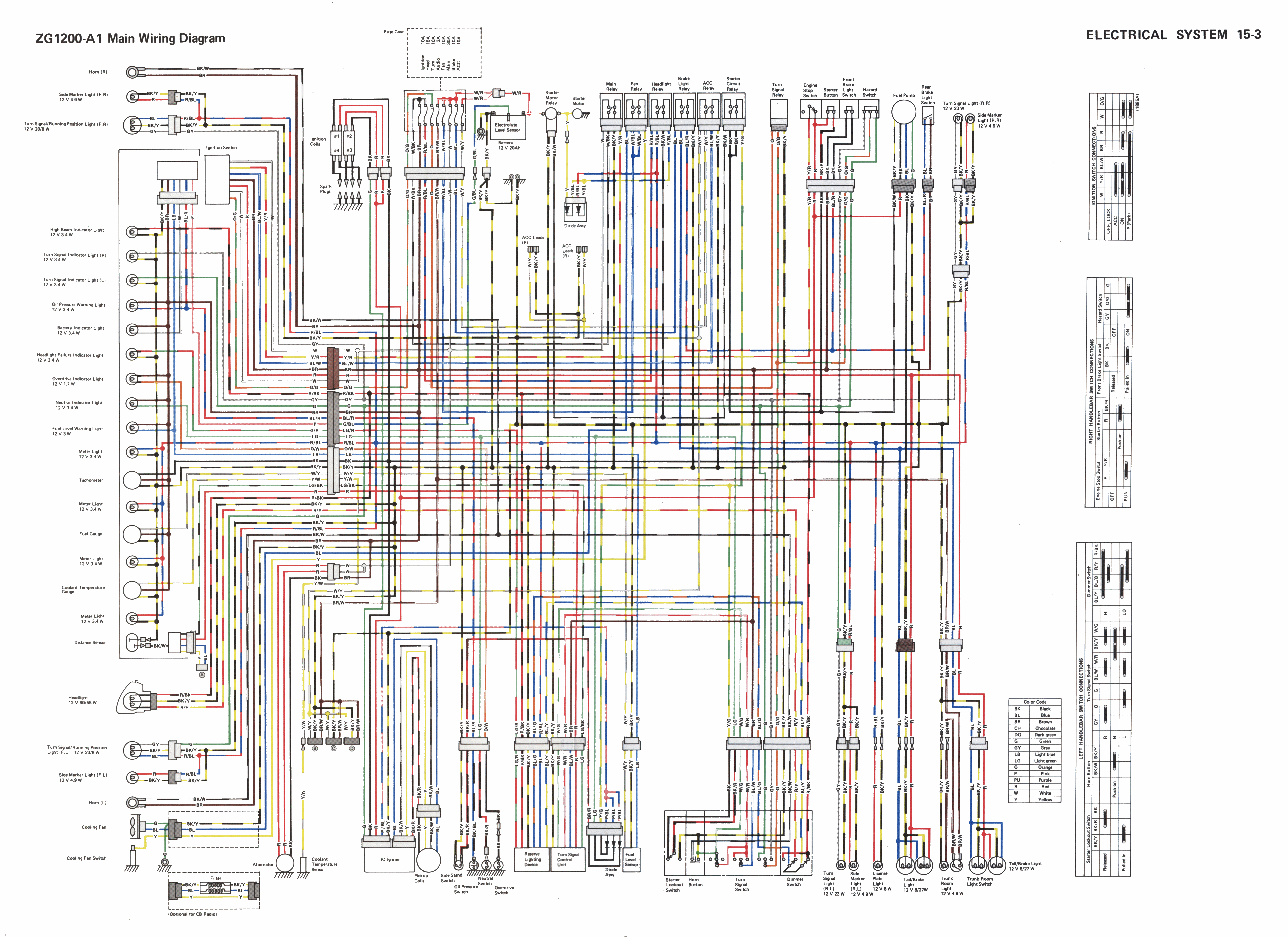

Allen, If you can read electrical diagrams, here's the wiring diagram for the XII:
http://www.amervoyassoc.org/Documents/m ... trical.gif
Ron in Oregon

debron
Posts: 1087
Joined: Mon Aug 23, 2010 5:54 pm
Re: lites on trunk will not work
Post by debron »
Right click on the link and choose "save as......" (or some such, depending on the browser you use.) It's a standard GIF image that you can open in any image viewer. or go to the AVA Homepage\ AVA Tech Center\ Voyager XII\ Manuals and Wiring diagrams.
