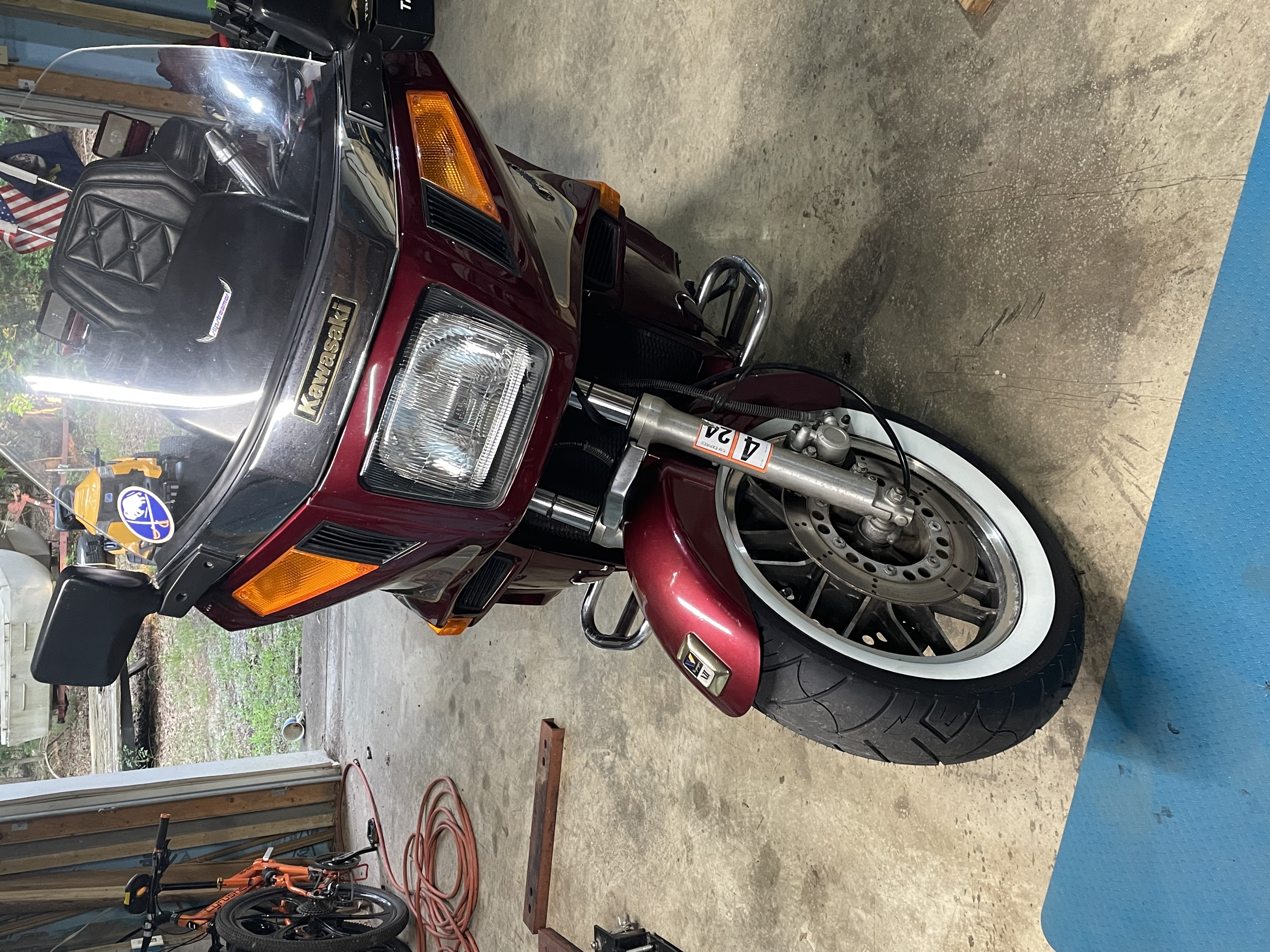

I got Shinko White walls. They look great and handle way better that the year old Dunlop 404’s that were on it. What a friggin difference.

Thanks, @GranpaDenny The bike feels fine and even better after the new tire in front. I will swap the back out soon.
I actually put Progrssives in the back as the stock shocks were leaking when I got the bike. That was the first thing I did. I have them dialed in to MAX and I have the front at 8.5 psi now. After my first test run with the new front tire, it handles so much better. Obviously is was in dire need of a fresh tire. I had a 10-year-old Dunlop 404 on the front until today.

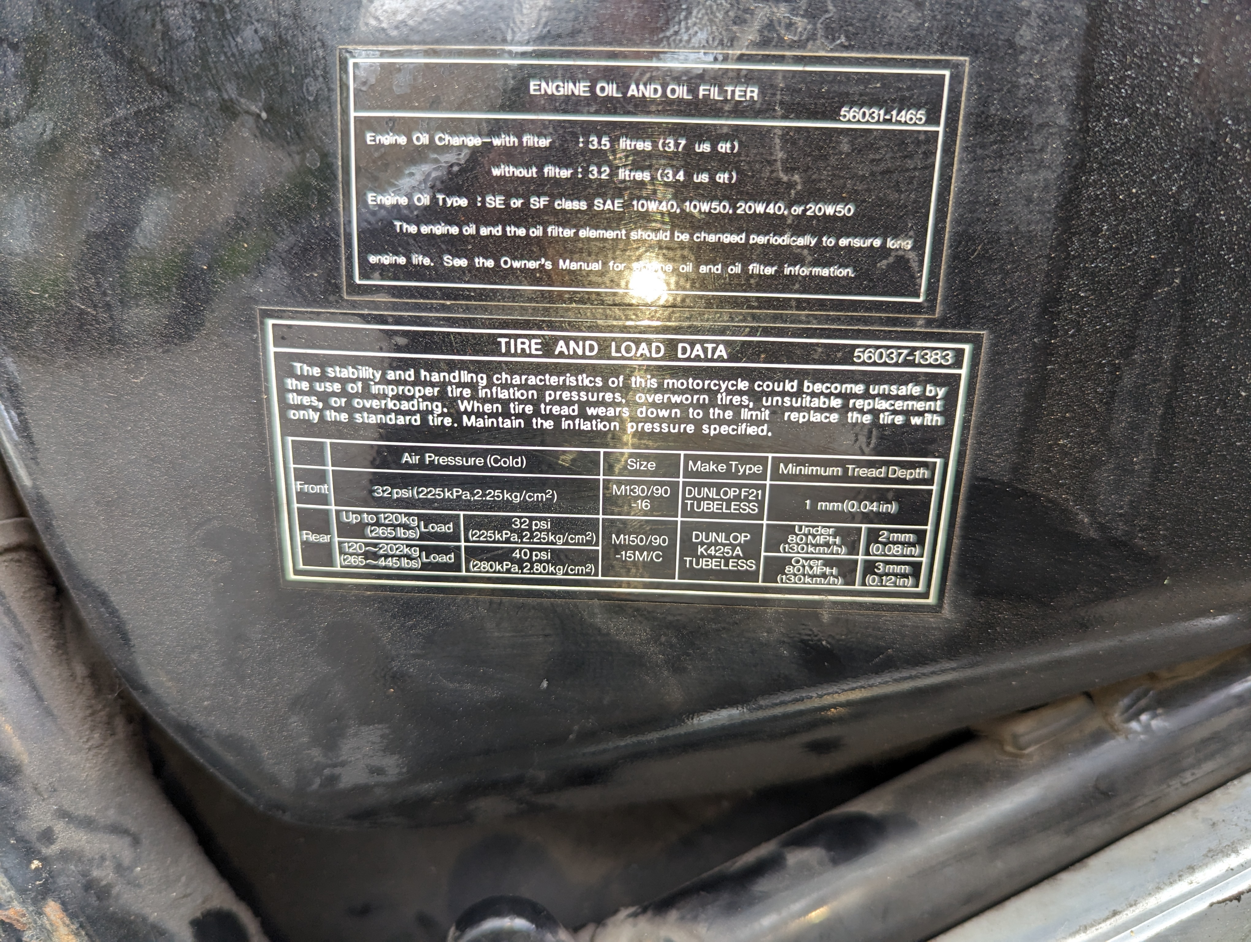

Which reminds me... we've had a few discussion about tire pressures on here, and I discovered the factory tire pressure sticker inside the left side cover day before yesterday. Never really noticed it (as in bothered to read it).
Front tire under all load conditions: 32psi
Rear tire under 265lbs load: 32psi
Rear tire over 265lbs load: 40psi
Total load capacity of the VXII is, IIRC, 465lbs. So with two 215lb passengers (don't forget the weight of gear and anything you've got in the saddlebags or added to the bike) you're fine, but you will want to bring everything up to max (fork air pressure, rear shock air pressure, damping setting, rear tire air pressure) as in max recommended, not what it says on the tires.
