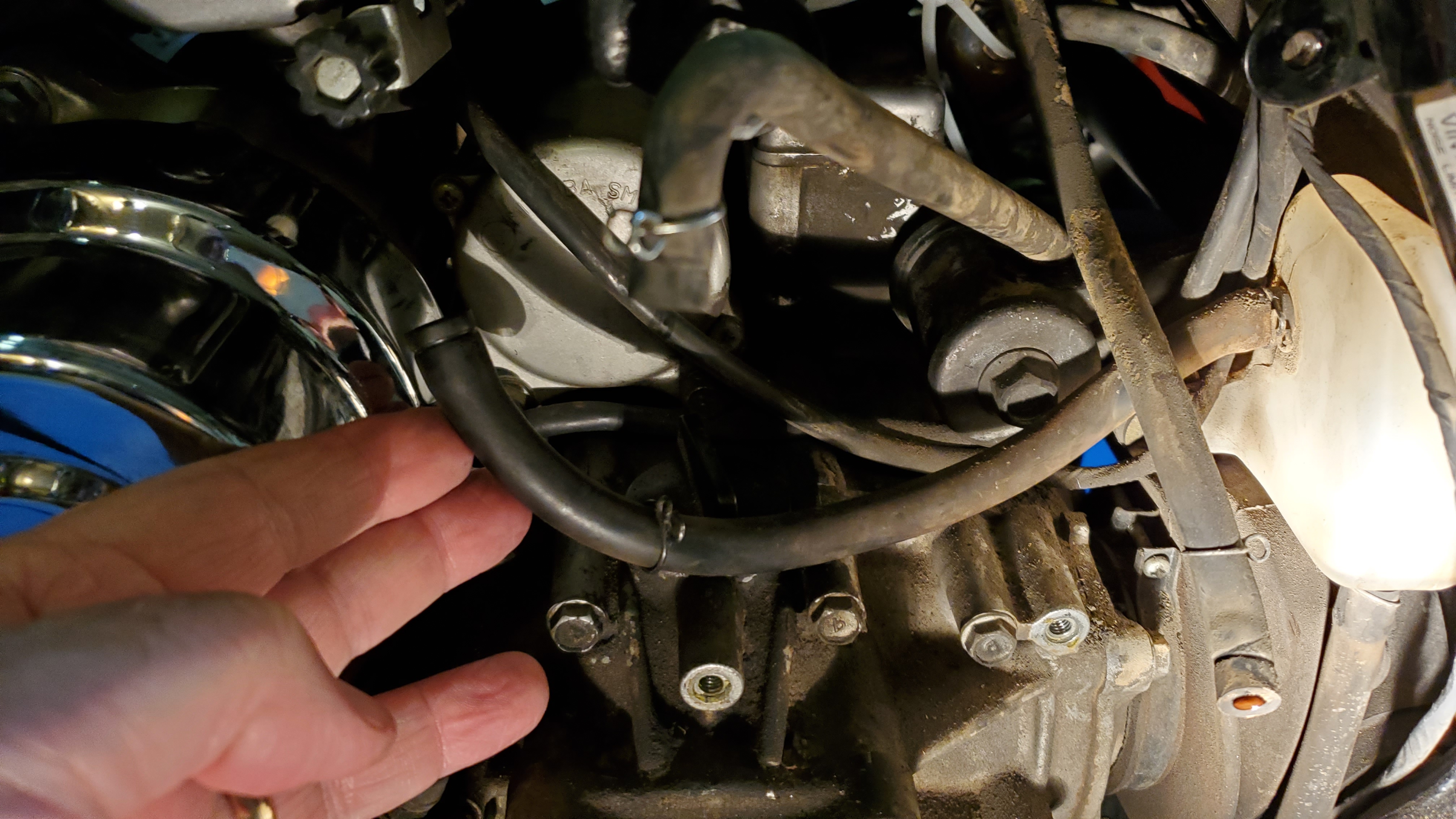

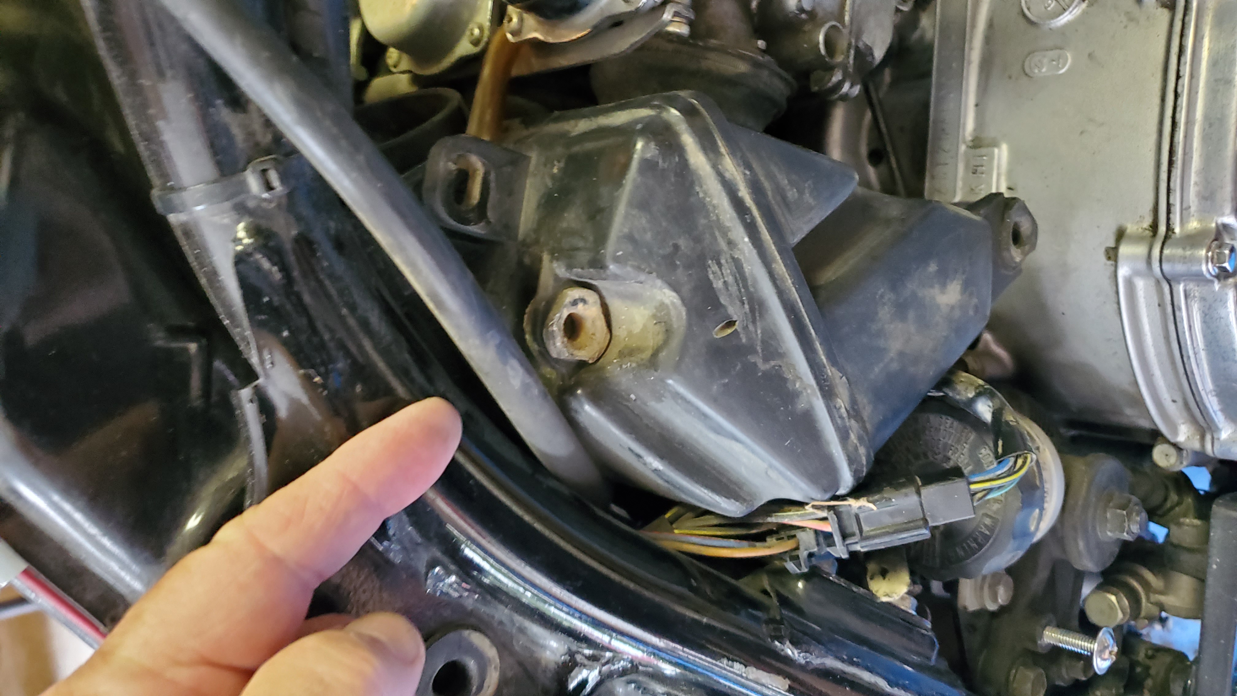

Here you go: Image
So, from the radiator cap area it goes off to the right and then runs along the top frame.
Sorry, you have to tilt your head to get proper orientation.

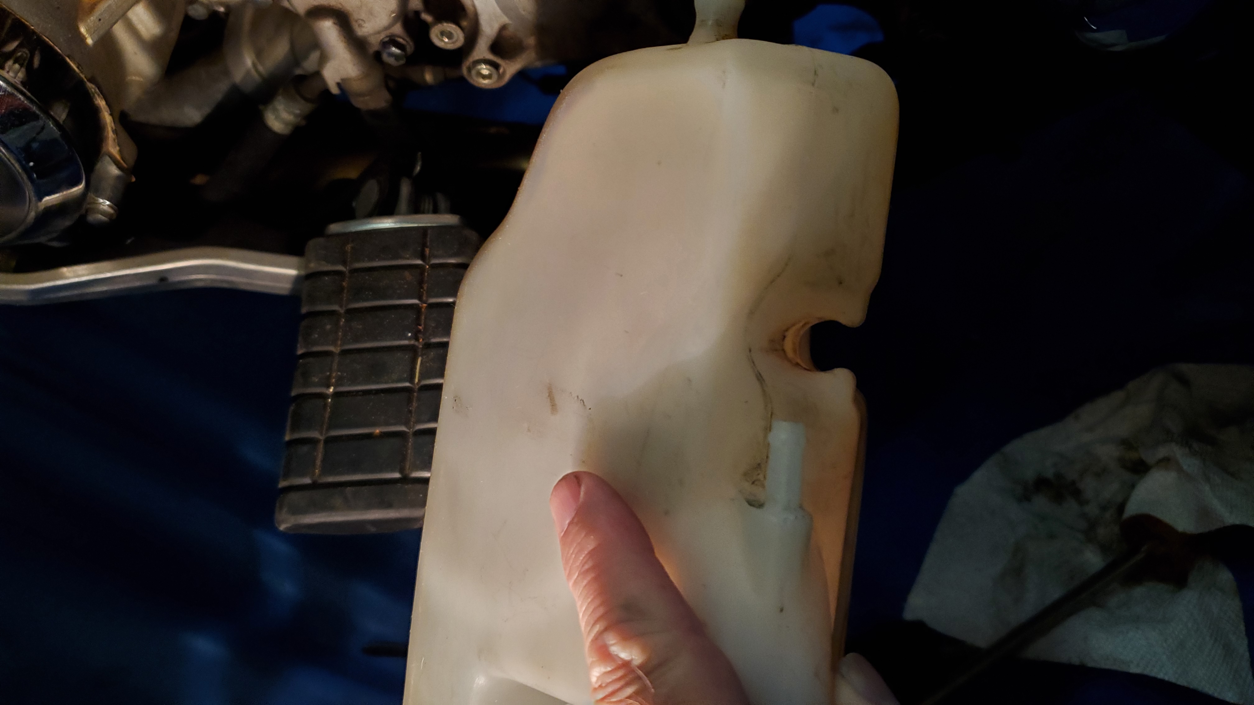

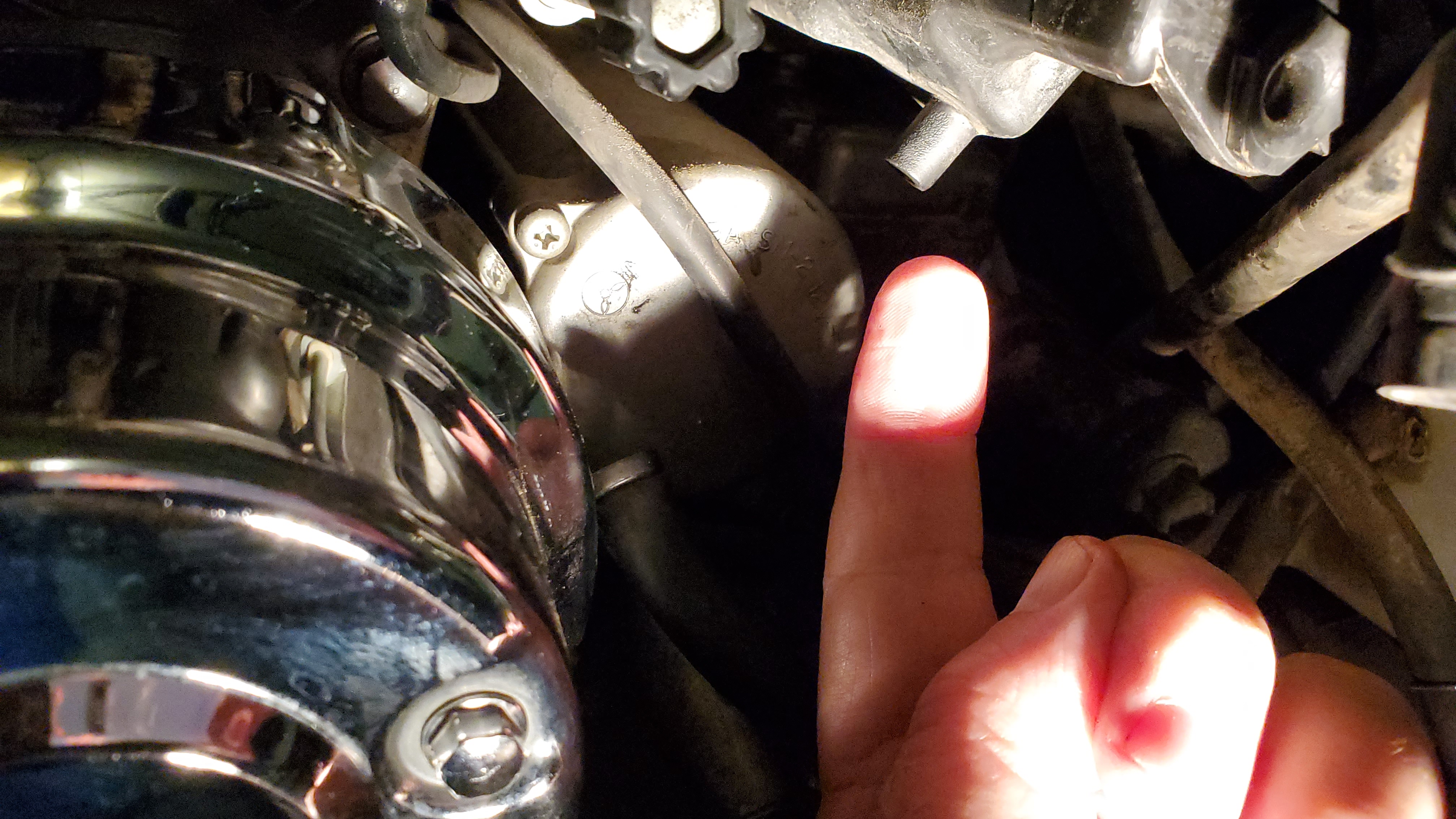

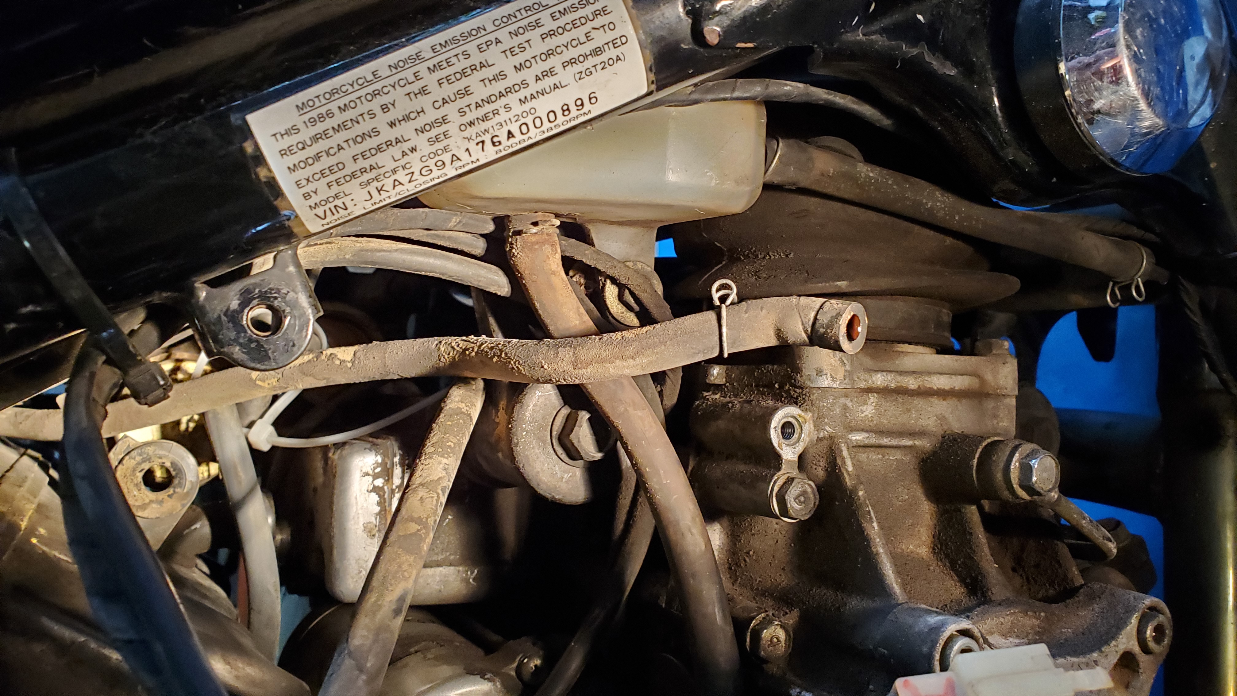

Then it will tuck in behind the air box here.
Now you see where it comes out. This hose attaches to the bottom of the overflow tank. Finally, this shorter hose attaches to the top of the overflow tank and dumps overboard.
And once again, please tilt your head...... irritating.

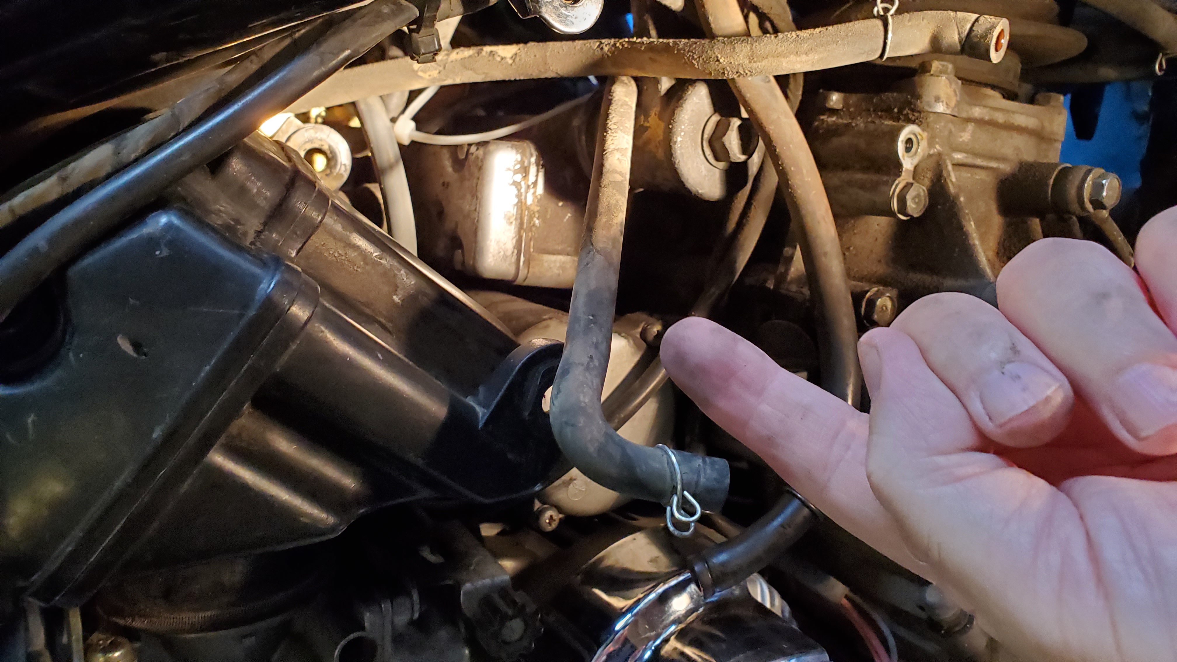

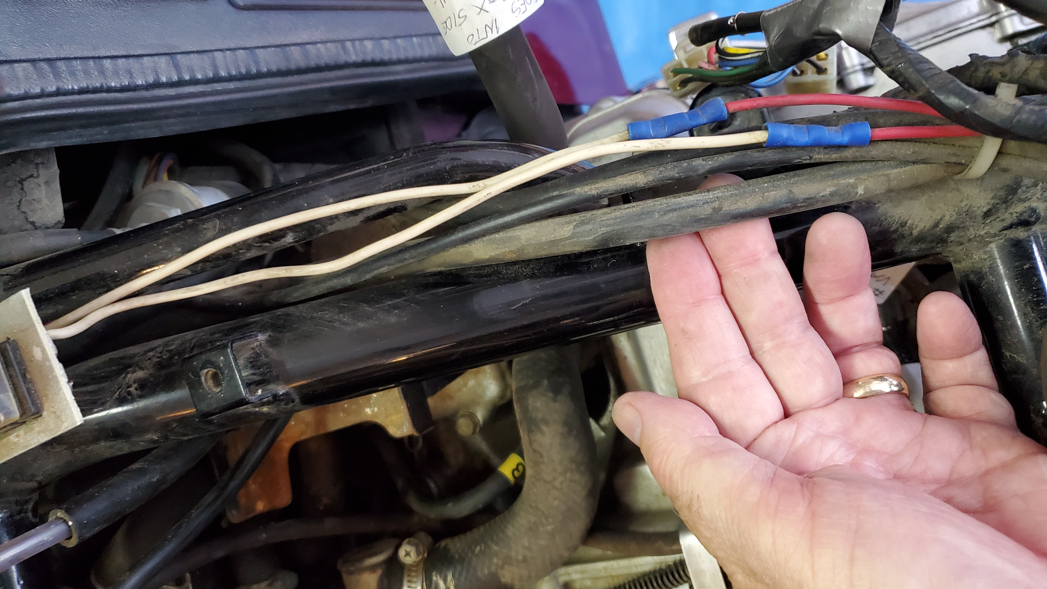

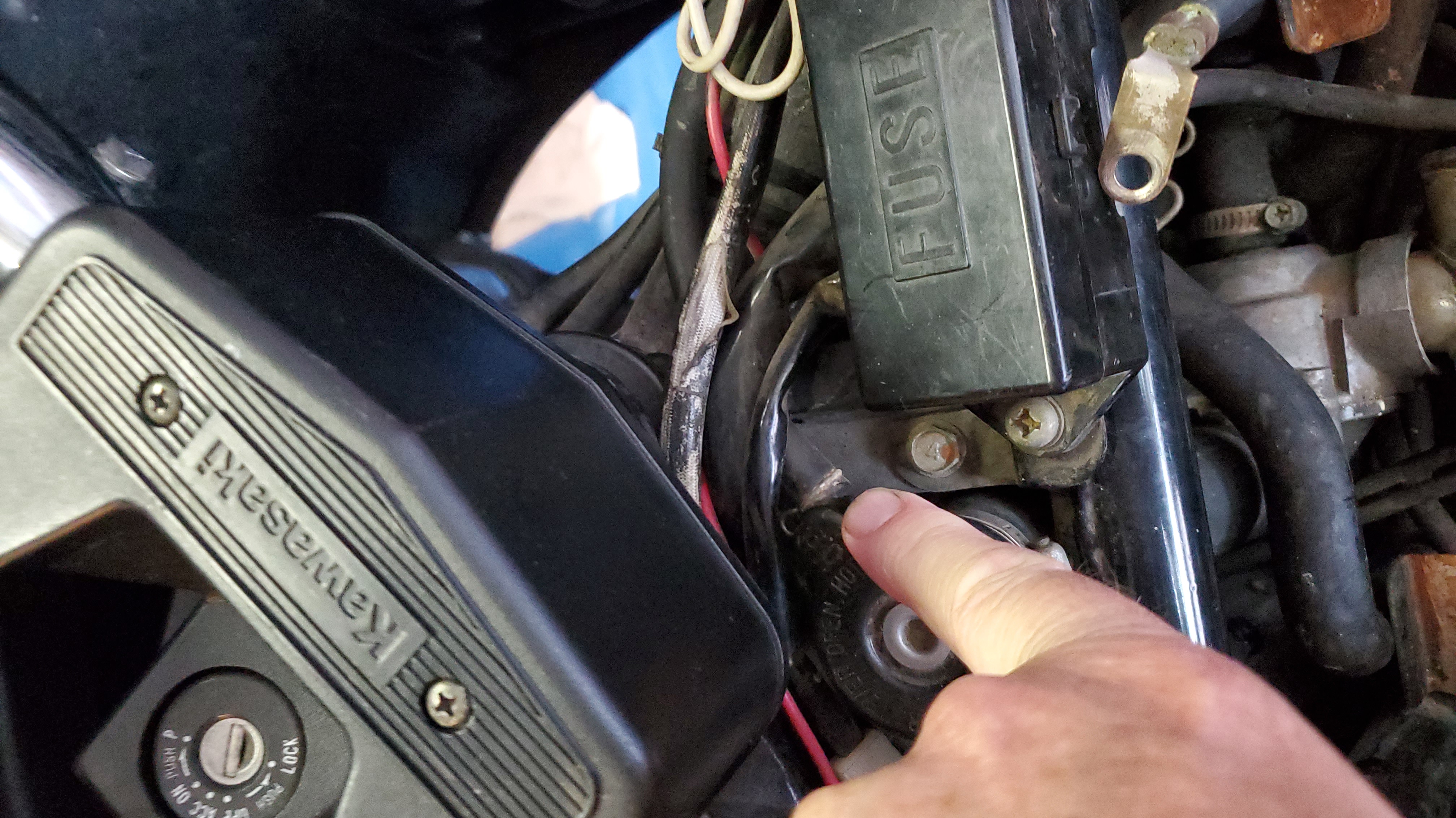

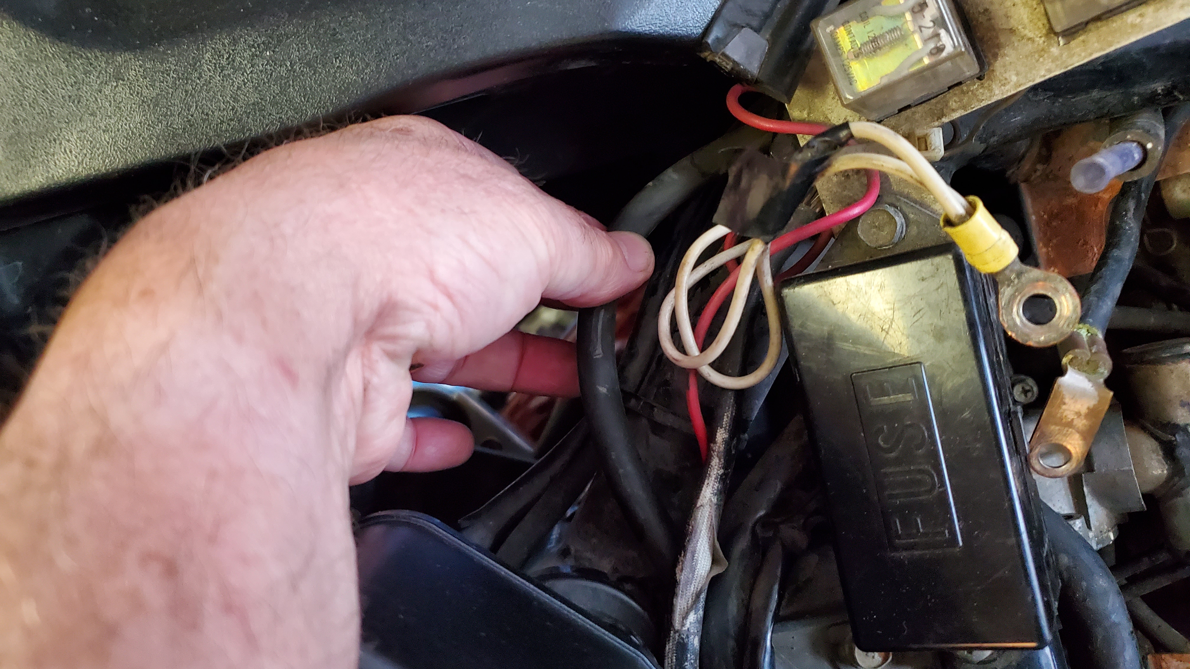

Lastly, the "small" overflow tank routing:
This hose routes over the top of the bigger tank, through the notch seen in the pic, and then attaches to the air box.

I just discovered that I lied to you a bit. The notch in the radiator overflow tank has that notch in it BUT it's for the top hose coming out of the overflow tank that drains out on the ground and NOT for the hose coming from the surge tank to go through.
That hose actually goes underneath the larger, overflow tank.
