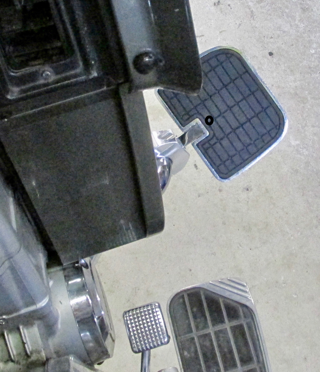

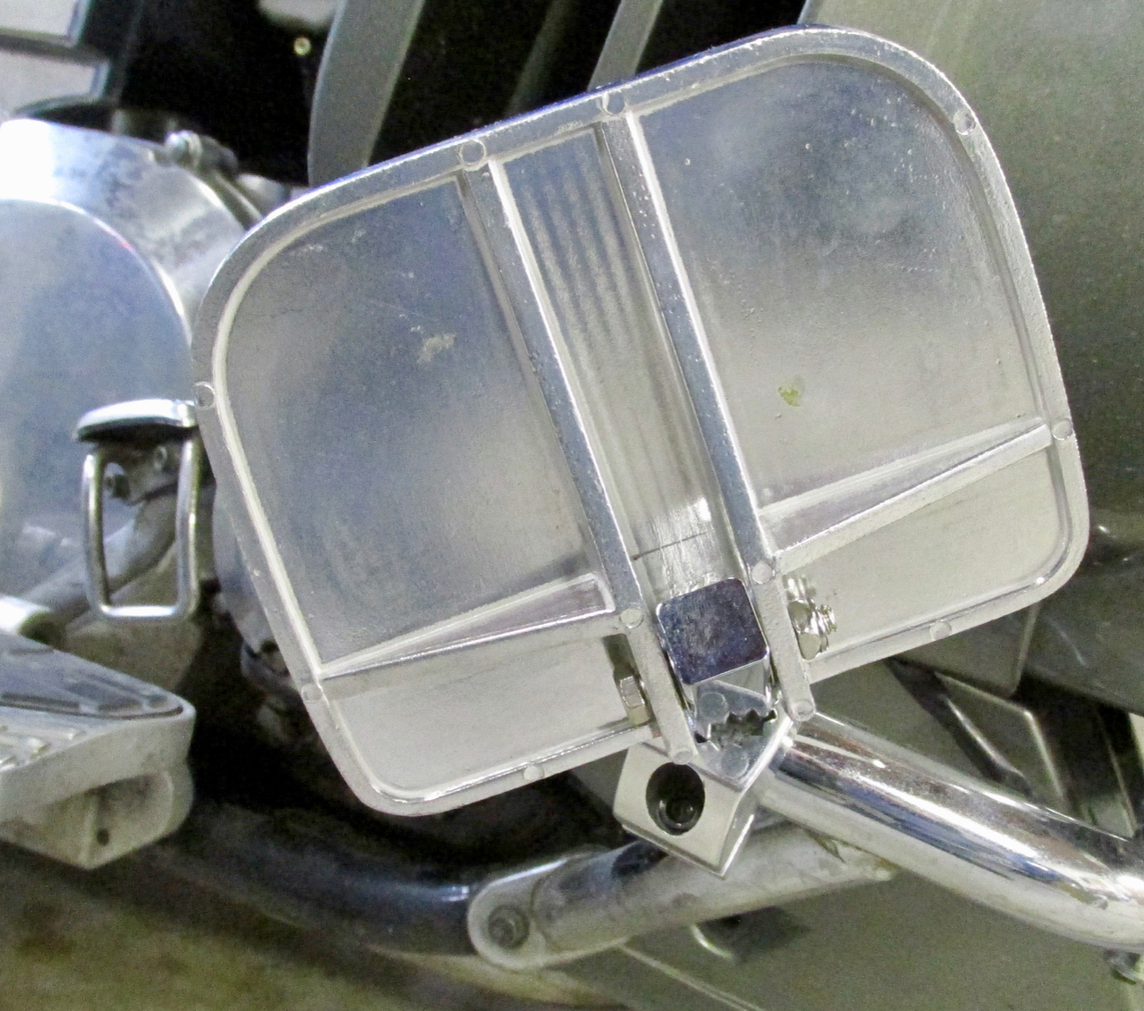

... OK, mounted the floor boards..... couple of observations...
they didn't have the angle-ability I had hoped for, but lookin' at 'um, I'll
guess many ways to add it... the one I chose, yet to do... is drill and tap
a hole in the board within 1/4" of the end of the support peg the board
rests on... thread a bolt into the board and create a peg/stop to hold the
boards at any angle I want.... within reason....
My big hangup is the damn crash bars forward support where it comes up
to the bars!!! It's right where I'd like to put 'um!!!! So I'll leave 'um
right next the the support arm and try 'um for a while.....

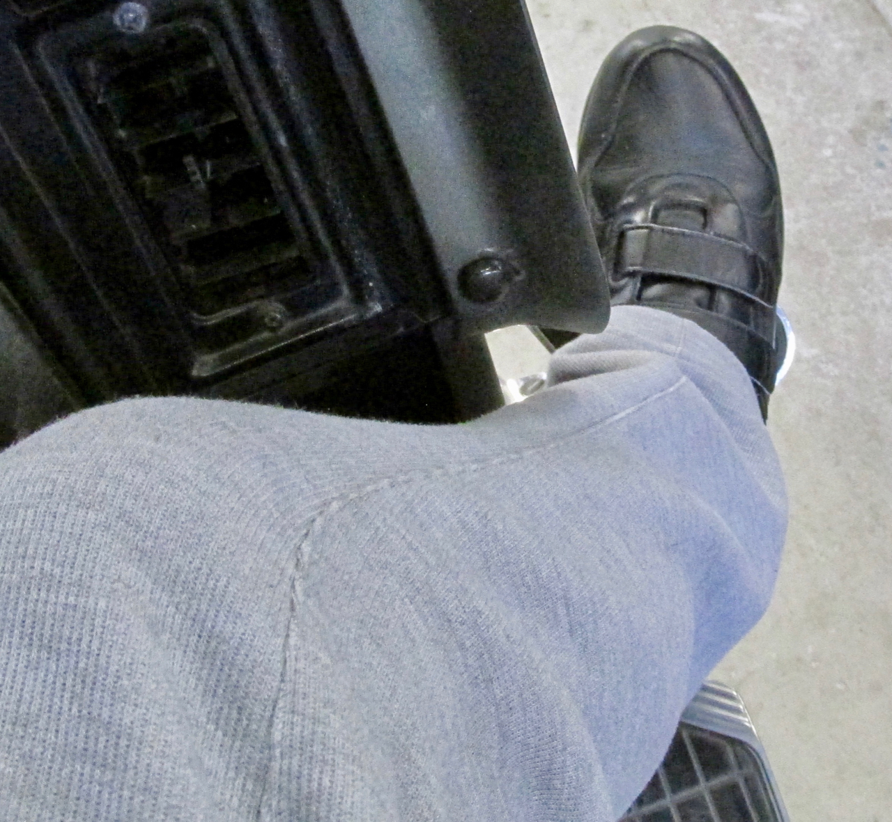

.... and yes... I can put my heels on the floor boards, I do have them...
and my toes on the Emgo boards... I'd like just a tad more reach....
but I'll try 'um for a while.... Thanks to all!!!!

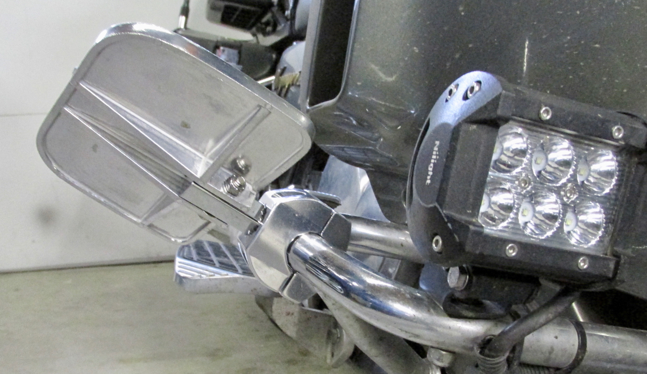

The first pic has a pencil line on the floorboard where the support square
piece hits the board.. The last pic was where I can drill and tap the floor
board and sink a screw and leverage against that bar and introduce an
angle adjustment, if needed....
