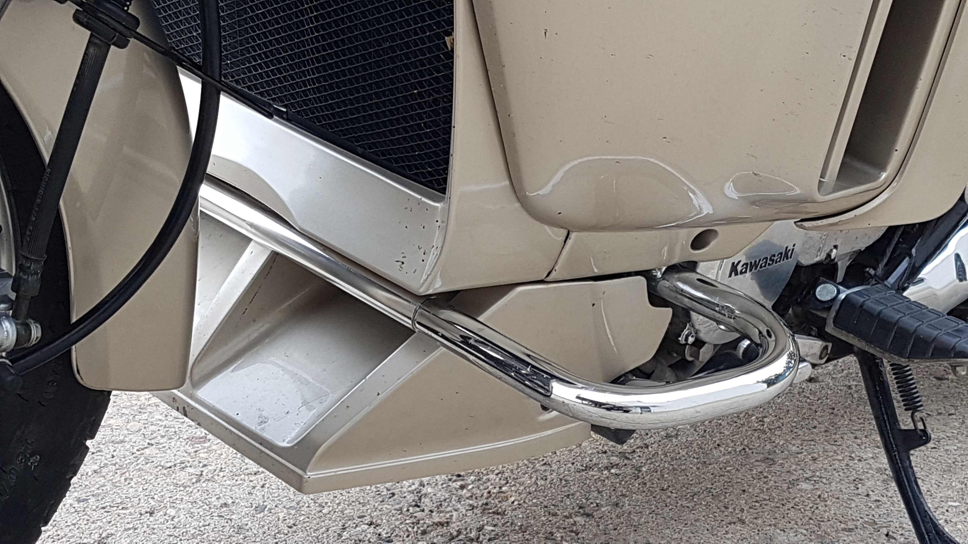

I found a post a while back about tying or joining the gap between the engine crash guards to make it more solid.
Someone mentioned chrome bar etc.
I took a piece of solid Aluminum bar stock and machined it down to fit into the tubes. I f'd up on my length a bit but that's alright the gap is even.
Had I spent more time on the buffing wheel this would have looked just like chrome.
It really made the crash guards more rigid.
Now to find some nice highway pegs!

Pretty fancy.
Posts: 1072
Been liked: 249 times
Re: Engine Guard cross bar / tie bar / Highway pegs
LOL! I just used galvanized steel pipe. Drilled holes, secured with screws. Been in place for 7+ years. Not pretty, but very functional. Cheers!
