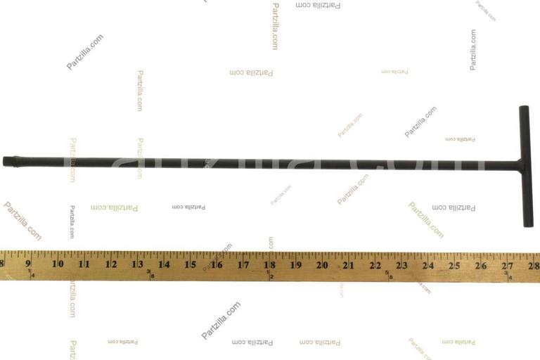

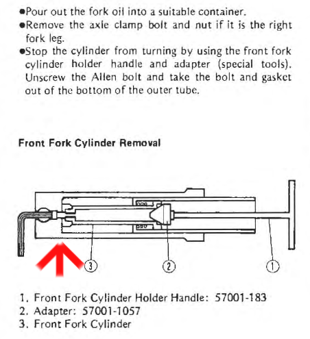

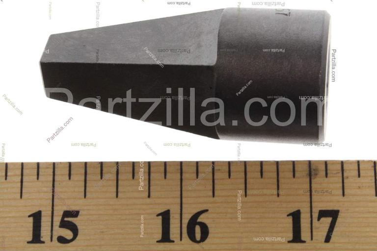

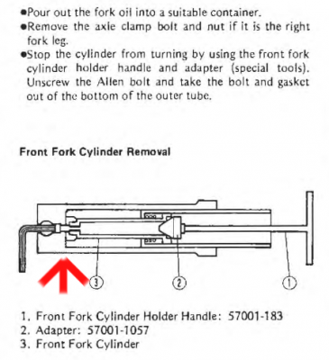

Was this the bolt you removed? If so, it goes into the Fork Cylinder and probably isn't screwing in properly because the cylinder is rotating freely as you tighten. You need the special tool pictured in the diagram - a combination of the Front Fork Cylinder Holder handle and the triangular adapter, which holds the cylinder down and prevents it from spinning as you tighten. Please note the fork cylinder bolt is supposed to have threadlocker on it (and so is the fork oil drain plug, which could be why yours stripped).

These should help give you a general idea of what you'll need :thmup:
